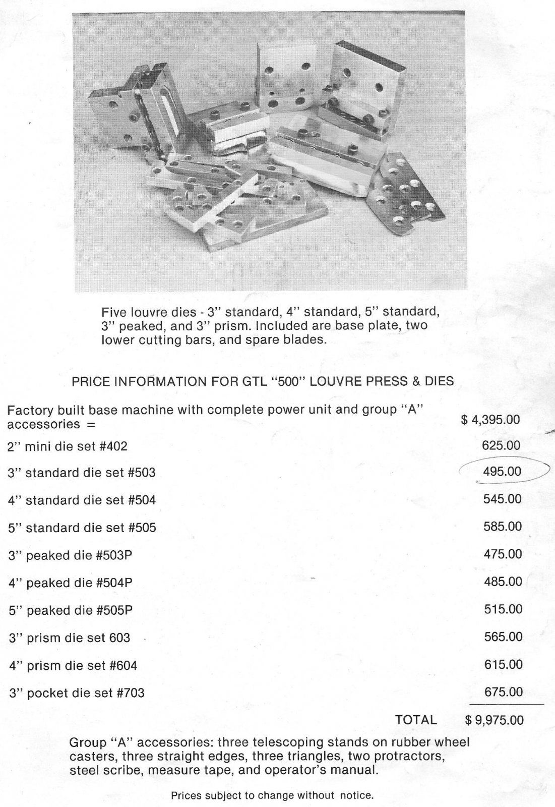

    These were from GT louver company from the 80's(no longer around) they used replacable cutter edges on both the die and punch to keep cost down and make them servicable lp.jpg

    GTL good time louvers they were from Sacramento. I bought their plans for the press and the standard 3 inch die in 1984. Bought 4 inch and the mini die a year later, over the years had more dies mashined over here. I use my press at least once a week for more than 30 years now and there are not many tools that are that reliable and pleasing to use.
    I've been to Sacramento once to visit GTL if i remember right the name of the guy was Marc Sherman.

    those dies look like the dies in my press, mine is a GM press made in the 50's, the good times press is a copy of my press but uses square pipe in stead of round. i sent the goodtime guy a copy of the instructions that came w/my press, he said he was going to use it w/his press??? i only have the 3'' flat top die that came with it, [3'' louver, take it or leave it] to much trouble to give tomanny choices. trying to get a die for my pulmax, WHY?? dunno, don't do many now. best way to ruin a hoby is to make a business out of it, been there done that.
