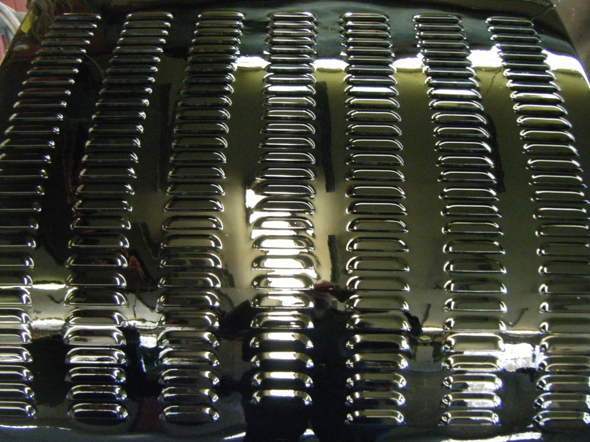

  10. I remember sanding the original 25 louver hood on my deuce sedan,my fingers were raw after sanding the inner & outer louvers,that's 100 in all.
    I love louvers but despise sanding them. HRP

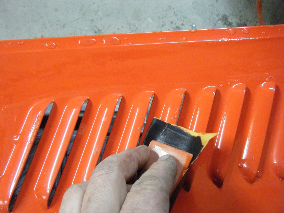

  14. here is how i do it maybe not the best way. i first block sand all the area around the louvers making sure i do not repeatedly sand against the edge of any louver. then i sand the "face" of the louver with the sand paper wrapped around a rubber squeegy . avoiding the rounded corners. when that is done i use one finger, in the CENTER of the piece of paper, to sand the rounded corners. doing this creates no sanding "edges" because the pressure applied by your finger tapers off to the outer parts of the sand paper. DSCF4966.JPG

    Thanks for taking the time to explain and post the pictures of your technique. Very helpful and one I'll follow. I'll also give the sanding sponges a shot. Kevlar gloves look like a good idea, but I wonder if they'd be too bulky to get in between the louvers? Thanks for all the tips.

  19. your welcome. one thing to also remember is, the edges of what ever block/squeegy you use is the enemy. repeated strokes in the exact same spot will leave a ridge that will show in the final paint. the blocks i am using in the photo have very worn edges and the paper hangs over the edges.:cool:
