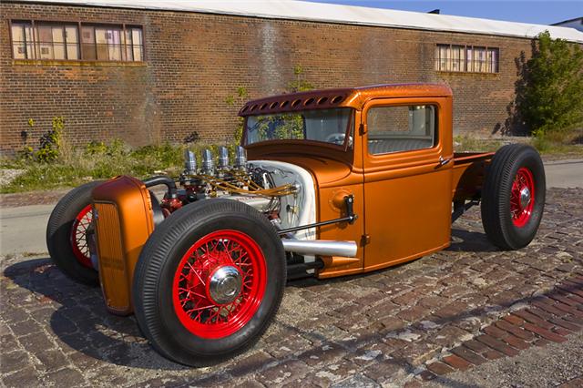

  16. ROADSTER1927
    Joined: Feb 14, 2009
    Posts: 3,257
    ROADSTER1927
    No problem with either of these in heavy rain, (except for ocupant issues if I dont have the top on the roadster). Gary:D:D
