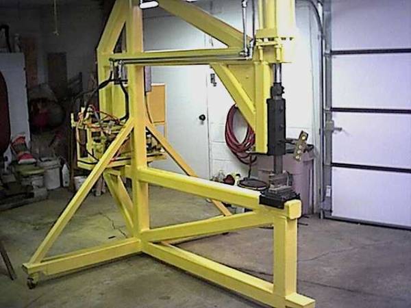

    I built mine some 15 or so years ago. I have less than $200 in it . It paid for itself on the first paying job. 90% of it used to be something else. I have one set of dies that some machinist friends of mine made ( with some trial and error). I realize that most people wouldn't be able to gather the parts as cheap as I did. But an enterprising person with some imagination should be able to build something on the cheap. Bill 31louverpress1.jpeg

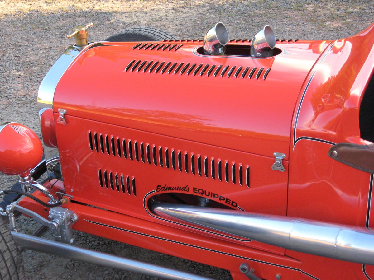

    I have a press and mostly use it on my shop projects, as most of them are race inspired. I have done some big hoods, but it's painstaking ! IMG_0744.JPG

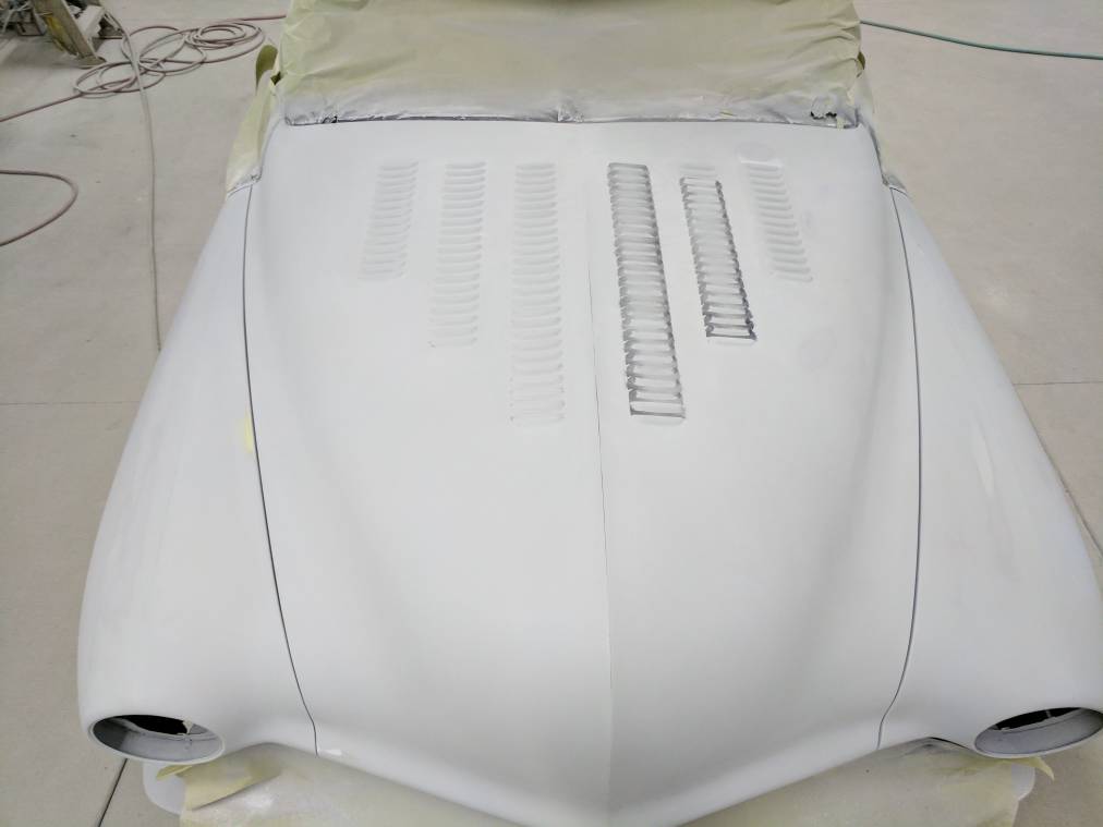

    A few on the 51 Merc, block sanding around them is a pain but they look bad*** [​IMG]

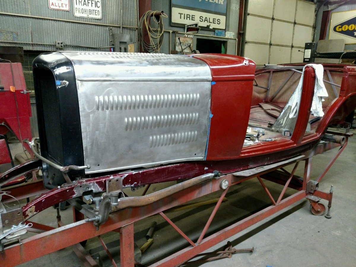

    These are "Hot Off The Press", punched 126 yesterday, and taught an apprentice along the way. I keep a long sample "layout strip" handy, and since the rows were parallel, I sheared strips of sheet metal to simplify the layout process, allowing for the spacing between the rows. You can tell by the grimace on my face, I don't enjoy it, but the end result is rewarding. We punched 90 in a Model A hood, and 36 in the cab guard panel for my '40 shop truck. IMG_7573.JPG IMG_7575.JPG IMG_7580.JPG IMG_7585.JPG IMG_7594.JPG IMG_7596.JPG IMG_7601.JPG

    Boy that looks good Marty!
    Do you turn off the phone and put the "gone fish'n" sign on the door when you punch louvers?

    Love the striping on this!

    Mitch Kim, clearly one of the best !

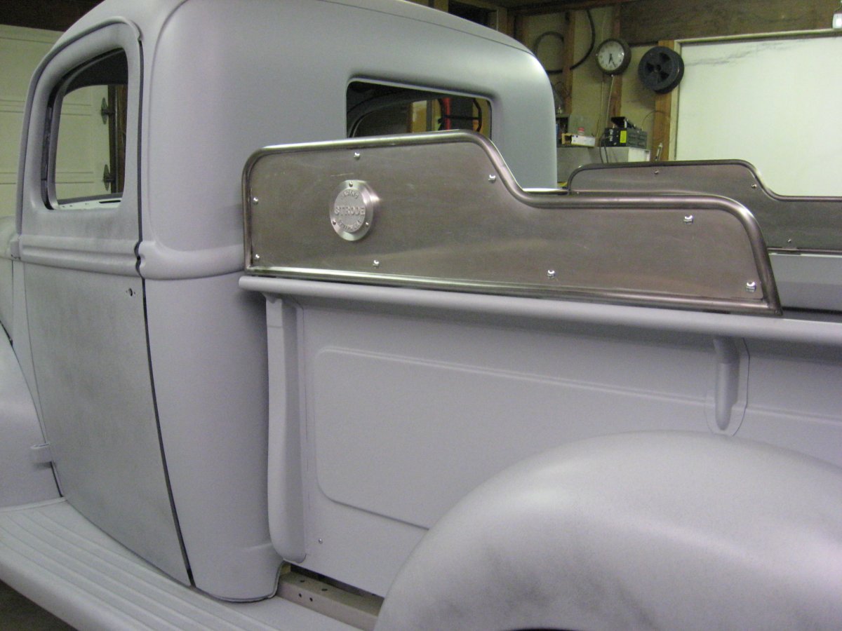

    Wow! That sure has the wood sideboards beat. May steal the idea for my 39. Bob upload_2017-2-26_10-48-11.png

    Growing up in the 50's in my small town, most every gas station or repair garage had a shop truck with side-board advertising, some of them would show up as push trucks at the track on Sunday. My plan is to chrome the tube frames, clear anodize the aluminum panels, and let my sign painter go to work. The truck will be Washington Blue. Good luck on yours ! IMG_5234.JPG

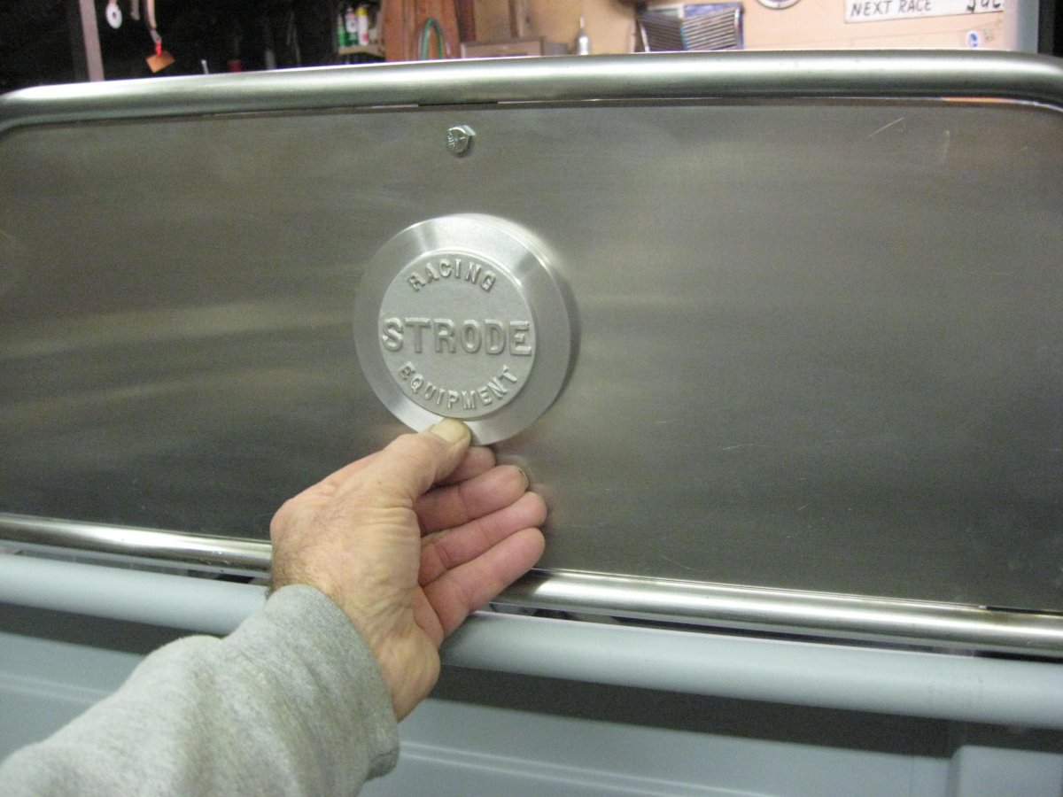

    How about a close-up shot of the round logo on the signboard Marty.

    Here you go, it's one of the front hub covers I had cast to fit wide 5 race hubs. We machined it smaller on the OD, and thinned it up a bit. IMG_5202.JPG
