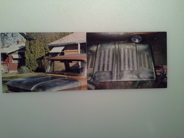

    One example was the hood for my 66 Suburban, I wanted both "innie" and "outie" louvers.
    The guy that punched mine said this was the largest hood he had ever done and consequently he need to build a support cradle, I ***ume because he was a one man operation.
    He also installed a lazer on his louver press and they are straight as an arrow, and just the layout I requested.
