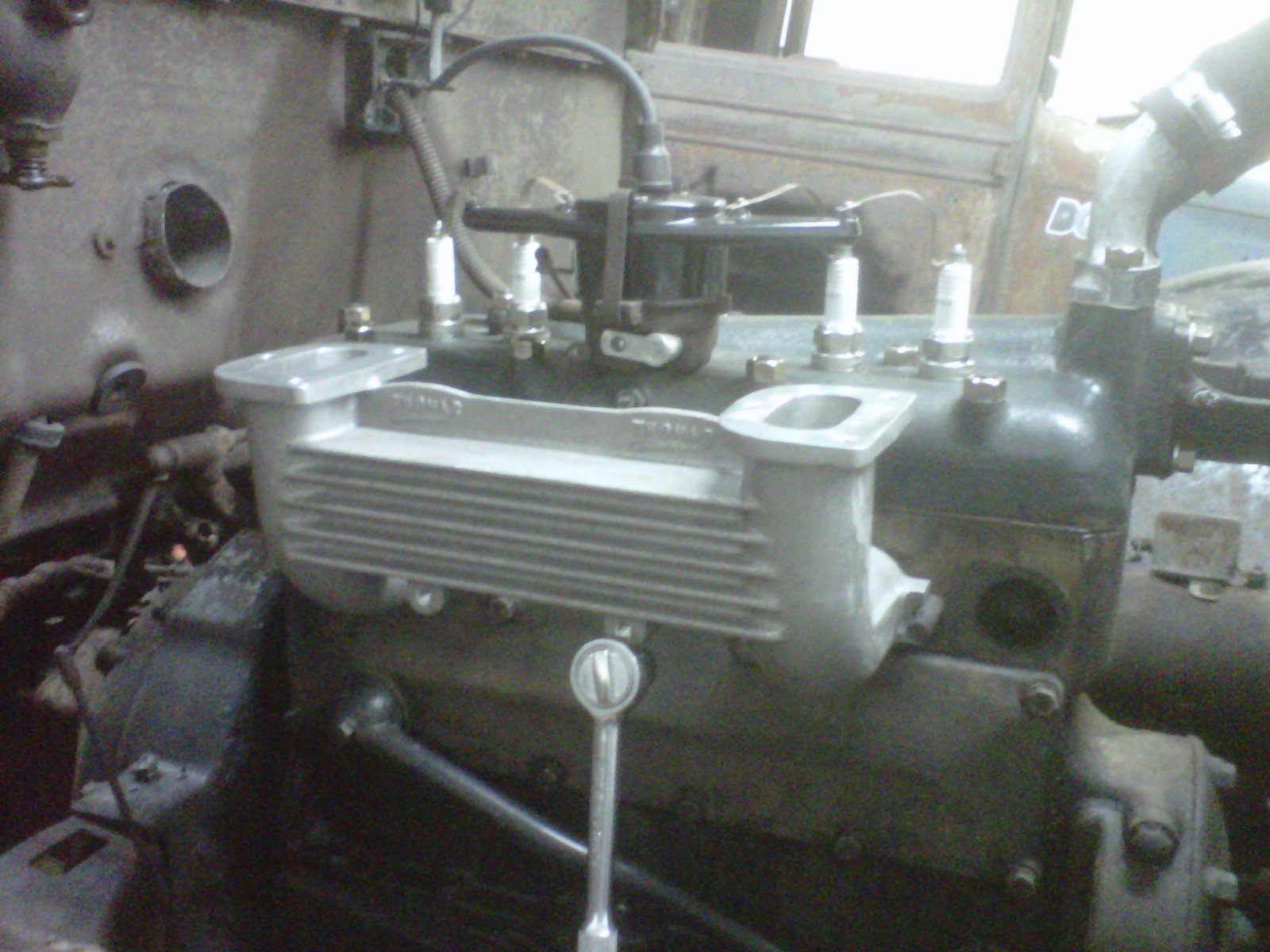

    18 and counting :D picked up this intake today i need to find a second 8ba 94 linkage and header

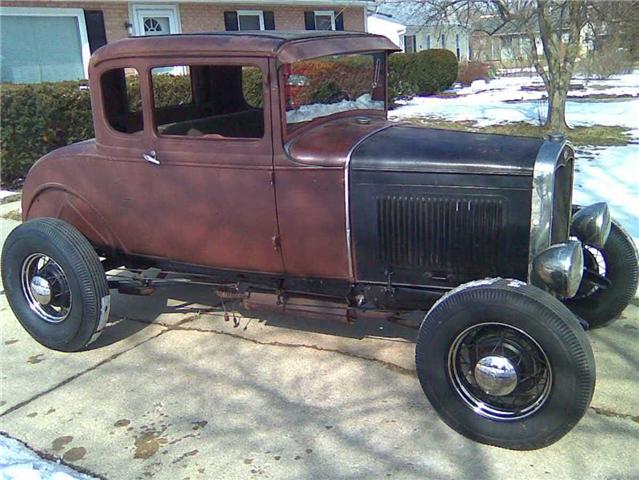

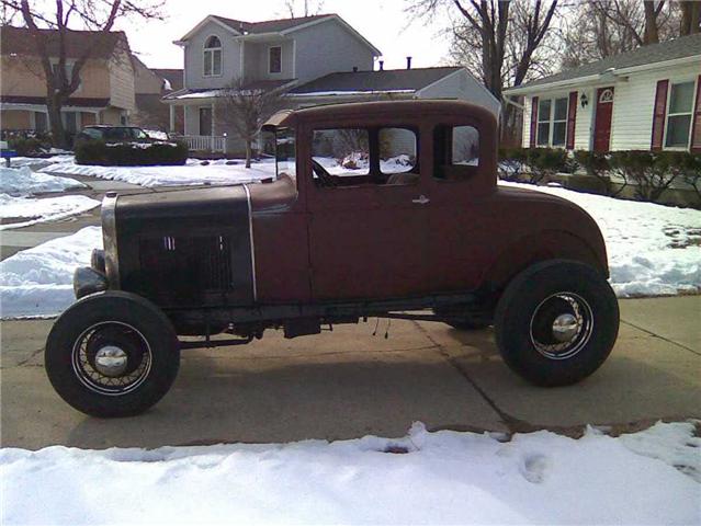

    This big news in my Banger World is that the 1931 Banger Coupe made it's maiden voyage this Saturday. Basically assembled the car in seven days. The starter spun the engine about two revs before it started and then proceeded to drive it about 20 miles and had a good but cold (no side glass yet) shake down run. I was going to debut it at Autorama next week but didn't get my application in on time, so I'll bring it to Billet Proof Detroit in May together with its older sister-the 1928 Banger Roadster.

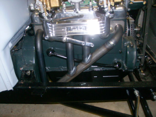

    Get a hold of SaltFlatMatt - he made great header for my banger last spring. You won't find a pic on his website, but it is the 4 down, into 1 on an angle style.

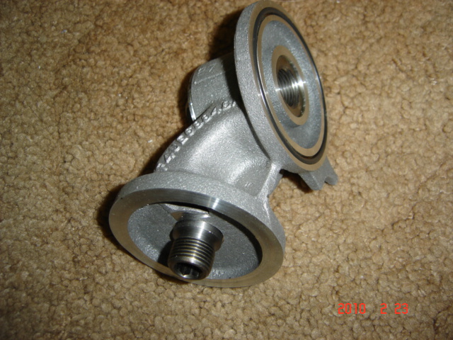

    I wanted a vertical mounted oil filter, on my A-FORD-ABLE full flow oil filter adapter kit.
    Found an adapter from Ford Racing (P/N M-6880-A50) it mounts to the the A-FORD-ABLE kit and a FL-1A oil filter is screwed on the M-6880-A50 adapter.
