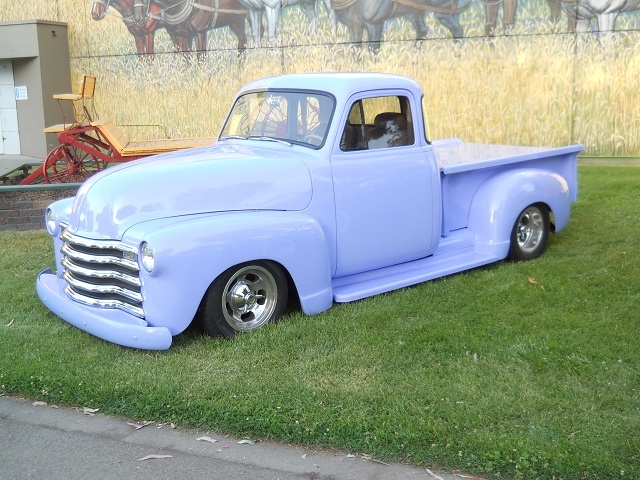

    So I’m starting a build and was curious of input from the guys here. It’s going to be a custom late 50s early 60s style. I want it low as possible but still be able to drive it and as stated I want it to be as traditional as possible, so I really don’t want to bag it. Most everything I’ve built before has been 4x4 and most have been lifted so the low world is somewhat new to me. So tell me guys how low is too low and what’s that sweet spot where you still have the majority of functionality but still has that low look. More of a tail dragger look but again I’m going to try to stay away from the easy non traditional route of bags. It’s going to be a fat fender f1 on 41 car ch***is, car front clip, custom bed. Below are some images to kinda get the height I like but let me know your opinions. Thanks in advance guys.
    [​IMG][​IMG]

    Too low is a subjective term. I used to drive a car that I could roll a pop can down the street with the front crossmember. But I wouldn’t do that nowadays.

    The blue one must have bags because that is too low to be driveable, especially with more than the driver in the car. My Mercury is not super low (3 inches lowered), but when I drive with my wife and kids it sometimes scratches the ground (and we are a slim people).
    The second example (if it is a static drop) looks good and can be driven without too much h***le IMHO.
