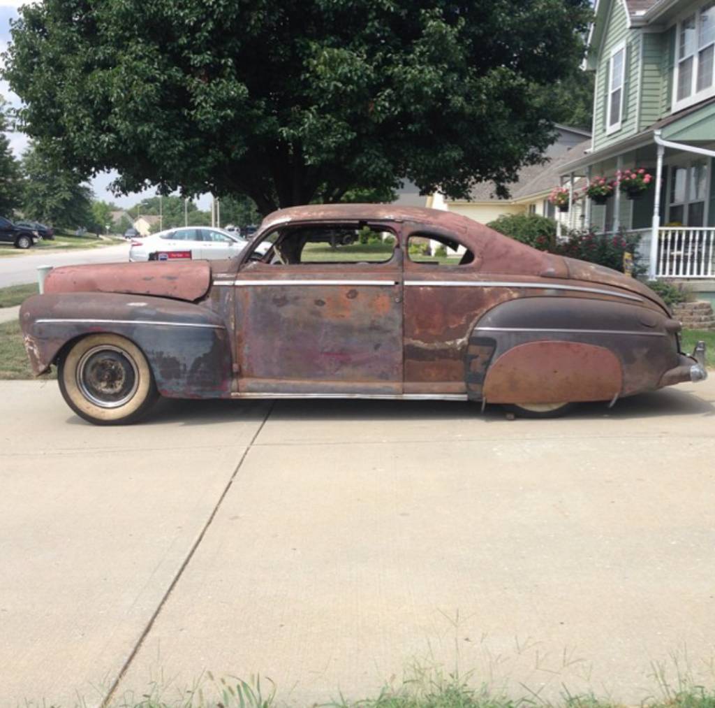

    the coupe in progress you posted in the first post is @flatout51 he could tell you how he got it that low. He also has a sedan that’s fairly low in the nose. I run a 27 ish inch tall tire in front and had my axle narrowed when dropped and it only rubs the inner fenders at full lock on a side hill

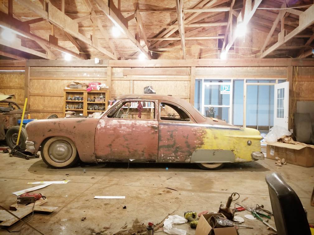

  11. flatout51
    Joined: Jul 26, 2006
    Posts: 1,326
    flatout51
    The bottom car is mine. It has a 5 inch drop axle from sid and a reverse eye spring with leaves removed up front. Rear is a homemade flat crossmember and modified spring. I'm currently going through the same predicament with my shoebox coupe. I like it low but cant fit a floor jack under the front crossmember and will need a large c notch in the rear. I'll probably raise the front an inch or so and leave the rear. 2014-11-26%2013.22.17.jpeg IMG_20181102_114836_791.jpeg

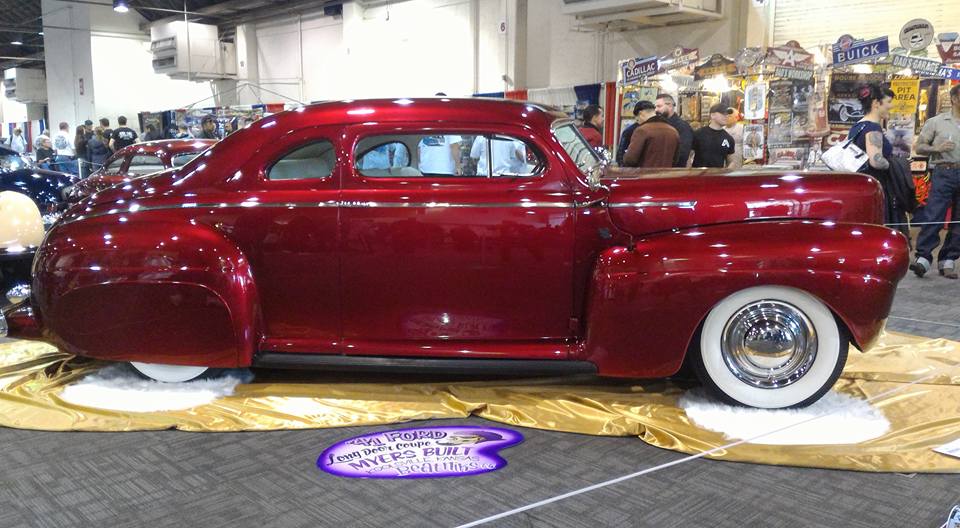

    downlojoe33
    You migh have to live with a little in convience to get the look you want.
    See below.
    Special Ed and p1yotaboy like this.

    You are 100% correct unless you bag it and have adjustable ride height .. static drop has its tradition which I have on my 41 but s****ping etc is the price one pays driving a lowered ride.
