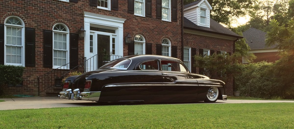

    I drove my old Merc everywhere.

    Couldn't have said it any better myself. The stance on that Merc is PERFECT!

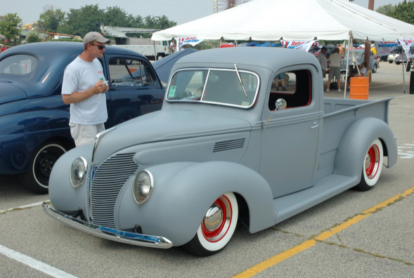

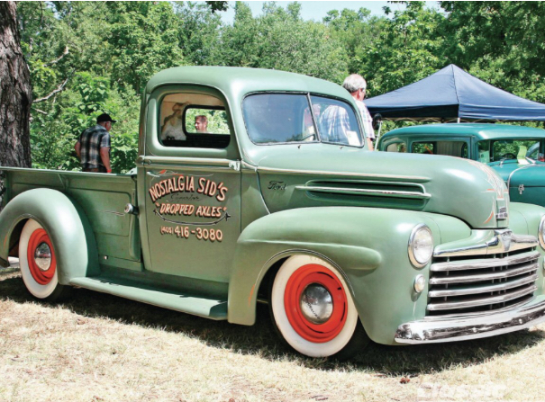

    Here is a picture of THAT truck before I sold it and people started to strip parts off of it every time they flipped it. I used 3 inch shackles in the front (SoCal Speed shop as I recall) and home made longer ones in the rear. Talk about traditional.LOL I also added tube shocks front and rear along with a rear panhard bar to keep things legit as it was a 47-48 Ford rear end which is a bit wider then the stock 41 was. The truck was also channeled 6 inches.My avitar give a good profile of how it sat. I've got a pic somewhere that show the height from the ground to the bottom of the rocker to about the height of a pop can.
    Dropping and axle should not affect track width. Many of the customs back in the day had some sort of rubbing issue with the front tires. You just never went lock to lock. And as has been stated, castor are noting new. The Hirohata Merc had casters on the bottom of the rear bumper as I recall.
    Junior Conways shoe box was low as was Larry Watsons G****vine and both static drops.
    Customs were all about the look. Not always about how practical they were.LOL

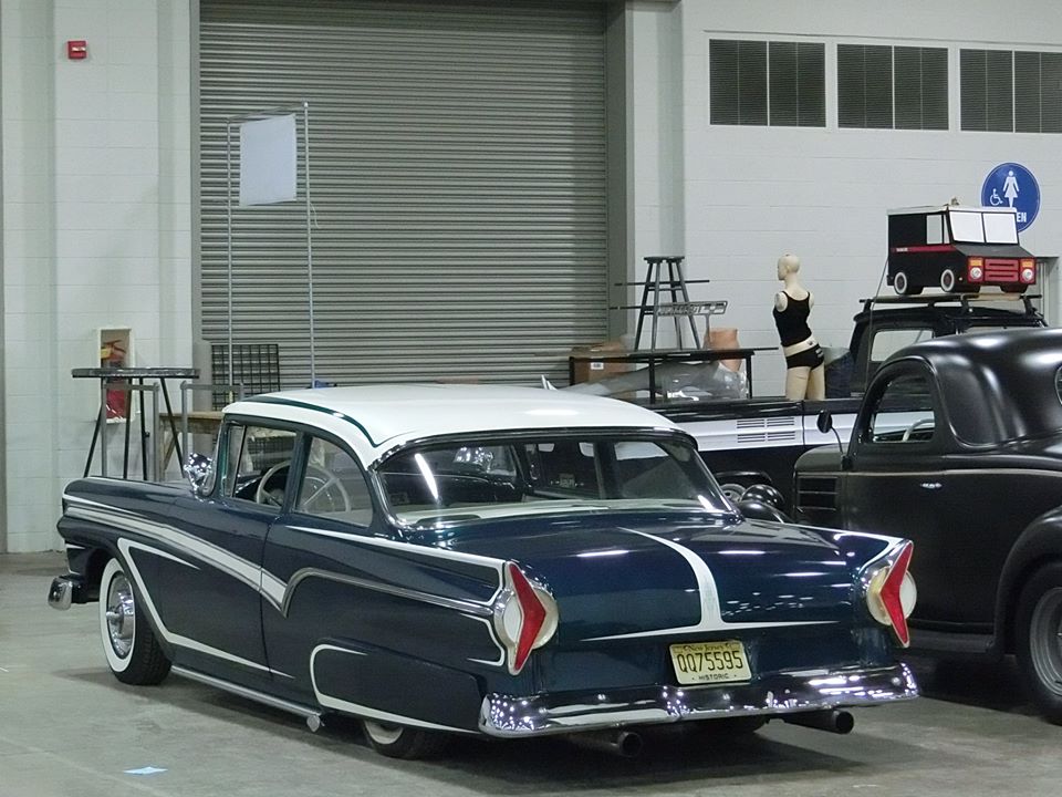

    It's funny that this thread should come up today.

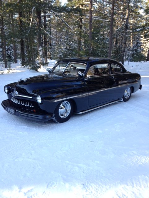

    My 57 Ford is damn low, with a static drop. Chopped coils in the front, 3" blocks in the rear with a reversed shackle. The lake pipes are the lowest point, and they've been torn off the car more times that I can count. I too have driven the hell out of this car, easily over 100K miles in the 18+ years I've owned it, so it's not as if how low the car sits has stopped me from getting it out and enjoying it. That being said, as I've gotten older, my tolerance for the ******** ***ociated with driving a car this low has lessened. As mentioned, the lake pipes have been ripped off the car more times that I can count. Despite comfortably seating 5, this car is absolutely a 2-seater since the weight of an adult in the backseat makes turning without s****ing an impossibility. The skirts have been dragged for miles. The driveshaft chewed a hole through the floor under the back seat. While people will alway complain about speed bumps with lowered cars, I can tell you that by far the most problematic issue I've run into are just dips in the road, such as a drainage grade in the left or right lane, which you basically never see until it's way too late and you hit it at full speed. Even a cooler with ice and beer will drastically affect ground clearance. Now that I have a 16-month old, I just won't drive her around in this disaster. So I literally haven't driven this car in about a year. But I have to say, the car looks great with that stance, and raising it to improve ride quality and driving enjoyment would come at the expense of show aesthetics. Not a good trade off.

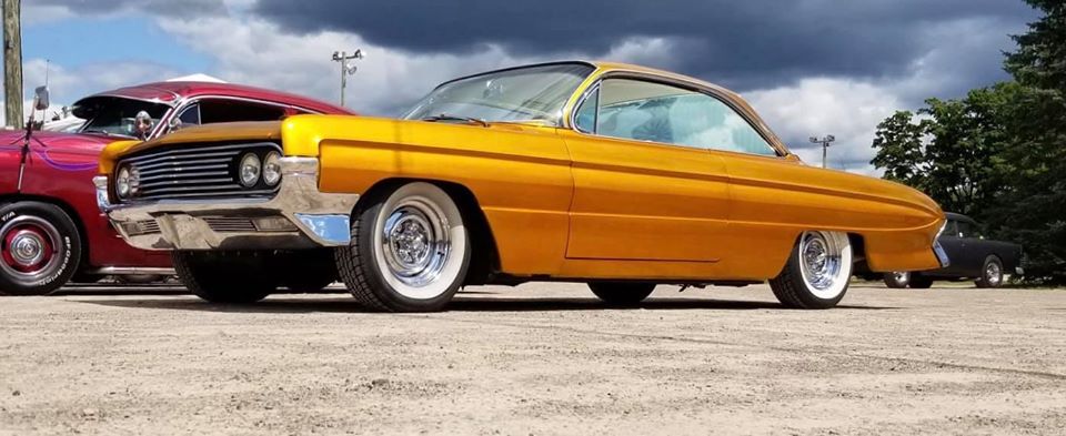

    My 61 Olds drives and rides like a million bucks, but I think it sits like a 4x4. The car would have a lot more at***ude if it were much lower. But I like how nice the car is to drive and enjoy piling the family in the car to go to shows. It's still a compromise.
    The reality is that air suspension gives you the best of both worlds. I know it's not "traditional" as it is for this board, and people dump on it as mini truck ****, but the ability to adjust ride height for both show and driving really allows you to not only look good but to log serious miles without beating you or the car to death in the process. This winter I'll be installing an Air Lift 3p system with two compressors. For the price of what air ride parts have come down to, whether it be Air Lift, Accuair, etc., or even if you put together your own system with manual controls, it's worth the expense for the overall enjoyment of the car. I've also talked to a few people who daily drive bagged O/T cars, and they have no issues with reliability with the systems. The reliability of the systems greatly depend on the quality of the install.
    For stuff that nobody is going to see on a custom car, I have no qualms about going to air suspension. I know some may disagree, and thats fine. I just draw my line in the traditional sand elsewhere.

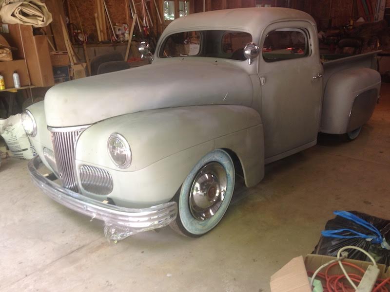

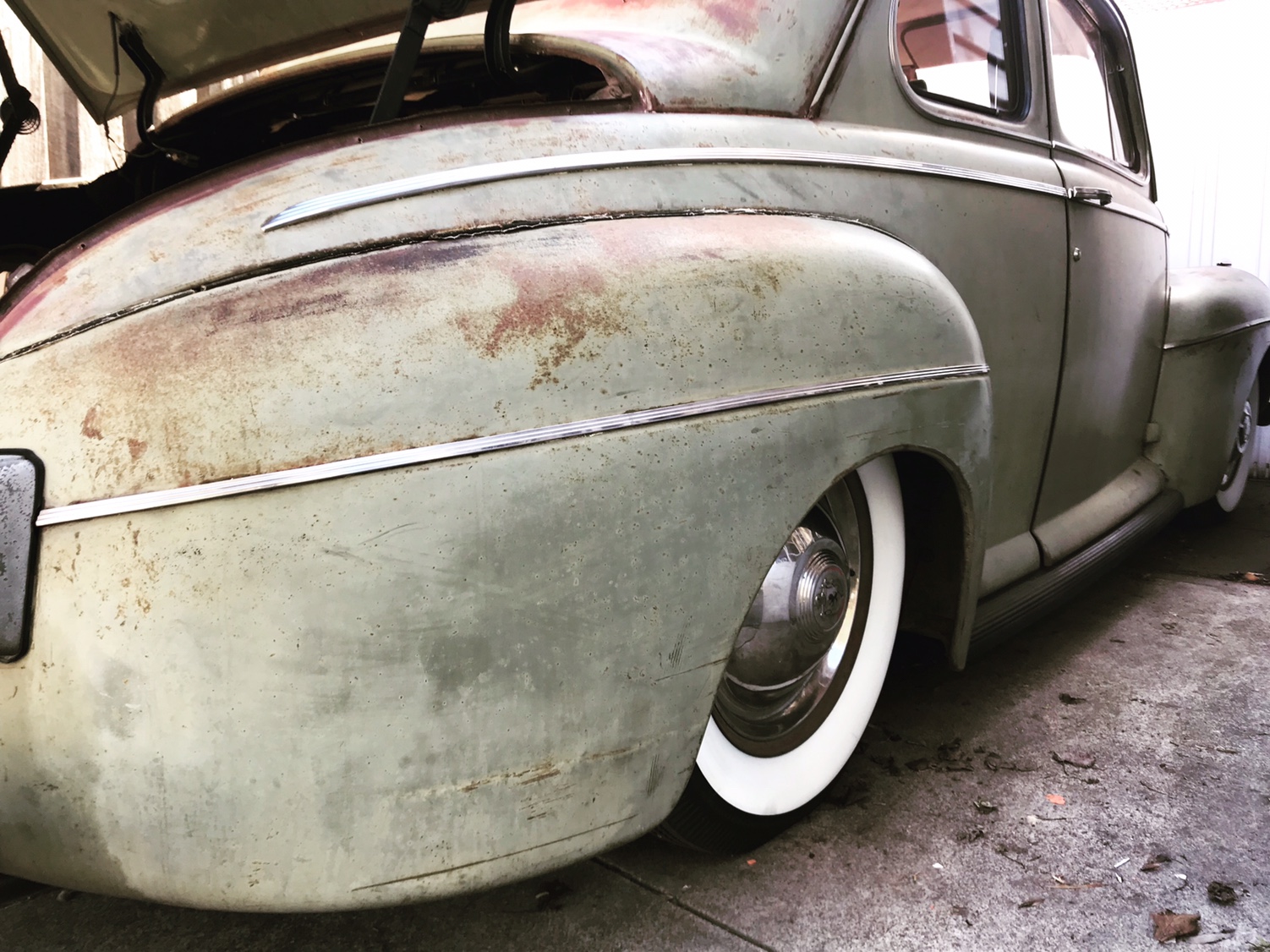

    Here's my '47 and it will be dropped in the rear and still drivable, may add air shocks for safety reasons...

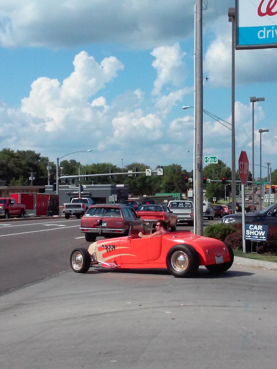

  24. My Roadster is pretty low. I sectioned the oil pan and oil pickup. 20160827_154355.jpg 66778283_340353620226891_3236306777213501440_n.jpg 81447853_473001626738224_8374564088302272512_n.jpg

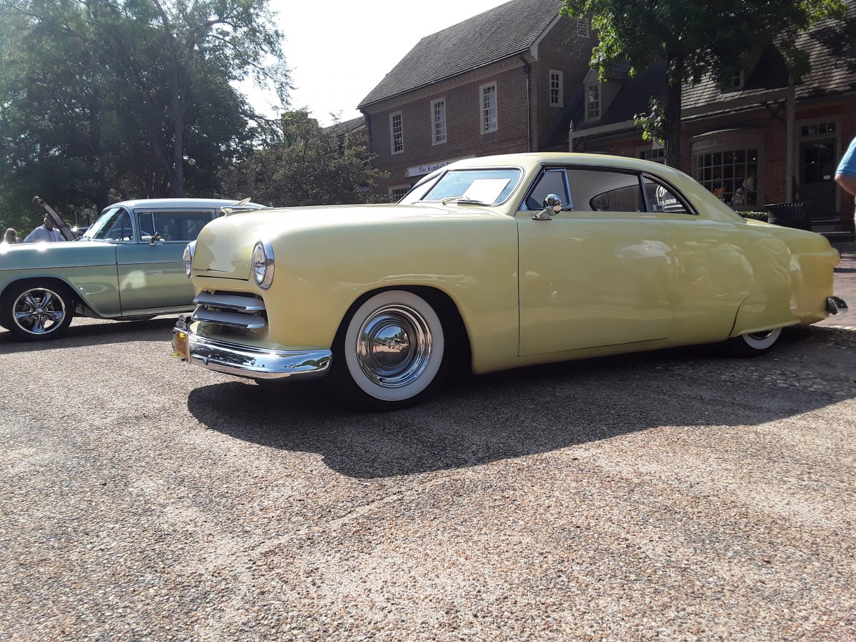

  27. Colonial Coupe
    Joined: Dec 22, 2010
    Posts: 74
    Colonial Coupe
    20180610_094251.jpg we drive it, but there are some places that I know not to go.
