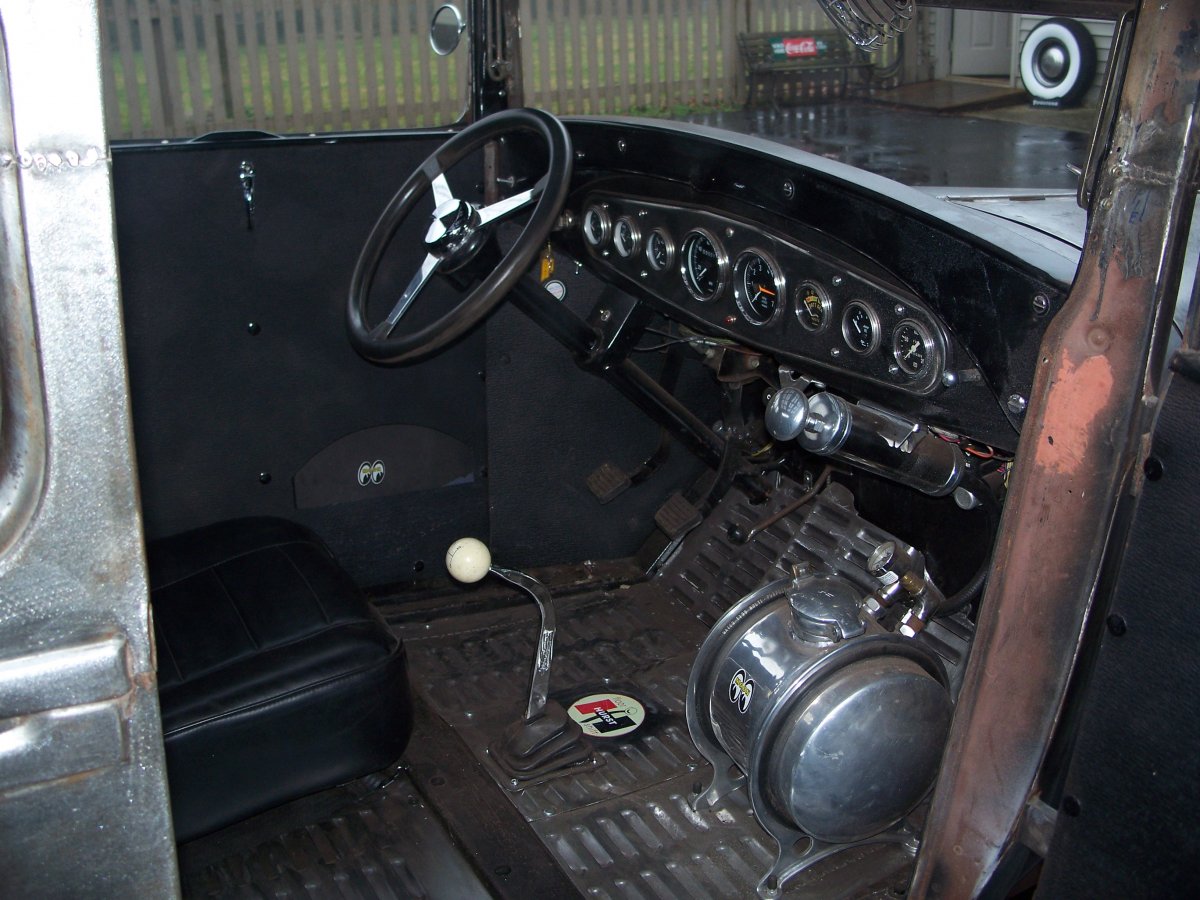

    for sale parts for poor boy 068.JPG I disagree^^^.. I don't call this a raised floor at all.. I've never had a problem with floor space in the small interior of a model A... This is the same car as the engine shot above...
