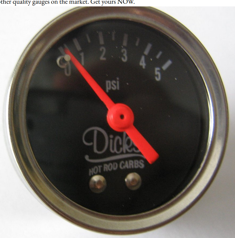

    The comparison should be between the Dicks 0-5 and the 0-15 posted earlier in this thread, you'll find that makes more sense.

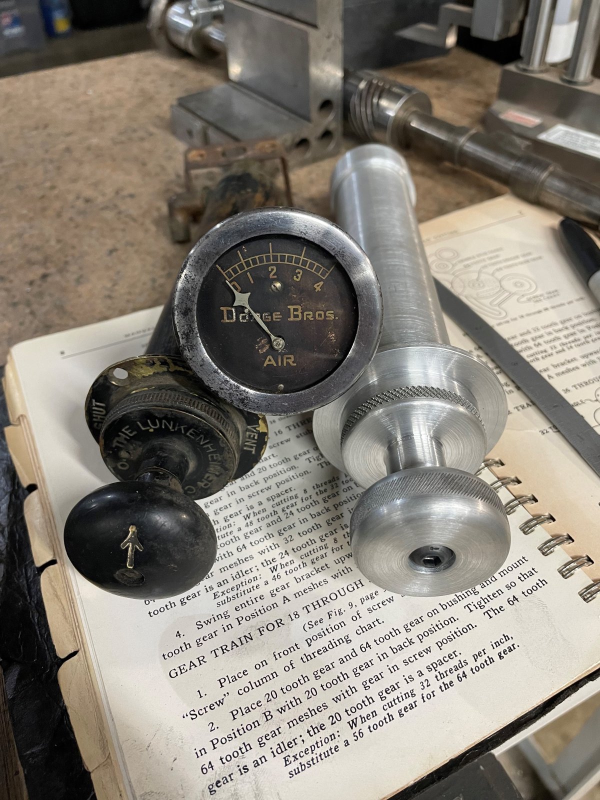

    I've been using the old air or oil pressure gauges they work well and check pretty accurate gauge 1.jpg gage 2.jpg

    why would a 0 to 100# gauge be less acurate than a 0 to5# gauge? I see no difference.
  10. 05snopro440
    Joined: Mar 15, 2011
    Posts: 2,162
    05snopro440
    Any instrument that has a larger scale is inherently going to have more error in the measurements at certain points in the scale.
    A 0-5 gauge also gives much better resolution when reading say 3.5 psi than a 0-100 gauge, because it's effectively zoomed in.
