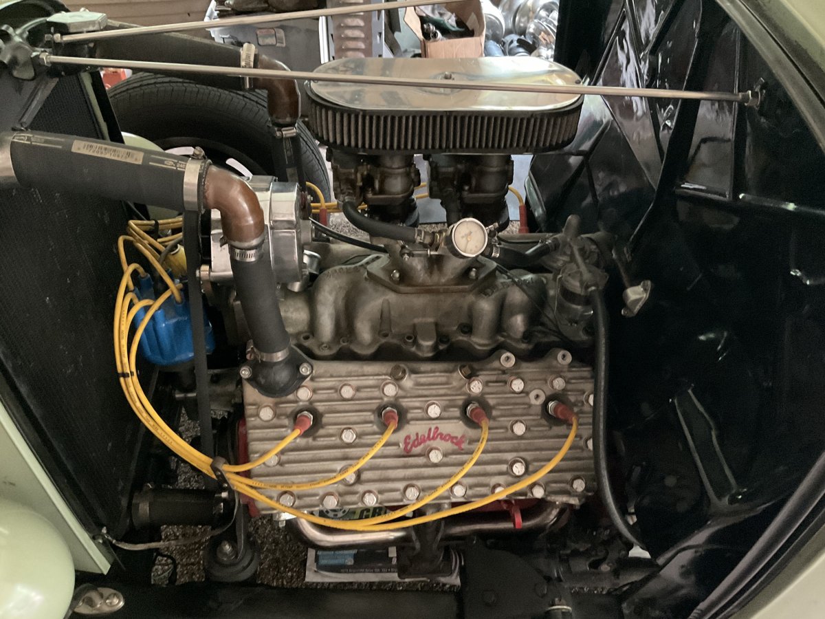

  18. imanut
    Joined: Feb 3, 2011
    Posts: 43
    imanut

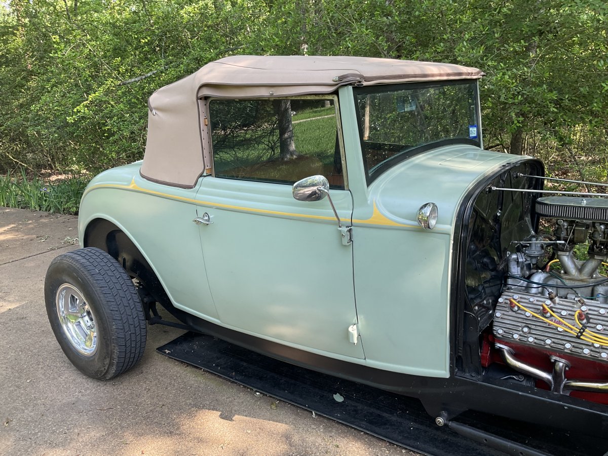

    Cool, I will check that out as well. This is a quick photo of the setup. The Filt-o-Reg Regulator is the chrome circle in the middle as the line feeds the Webers. It is the model without a filter.

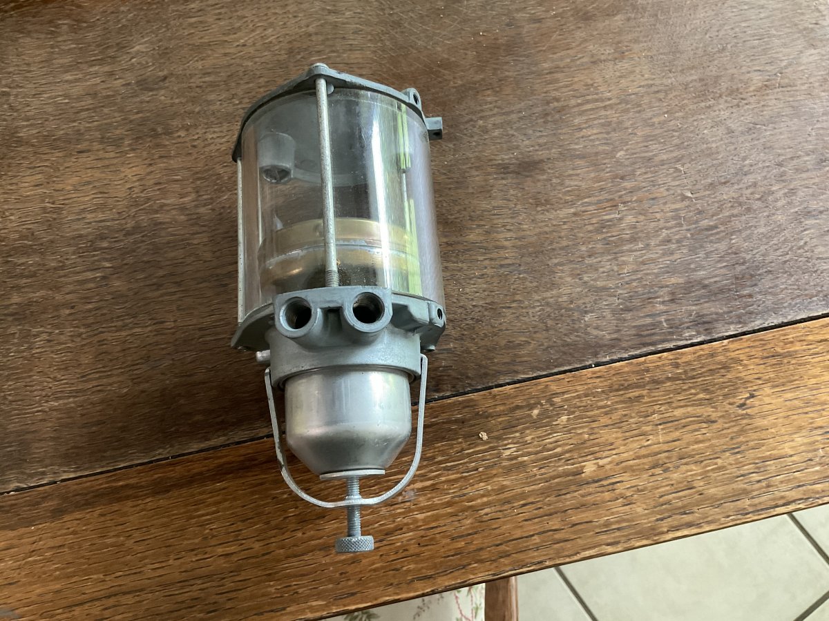

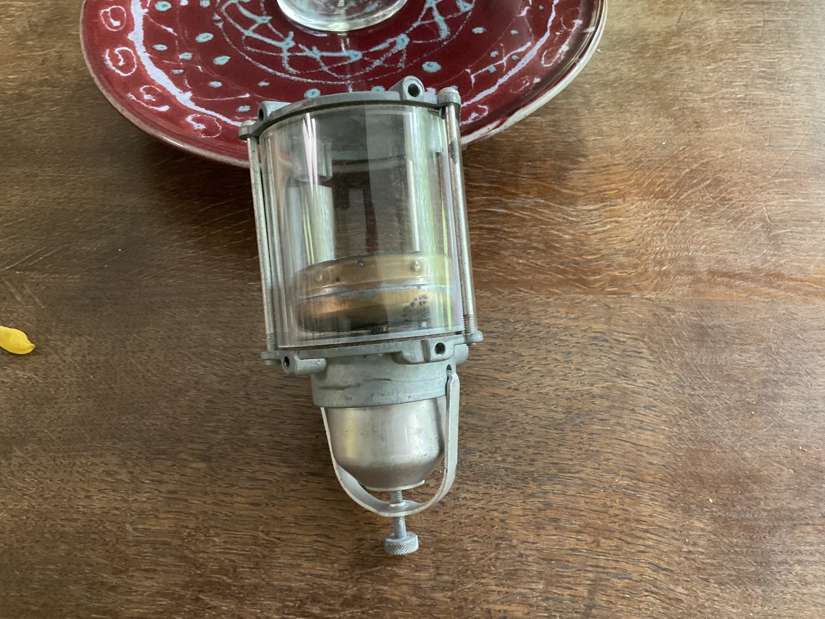

    I have a device that says Fuel Level Controller on top of part. Bought at a swap meet years ago and never did anything with it. Looks to be well made with a clear glass “bowl” and a big brass float that controls the level of fuel in the unit. It is old but has never been installed on anything. $45 shipped CONUS. No PayPal,postal m.o. is best. Over 900 posts—no money games played here. John in s.Texas 979-595-7324 cell.If interest is shown, I can take some pics and reply. I wrote ad b4 taking pictures. 8A63697C-79A0-4DB9-A294-0C8B11A5C482.jpeg 883B9D40-6826-43EF-AE26-CAC797B0EBEE.jpeg 3FC79D9D-7EDC-4FC9-8C1C-F91C3272CCC4.jpeg

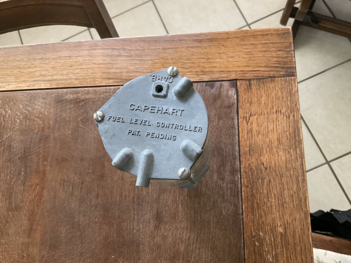

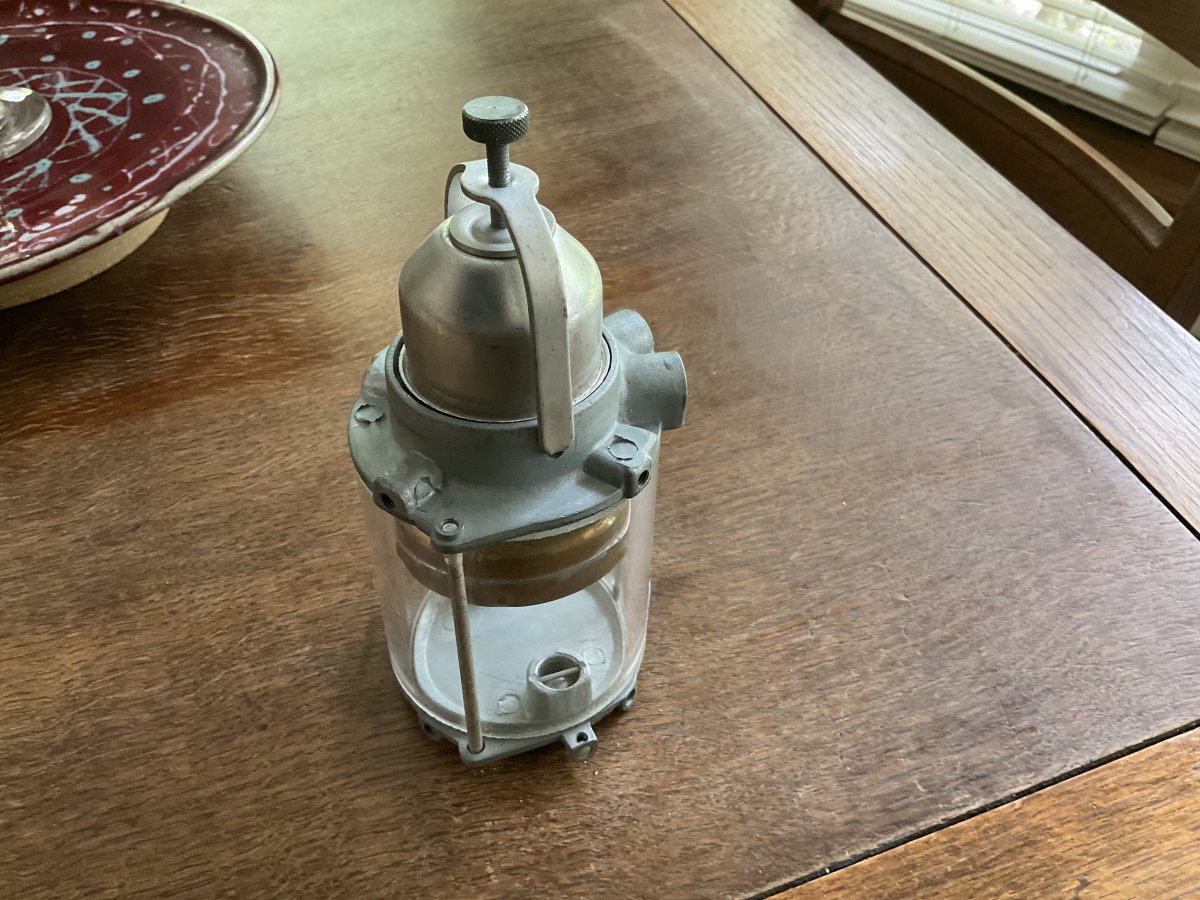

    Took some pics of fuel level controller. Unit is about 6 inches tall and approx 2 1/2 in around. Just guessing sizes—don’t have tape measure handy.John in s.Texas 979-595-7324 cell. 3C3816C3-8CF1-41D6-B785-4BDA30D7EBB3.jpeg 3C4B4DB1-E65A-4F23-AD69-AD6EBEEE6D48.jpeg 0214A30E-34C0-43F5-BF6C-3D0095964D4E.jpeg D862A47A-EF59-4C4D-A729-7956AF286270.jpeg 0D8EC2F5-6C9C-4D36-BD69-CC1BB7EBADBD.jpeg

    Wow, if I lived in CONUS I would buy that in an instant. It isn't a pressure regulator, but it is cooler than any of those that I've ever seen.
