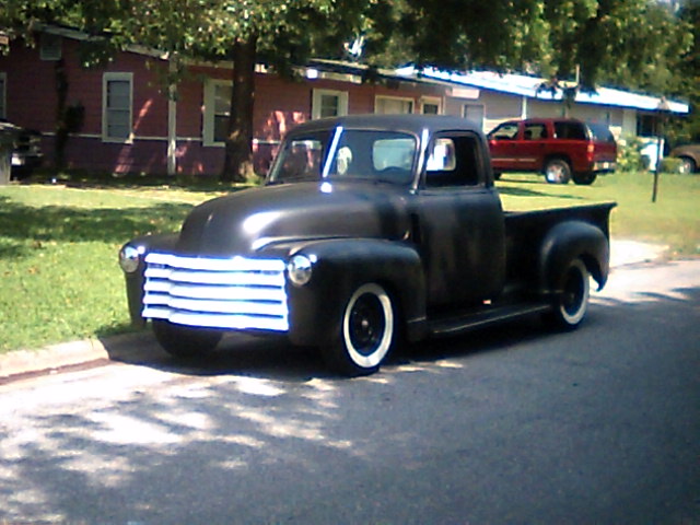

    Sorry :eek:,it doesnt really matter i guess on the make and model im just wanting sum inspiration to lower my truck in the front more.Im happy with the way the rear sits since i lowered it (3 inch blocks and leafs removed),but i want the front lower .It should be easy enough since the clip is real narrow and i have tons of tire to fender clearence now even with the tall Bias tires .I just want to see what others have gotten away with as far as ground clearence goes :) ...

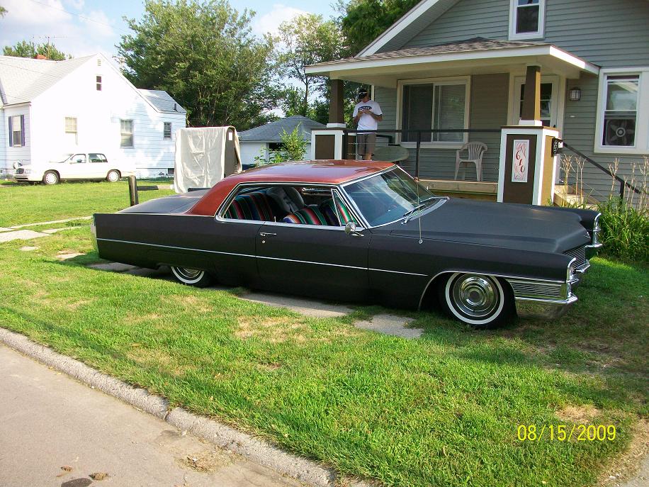

    My ole '65 Coupe Deville rode less than an inch at the lowest point....we don't need no stinking scrubline!

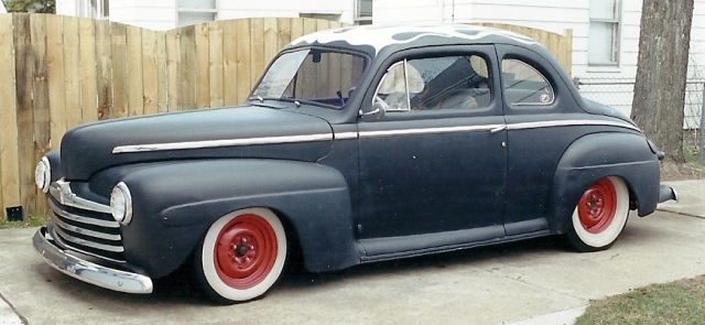

    My old '47 Ford coupe, and '50 Buick Sedanette...

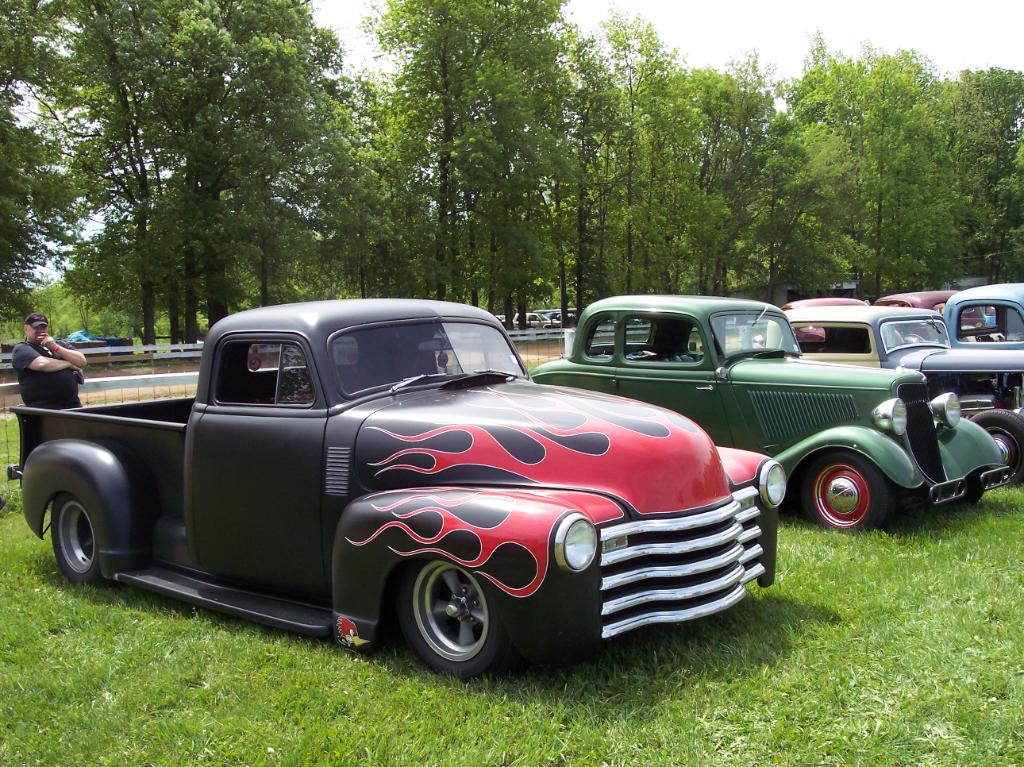

    Jdubbya's '55 truck.
    61Cruiser and Black_Sheep like this.
  22. The Shocker
    Joined: Dec 30, 2004
    Posts: 3,538
    The Shocker
    I love the stance on that one :).Its low but has that attitude with the rake ...

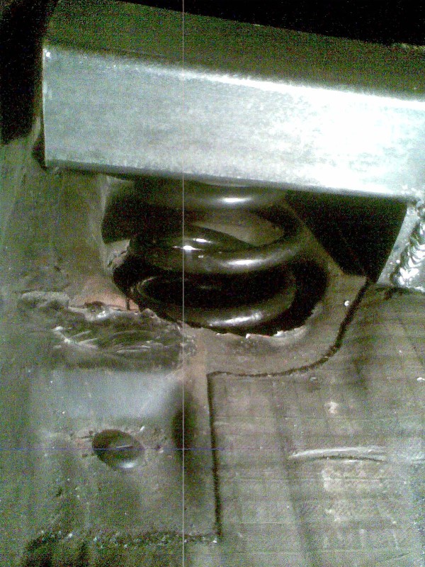

    Now for a little contribution. This is my O/T project, b4 i decided to bag it, bridge it and make it a full blown lowrider i had it severley lowered by mountin a crossmember inside under the rear seats, the coils would seat there passin through the floor (picture).
    This way i still had uncut coil springs but i was riding an inch off the ground, actually the frame was, as the rockers are higher than the frame.....also the front wasnt as low, cause the crossmemebr would have been to low for a static drop and this being my daily would have been a pain.
    It rode great. honest, if i have to do a static dop again in any coil sprung car this is what im gonna do.
    sory for the pic, its the only one i have on this set up.
    One thing to take into consideration when riding a super low non adjustable car is.....everything! LOL
    I remember thinkin what route was ok to avoid giant speed bumps, what malls where accessible, as most here have a very steep and short step to get in the parking lot, what underpasses where safe to do, and you have to look at the road w/ 4 eyes.
    I remember once tearin the fuel line on a pretty big hole in the tarmac! and another time bustin the very same line on a gate hook, the kind that sits in the ground in the middle of the gate.
    i also ripped a silencer and bent a front crossmember......theres more but cant think of it now.
    Its all part of the fun, but i think its better to know these things 1st.

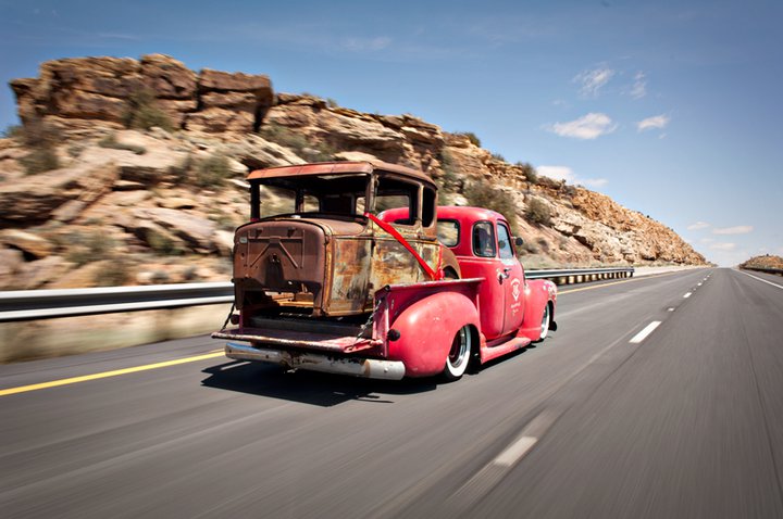

    nicknamed....the "HOVERCRAFT"
    on the way to Vegas from N. Carolina - empty.......the way back w/30 Coupe body
