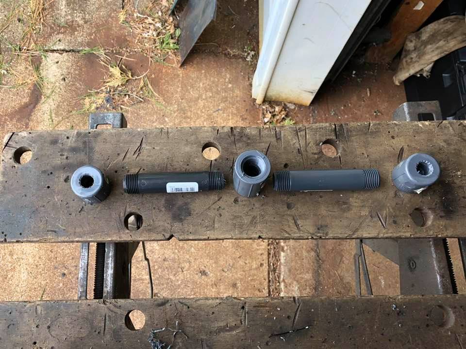

    36cab
    I bought two threaded 4” PVC risers, two PVC end caps and one PVC coupler. The 1/2” tubing just fits through the center hole in the coupler. I drilled a 1/2” hole in the face of each end cap and I screwed all pieces together 2.jpg

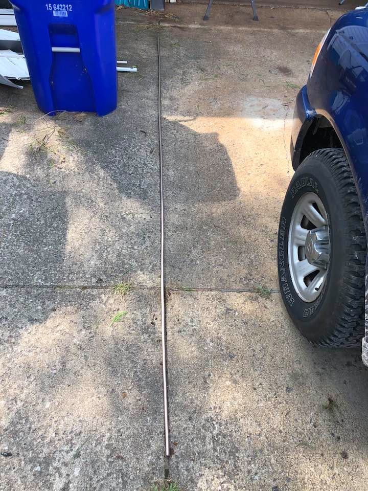

    36cab
    I had straightened the tubing by hand as much as I could without kinking it. I threaded the tubing through the three holes and slid the straightener up and down the tubing. It did a pretty good job of straightening it. If it came to a tight spot or if it jammed to a stop I would back the device off and straighten that spot by hand and then start sliding again. 3.jpg

    I used the concrete saw line in my driveway to check the straightness. It wasn’t perfect but the tubing was straight enough for me to start running down my frame rails. And the best part was it only cost me $7.50 to make it! If I was going to make one change to my home-made straightener I would add two more couplers and use four 2” long risers, three couplers and two end caps. I think having five holes to slide through instead of three holes would help make the tubing even straighter.
