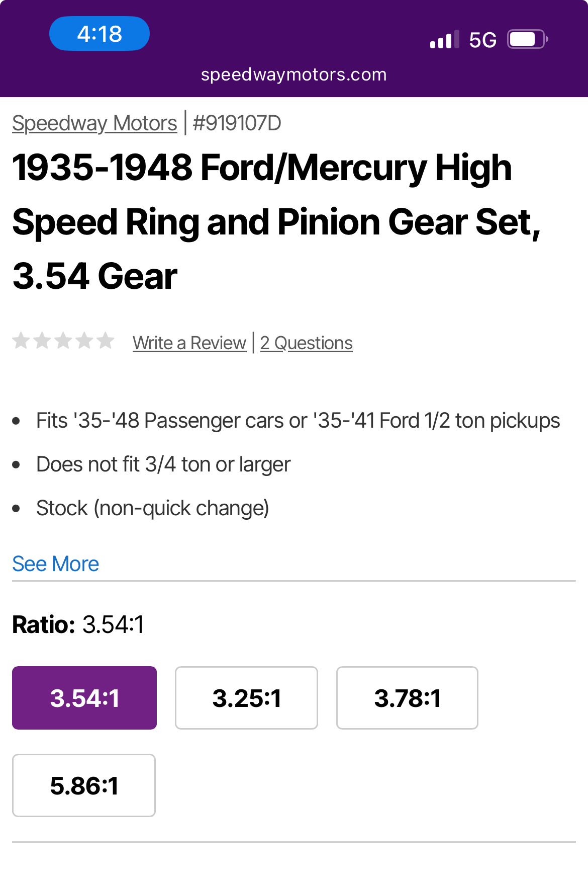

    Speedway has some as low as 5.86 but that’s probably too low. Im thinking I need something around 4.30-4.50ish range.
