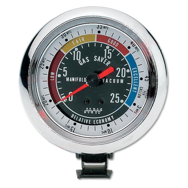

  7. Horsepower67
    Joined: Nov 15, 2006
    Posts: 536
    Horsepower67
    Get one of these and experiment.
  8. It's not the rpms so much as it is the vacuum the engine is pulling.
    If the car pulls a higher vacuum in 4th than it does in 5th, mpg will be improved if you run 4th.
    ZZFords combo above sounds close to being on the money for running in OD.

  9. lindross
    Joined: Jun 15, 2006
    Posts: 1,634
    lindross
    You got it. Manifold vacuum will teach you a lot about how "efficient" your setup is. I know I've learned a lot watching my father tune a car with solely a vacuum gauge.

  11. One more quick one.
    A long time back dad told me that if a torque curve graph was available for your engine, gear it for the peak torque rpm.
    And pay attention to the vacuum gauge.
    I don't know why more people - specially rodders - don't run them.
    A terrific tool to drive by and an on-board diagnostic gauge as well....

    i did the drive by vaccuum gauge deal for a couple weeks... once you get used to tickling the peddle , you'll be amazed at what the mileage will do... i could keep mine at expressway speeds and still keep the motor at 16 to 17 inches....was idling at 19.5 as well... brandon:D
