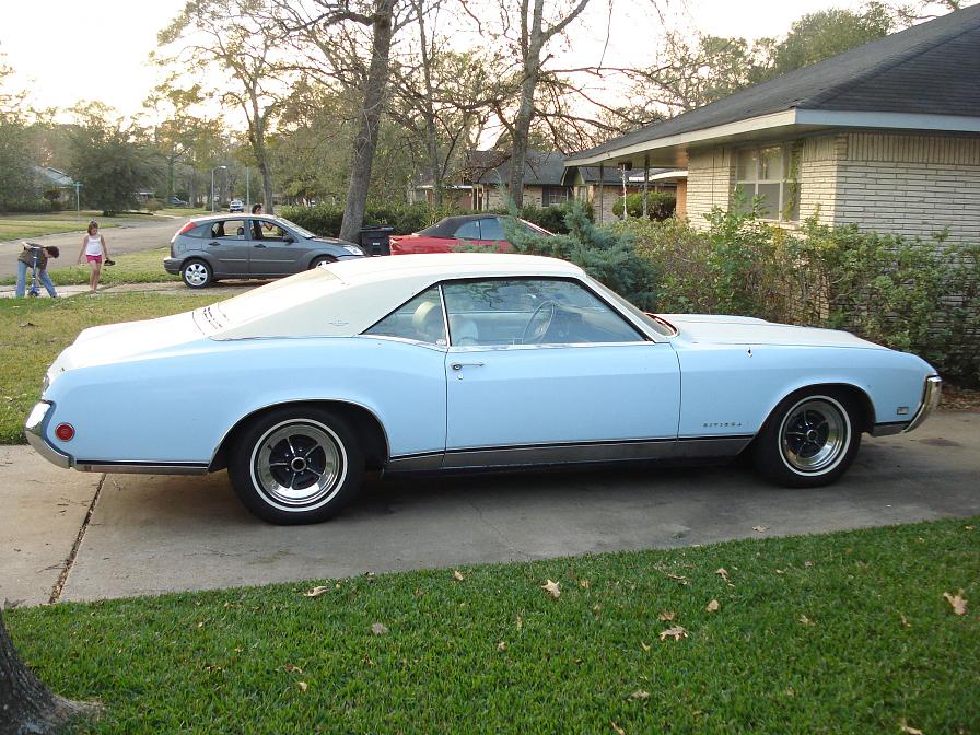

    I just recently cut the front coils on my '69 Riviera (one coil each side) and it lowered the front a good 1 1/2 to 2 inches. The rear was low enough stock, the front just needed the nose down a little. I think it came out just about perfect. I've attempted to attach a picture of it.
    Don't be hatin' on me 'cause of the year, it still related to this topic.
    Dave
