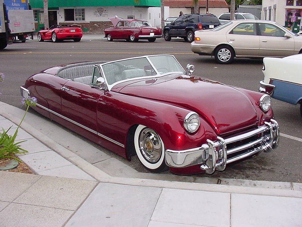

  14. Special Ed
    Joined: Nov 1, 2007
    Posts: 8,697
    Special Ed
    Okay. Here you go. Wheel wells, trunk floor are all intact, and NO jacked up camber. It can be done, it simply needs to be ENGINEERED correctly.
    Muttley and luckystiff like this.
