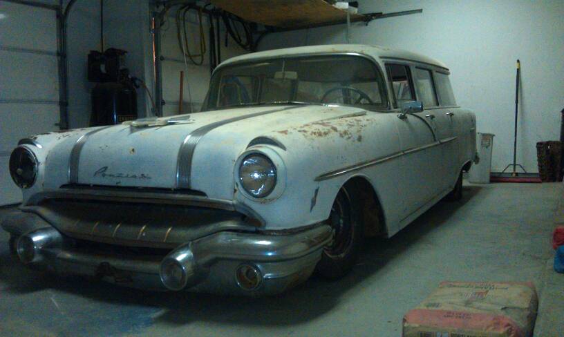

    I have a 57 pontiac. front end is king pin style. I lowered mine by used tri5 lowering springs and blocks in back. the rear springs mount to the shackles thru tapper shafts not bolts, so keep that in mind good luck! no pictures lost them and wagon is in getting body work done.

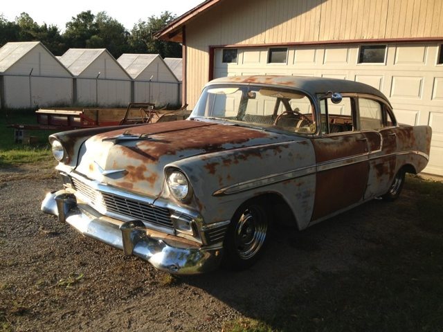

    Patina isn't bad, just good excuse why hasn't been painted yet. Kinda like my belair ;) ImageUploadedByTJJ1354580083.669461.jpg

    Love that 56 that's cool

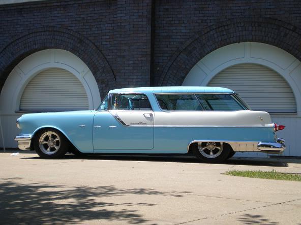

    user66728_pic39083_1231382096.jpg Will this work for you, it's my wife's 55.

    This looks good. Stance is righteous, color is spot on...

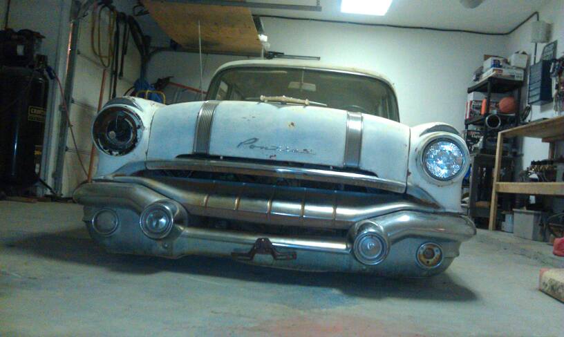

    He'll yea 55rod!!

    Is your wagon on air? How did you set it up?
  18. Swiss50chevy
    Joined: Apr 30, 2009
    Posts: 561
    Swiss50chevy
    Is that on air?

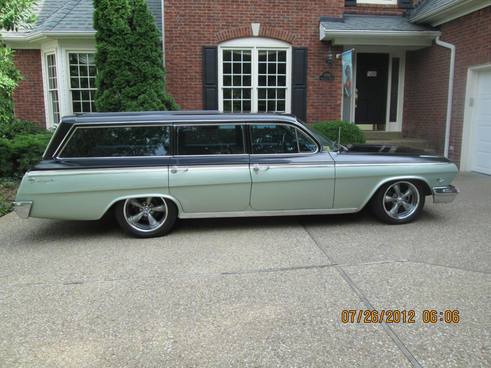

    My 62 Impala wagon has 2 inch drop spindles in the front and a nine inch Ford rear with cut coils.

    Yeah...used universal bag buckets in front with 2600 denominator bags up front , and on back kept 3 leafs and 3 inch lowering blocks.

    Nice impala Gman!!
