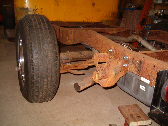

    You can keep all of the rear leaves and turn the rear shackle up-side-down.
    My avatar is a 1948 F-1 panel truck. The frame and drivetrain were the same as used in F-1 pickups. For a while I ran it with some rear leaves removed. Hated it. Looked great but it would bottom out on the most minor of bumps. I turned the rear shackles over and installed a full set of refurbished springs. If I remember correctly, I ground off the rivet heads and drove the remainders out. I believe that the 4 bolt holes are the same if you turn the shackles over. I used grade 8 bolts with double nuts and reattached them.
    I believe that this lowered mine about as much as I could without notching the frame.
    One minor modification is required. The leaf and shackle interfere with each other if the shackle isn't relieved somewhat. It's only some minor grinding but must be done.
    Note that these pix are the ones I downloaded from a H.A.M.B. thread before I did my modification. I took pix of mine but can't find them. When I did mine I cleaned and painted everything. I also replaced the shackle pins and bushings.
    This is the unmodified p***enger side setup:
    P***enger side after reversing; finger points to where shackle must be relieved:
    Look closely and you can see where this shackle was ground for relief right in the curve (this is the driver side shackle):

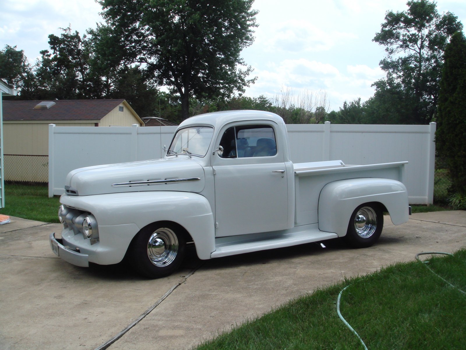

    Flipped the rear axle, Mustang 2 front end 506EEB27-2E0F-465B-95FB-251E00C13F60.jpeg

    My F1 is sitting alongside my shop. NO rust ever, it's a '52. A friend 'donated' front sheet metal to make it a '50.
    Yours is sure beckoning to me... (M II front end)
    That truck sits just...Dreamy!
    (Is there room to adjust some positive caster into it? I 'corrected' an installation of Dodge Diplomat front susp. in a '54 F100. MUCH cutting and welding, finally the truck stopped trying to chase its tail. Very 'squirrelly') Fixed it.
    Dino 64 likes this.
