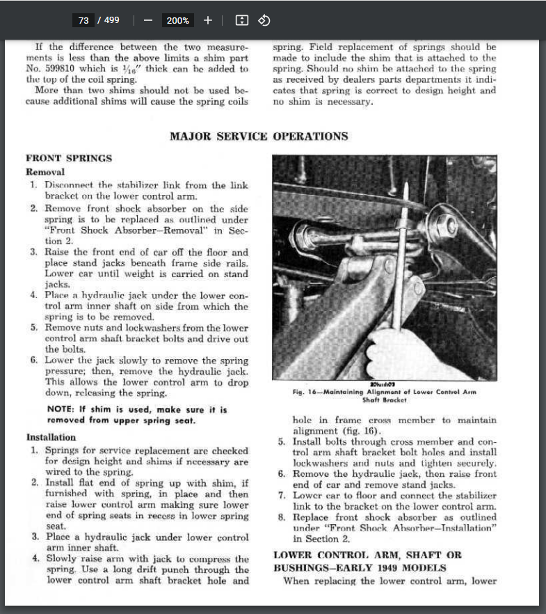

    I've just received a 3'' lowering kit (springs, shocks, and blocks for the rear) for my 1953 Bel Air sedan.
    I've reviewed the shop manual and online posts/videos about removing front springs. I intend to use a floor jack underneath the a-arm to lower the spring out.
    My question is the best approach for lowering that a-arm. After removing the stabilizer link, some information online suggests to remove the inner 4 bolts from the a-arm to lower it from the center of the car. Other information online suggests to remove the lower bolt from the spindle/upright to lower the a-arm from the outside of the car.
    What method is recommended? I've never done this before, so I'm trying to gather up as much information as possible. If any of you have photos or videos that you can share of the process I'd love to see them. Thanks!

    I can see how that might happen. Using long tapered punches to replace two bolts might help. I think it also requires the car to be supported pretty high up....but a positive is that you don't have to disassemble the funky outer control arm bushings

  10. Mr48chev
    Joined: Dec 28, 2007
    Posts: 35,308
    Mr48chev
    The pfd of the full 53/54 service manual is here https://www.rcamoto.com.br/autosantigos/pdf_zip/1949 - 1954 Chevy Shop Manual.pdf
    Removing the front spring is on page 72. As Jim aka Squirrel said, the factory method is to remove the lower control arm shaft bolts and drop the A arm from the inside rather than the outside as we normally do on most later suspension.
    I'm thinking that you will have less hassle putting the new and shorter springs in than taking the old ones out. A helper working the jack who is damned good at doing exactly what you say when you tell them to do it goes a long way in this job. Screenshot (557).png
