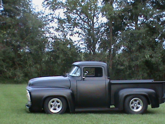

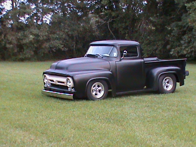

    Here is mine it has a narrowed pacer under it with Granada rack. Rebuilt it all not long ago handles OK. Cush ride on highway. DSC00014.JPG
