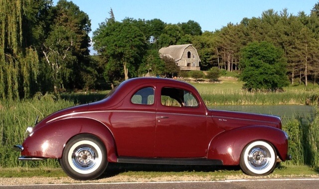

    my 40 with a stock wishbone and a 4 inch Magnum axle. I think my wheels are pretty much centered

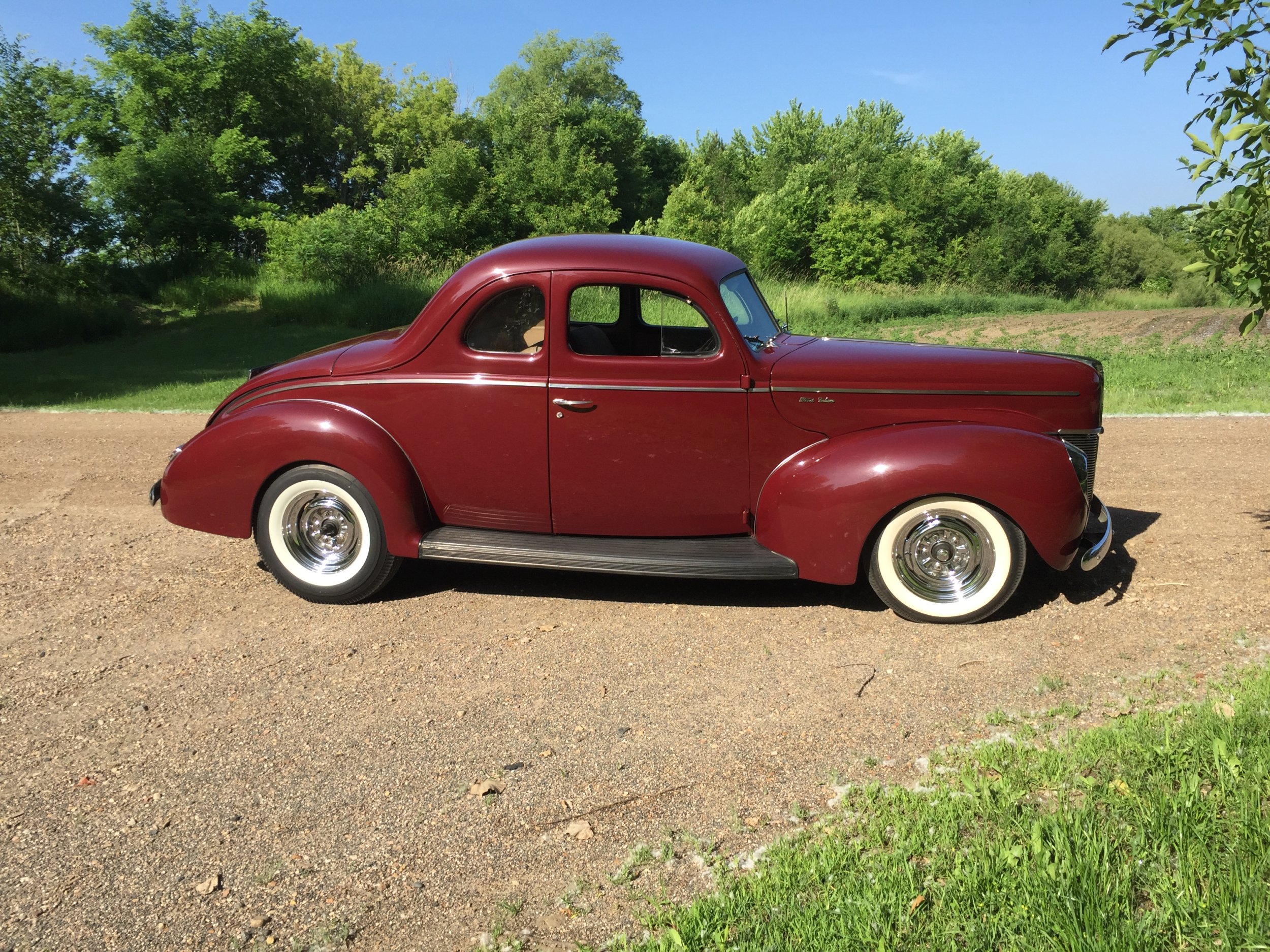

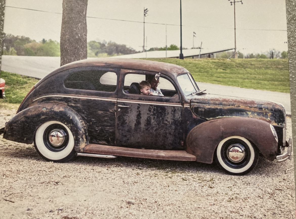

    My 39 was pretty lined up IMG_0115.jpeg But my 40 was back in the opening a bit. The 40 was lower than the 39. IMG_0116.jpeg

    Dan’s cars are a perfect example of the lower you go, the worse the misalignment shows.
