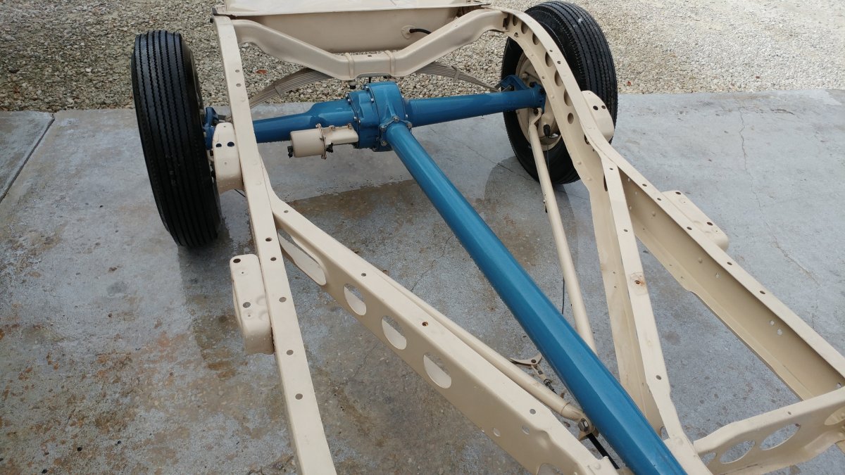

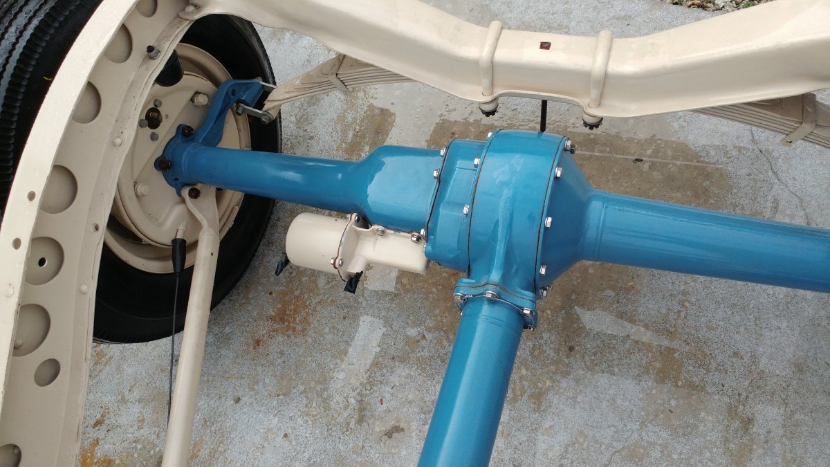

    image.jpeg image.jpeg Has anyone ever replaced the rear crossmember in a '40 with a flat crossmember to drop the rear end and use the Banjo rear and spring? I have a nice frame with a Columbia that I'd like to use. What are your feelings on this?

    If you flatten the cross-member, the frame will need to be "C"d for axle clearance.
    Depending on body style, reversing the main leaf & removing some top leaves so as to leave 6 of the long leaves will lower the car sufficiently without the axle hitting the frame.
    Works for me.

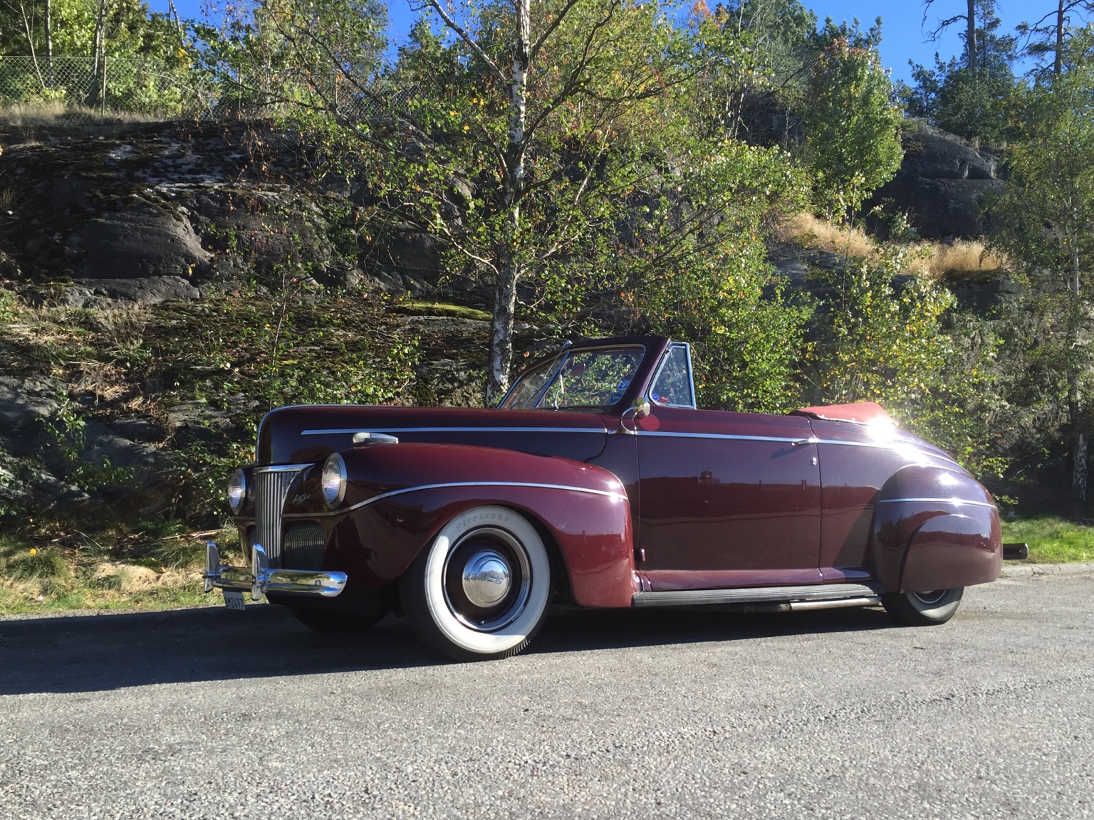

    I build this support then i lowering my 1941. It works wery well and i made them 4" high. It also lowered the car 4". Much better than mess with the shackle.
    46international likes this.

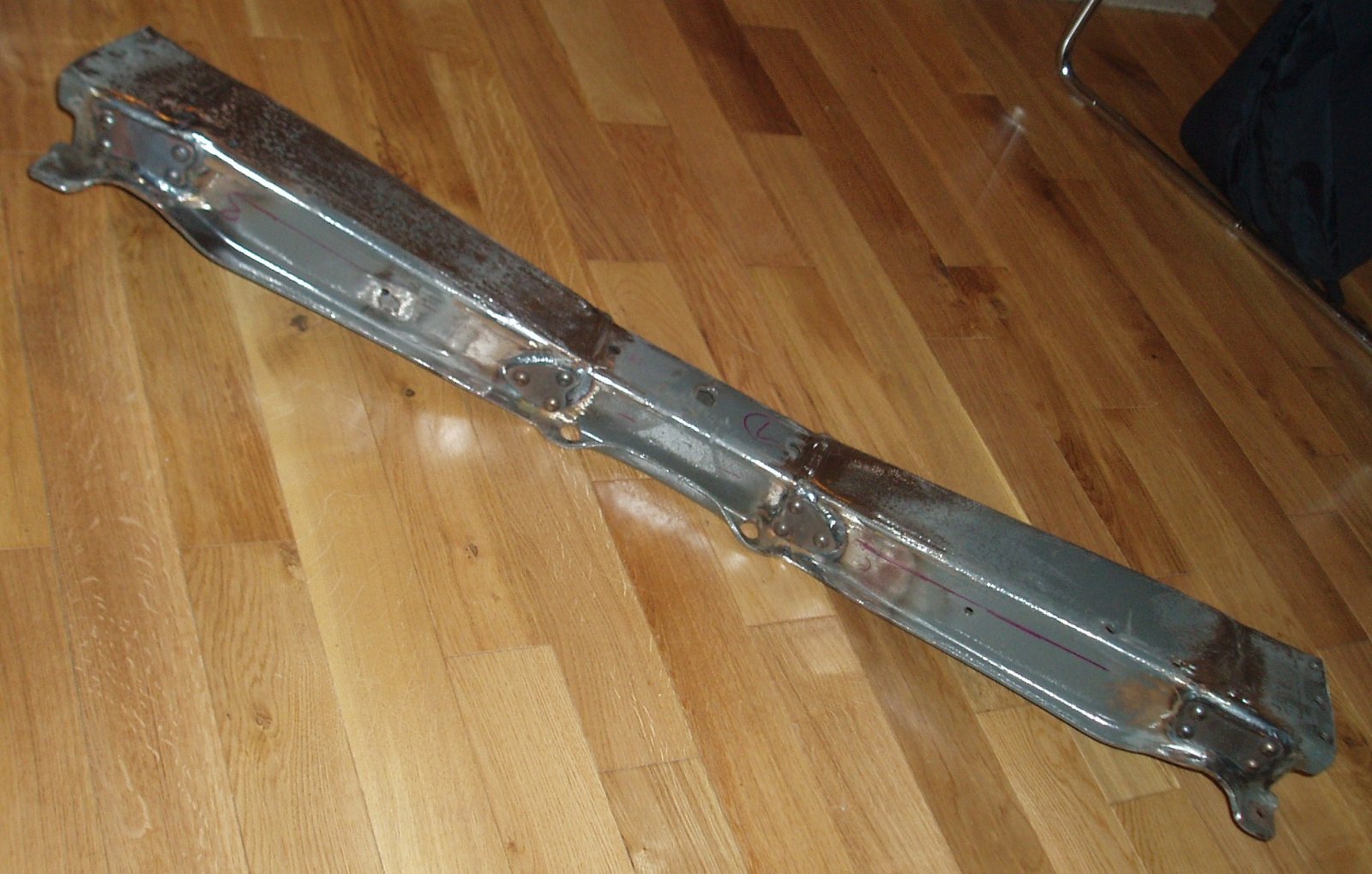

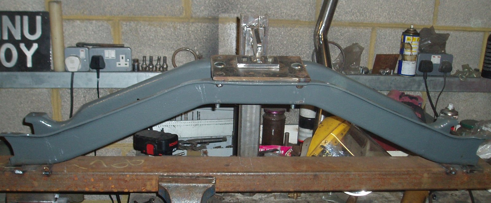

    My rear crossmember the first time around. I took it out, cut it up and used a jig to get it back together square, but I have heard of people vee cutting it the car, dropping the car to the ride height they want, and welding it back together.....
    Big Al likes this.
