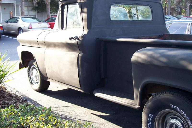

    this a pic of rearend of 61 chevy
  25. Rain_man
    Joined: Dec 7, 2009
    Posts: 183
    Rain_man
    it has two coils and a shock on each side
    anyone know what the 2nd coil is for? it looks a little bit smaller then the first

  29. terd ferguson
    Joined: Jun 13, 2008
    Posts: 3,734
    terd ferguson
    That's not a factory setup. The coil on the right is in the factory spot, but it doesn't look stock. Stock rear coils are "pigtailed" at the top and bottom (they taper down to smaller at both ends). The shocks also look extra long (unless your truck is jacked up in the pic.
    You will be ok swapping coils for the Jeep coils. Just remove the extra coils that are on the axle. Prepare for maybe needing shorter shocks if the ones you have are extra long. Search 67-72chevytrucks.com and you'll find a part number for lowered shocks. Or one of the catalog places like LMC sells them. They may be a little cheaper at AutoZone or some place like that if you can get a part number or the length you need.
    The amount of redneckery these trucks in particular sees over 40 or so years never ceases to amaze me. Going by your pic, that won't be the only crazy thing you find as you dig deeper.
