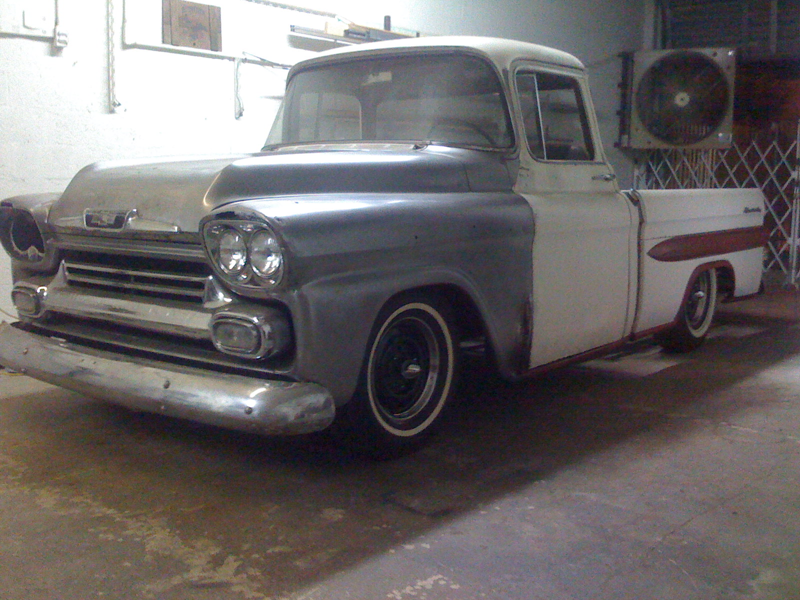

    I've got a 58 and i just did a hollywood flip on the front and set the rearend on top of the springs, worked just fine. cheap too.

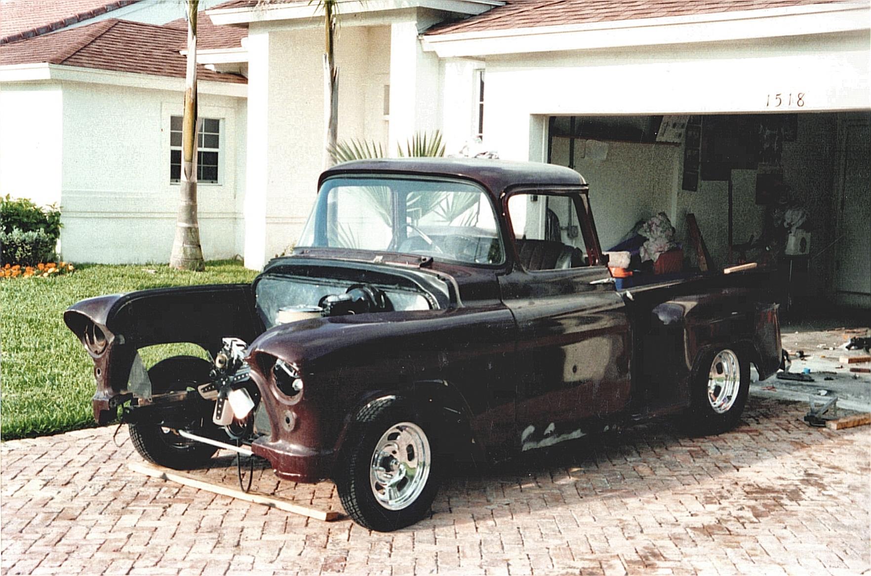

    Do the clip its not very hard + you get power brakes power steering with it
