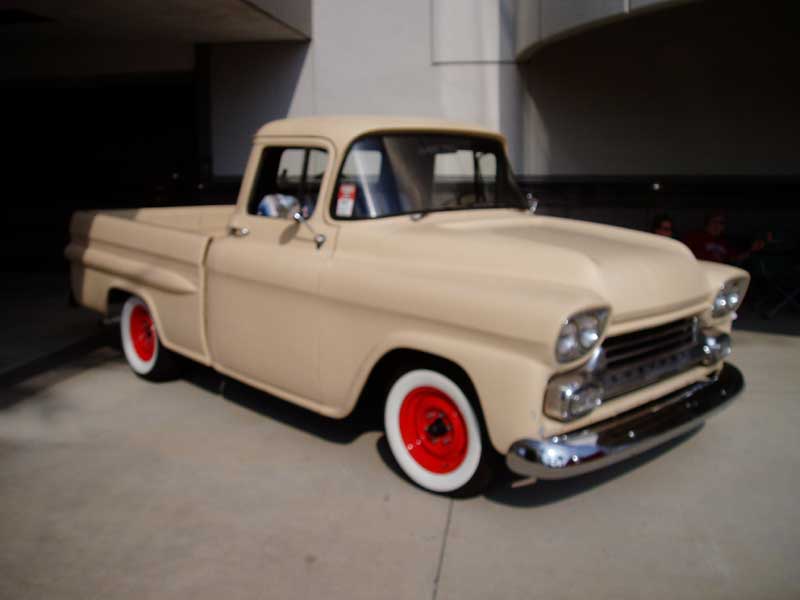

    Heres a 57 down low. C'd frame in the rear, Volare clip up front. a fairly easy conversion...... Its pretty adjustable

    chaz- thanks for the pic,how much lower do you think the front could go?

  16. Chaz
    Joined: Feb 24, 2004
    Posts: 5,016
    Chaz
    I think it would take a lowered set of spindles to get the front down much more than shown in the pic. You need to keep rreasonable travel in the suspension. I know a lot of guys will have only about 1 1/2 in of suspension travel, but I wont do that. Seems stupid to me to sacrifice reasonable comfort for looks. But then I'm an older guy with a bad back.....
    Then there are the problems of tire interference with the front fenders on turning You have to bubble the fenders or reverse the rims and this can cause steering geometry problems. I guess what I'm saying is it could be done, but at what cost.?
    Its kinda like when you chop and channel a car so much that you are sitting on a 1/2 inch piece of wadding on the floor. The car looks awesome, but try going 300 miles in it. Thats prolly not a popular opinion here, but you can have both looks and comfort if you exercise a little restraint.

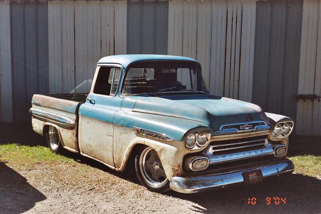

  18. Welcome, bigrig!
    I don't know how this was lowered, but if it shows up at the "Pile Up" again next week, I'll find out.
    This was the "it" ride last year, or so I thought! :D ;) :) I hope this helps.
    Joel

  20. squirrel
    Joined: Sep 23, 2004
    Posts: 59,219
    squirrel
    I saw that truck on the Hot Rod mag drive last year, here it is in Missouri

  30. JEB
    Joined: Apr 23, 2005
    Posts: 95
    JEB
    I dig that truck, it's my computer desktop picture. But I never could figure how they tucked those big rims and didn't have a clearance problem.
