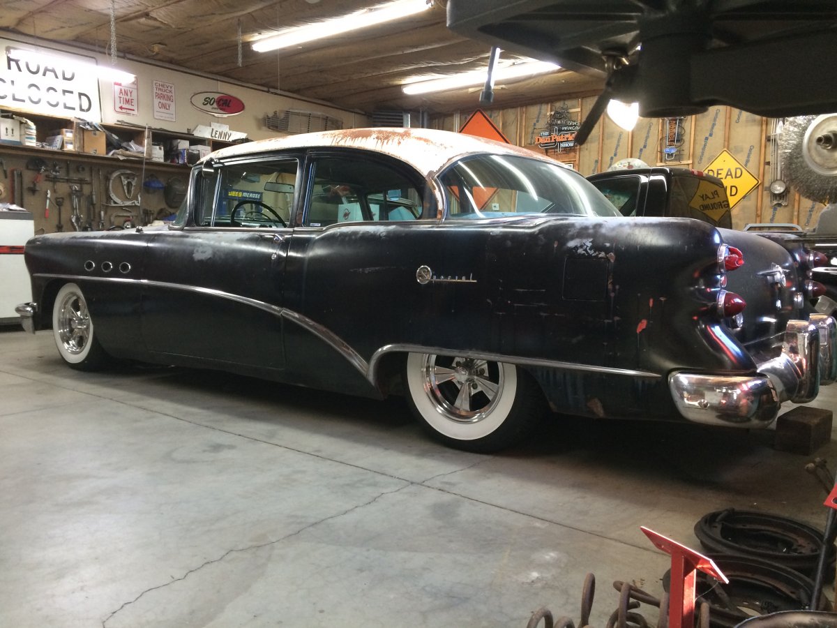

    IMG_0945.JPG On my 54 Buick I bought 3 in lowered coils all around from Jamco and also got shocks. They custom build for your car taking consideration on what make, model and engine you have. I installed and the height measures very equal height all around. Im happy but have not drove the car yet because brakes aren't done yet.

    What size wheels and tires are you running on your Buick pacecar

    15x7 rims, 205/75 and 215/75
