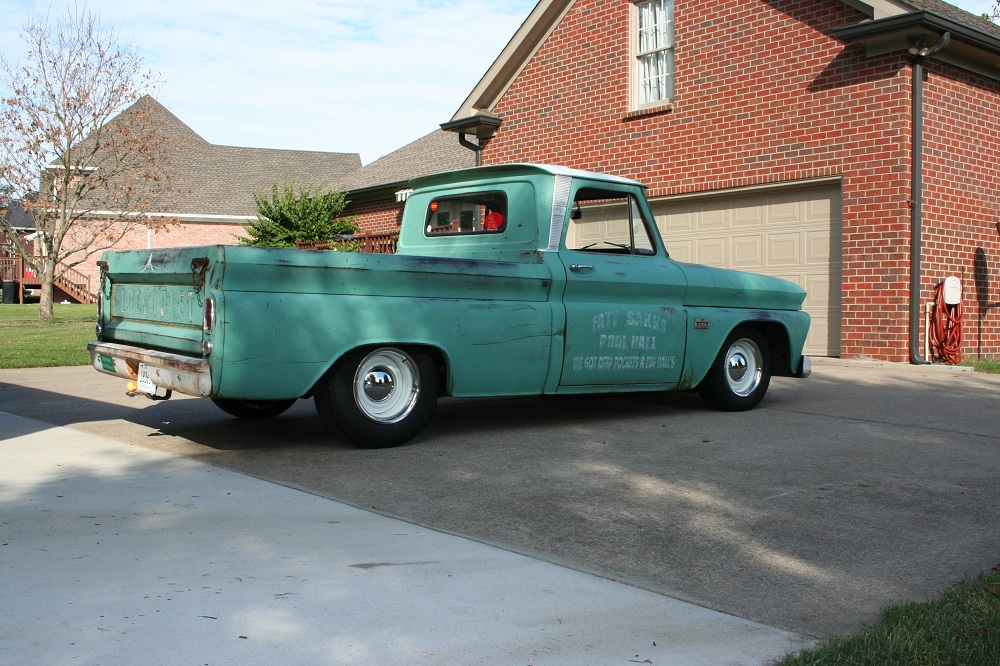

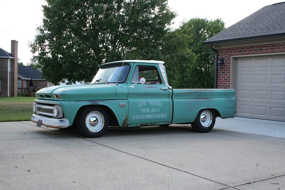

  7. ultrahd4me
    Joined: Nov 4, 2009
    Posts: 8
    ultrahd4me
    Another cheap option is any later A or G body rear coil with pigtail ends. The springs are a little shorter and have a great ride, but you will very limited on your payload.

  9. EasyBake
    Joined: Jun 13, 2010
    Posts: 141
    EasyBake
    from Bedford IN
    Ultra that is perfect height! You know about the drop it gave ya?
  10. B.A.KING
    Joined: Apr 6, 2005
    Posts: 4,039
    B.A.KING
    yeah that truck looks nice,how much in front and how did you get it.
  11. ultrahd4me
    Joined: Nov 4, 2009
    Posts: 8
    ultrahd4me
    Thanks guys. It's lowered about 6" front & 5" in the rear. 3" springs in the front with a coil cut off, and lowered G body springs in the rear. It's a little harsh on big bumps but drives good otherwise. My angles are a little steep on the shocks, so a relocator kit would help I'm sure. One bid downfall is the front crossmember is only 3-4" off the ground, so you better be on your toes.
    Thanks again.
    1Nimrod likes this.

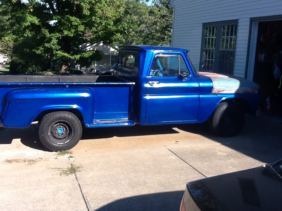

  12. EasyBake
    Posts: 141
    EasyBake
    from Bedford IN
    here is mine trying to get it close to that
    1Nimrod likes this.
