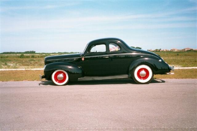

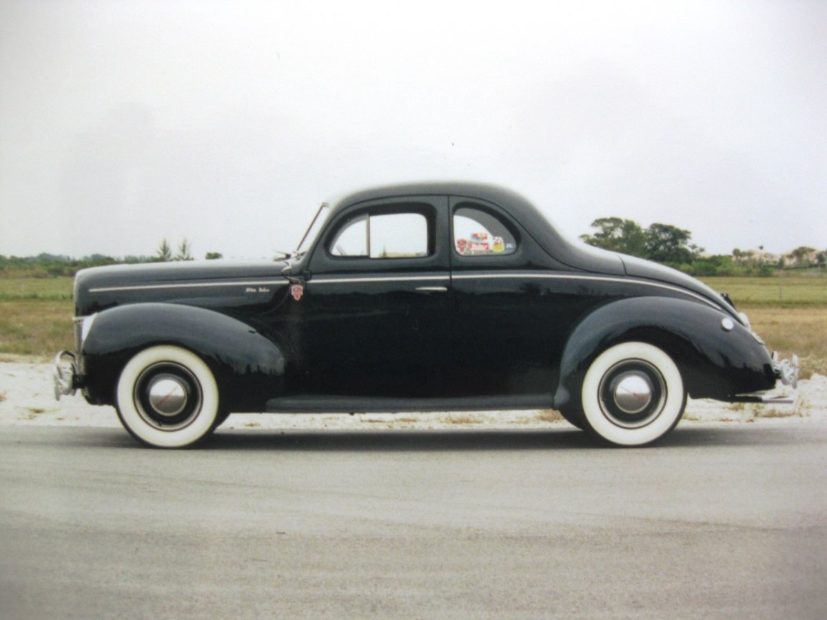

    You can see the shape of the bearing in the black blob below and later what's left of the bearing. Next to last photo is 40 Ford with stock front suspension and rear suspension with flathead engine and stock transmission and stock 16 in. tires and wheels. The only thing changed was the installation of Posie #2440 reversed eye spring which immediately lowered the car 1 inch and will lower it a little more once it settles. Photo was taken right after install. A 4 inch dropped axle would lower it 2 more inches. The drop obtained in the very last photo is explained in the links. Hope this helps. All the best with your 39.

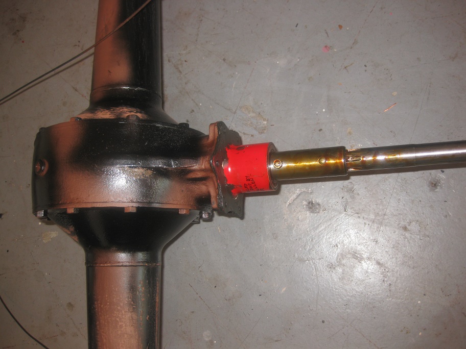

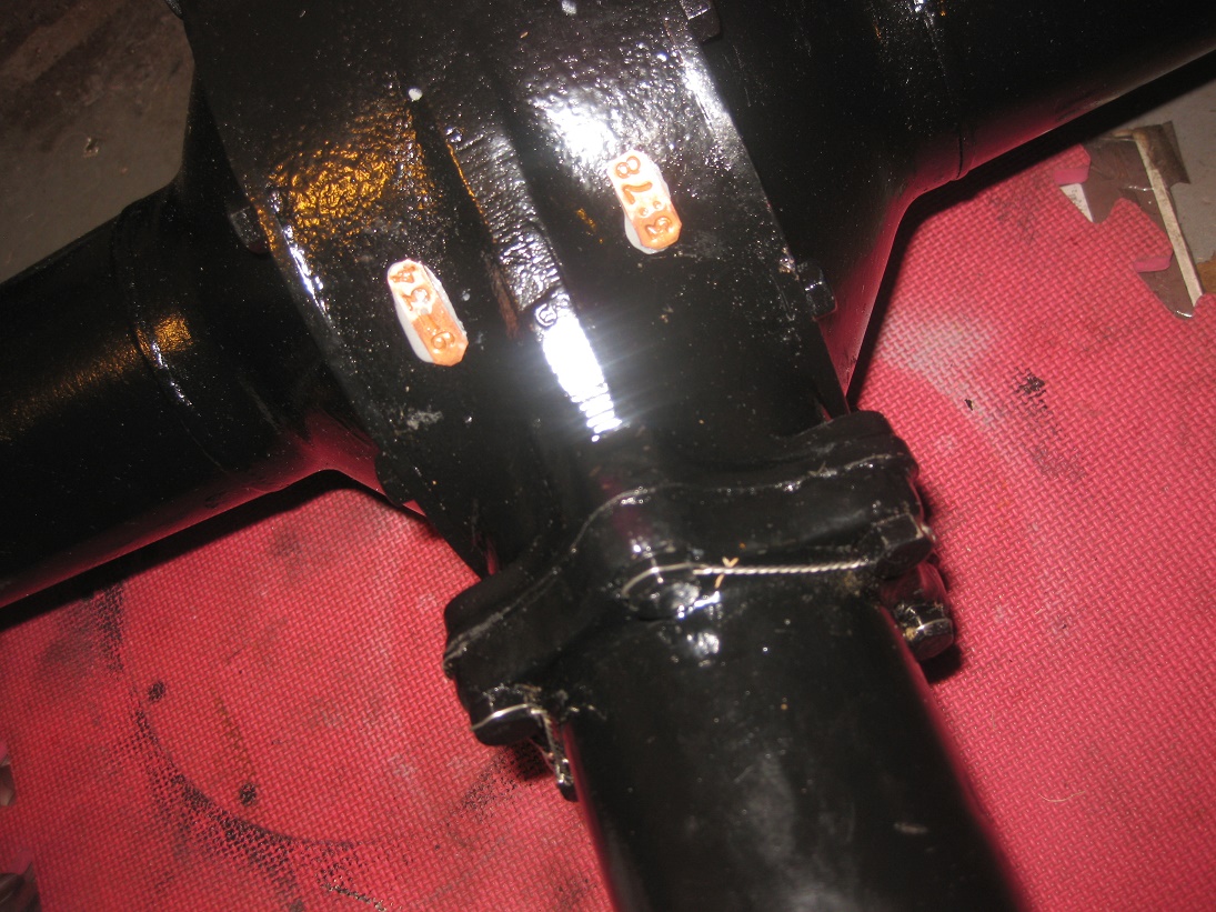

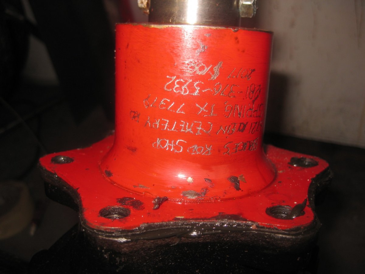

    Here's where you buy the torque tube seal. http://www.brucesrodshop.com/
    It will slide over the coupler pins if you use grease and first remove any burrs on the pins. You will also have to install a vent on one of the axle tubes when you use the torque tube seal. Originally, the rear "vented" thru the torque tube. So while you have the rear out replace the clam shell seal and the front bearing seal and inspect your torque tube center bearing,. I used this clamshell seal.

    IMG_0292b.jpg IMG_0294b.jpg IMG_0296b.jpg IMG_0305b.jpg IMG_0425b.jpg Gee, I didn't have that problem. That doesn't seem possible as I don't think the fitment of the speedo gear and that snap ring would be effected by the torque tube seal. The two aren't related. All that torque tube seal would do is move the torque tube forward a tiny bit due to thickness of the seal and gaskets. . Did you check and make sure the bearing and seal at the front of the drive shaft are "in all the way"?
