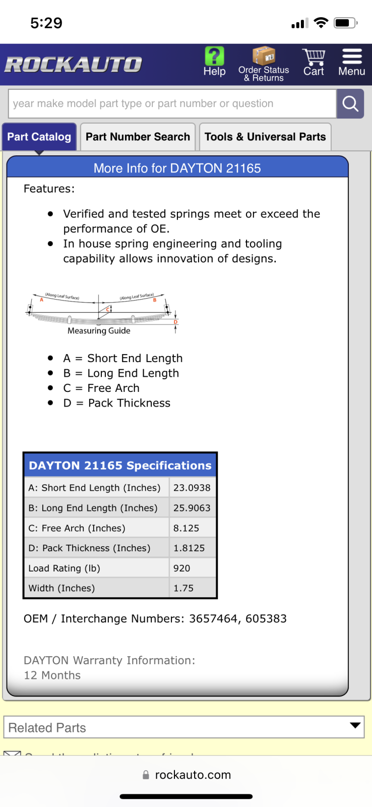

  12. When I did one I turned the leaf springs 180 degrees. Put the front towards the back.
