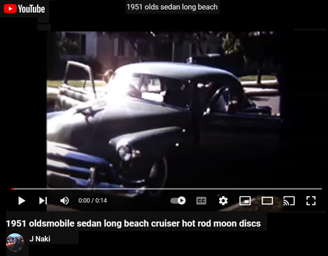

    I am not sure how you decided on a 2 inch drop for your front end. That seems like it is a common choice and we did hear other teens say the same thing a long time ago. So, yes, we lowered the coils 2 inches in front and it was cool looking, but hard to get out of our simple driveway onto the street without s****ing something.
    We actually used clamps to squeeze the coils approximately 2 inches in front. We were told that with the clamps, we could get a good idea of what it would look like. The drive was simple, but as soon as we got to a dip in the road, the clamps came off and the sedan was an odd angle car. But, at least we were able to see what and how much we could lower the sedan.
    My brother’s 51 Oldsmobile 2 door sedan was originally yellow and with the 2 inch drop, the profile on the level part of the front yard driveway was very cool. Very angular with the rear stock. But, be forewarned. It sounds nice, but, no so much when trying to drive down the street and then coming to an intersection with channels coming across the direction you are heading.
    We cut the coils and it was now low. So, low that the driveway took forever to back up without s****ing something. The drive down the street was ok. It felt a little stiff and not so forgiving. When we came to a cross street, the two water channels were an obstacle that had consequences. A normal slow speed straight ahead s****ed. An angular direction was necessary to complete the around the block trial run.
    Now, coming back up the driveway was another difficulty. The original clamps helped and my brother decided that cut coils 2 inches was fine for him. He was the driver/owner and told himself that care could be taken at every deep cross street intersection. So, it was done and now the yellow Oldsmobile was sitting on a lowered rake permanently.
    Jnaki
    It did look cool and the first time he came home and told me of his trial and error entry into the very steep driveway of the local Bixby Knolls Drive-In Parking Lot was a cuckoo event. At the first try, the bumper s****ed. So, an angular method worked somewhat to at least get into the sidewalk area. But, as he kept going, something s****ed again. Upon leaving, the exit was worst and he told me it was awful. No amount of slow speed was NOT going to keep something from not s****ing.
    What did it? Well, it could have been 4 teenage boys inside making the whole car lower than what it was in our driveway. He lived with it for a week or so. But, he also had the neighborhood muffler guy put on a set of side lakes pipes under the door. Now, that was low and lower. The pipes were hooked up to the down tube from the stock header connection.
    Note:
    The final year of driving at***ude stance was 2 in the back and 1 in the front. He also sold the side lakes pipes and had the muffler guy do the cutting and that helped with the complete lowering stance. He had the Oldsmobile painted a Lime Green and then sold it to our friend as is, in the fall of 1957.
