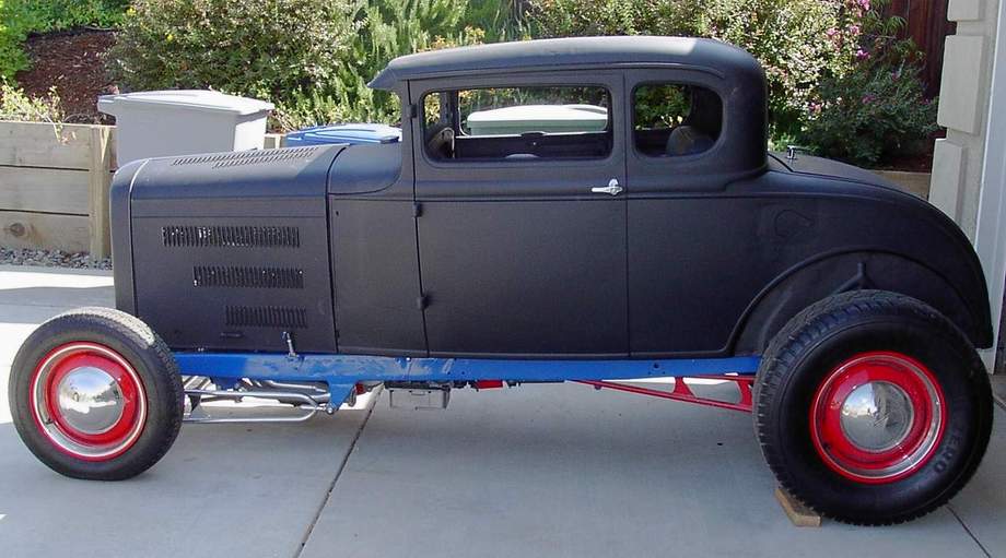

  15. A Chopped Coupe
    Joined: Mar 2, 2004
    Posts: 1,133
    A Chopped Coupe
    Really can't add very much because it has been covered.
    I have a 4" dropped axle with reverse eyes in the front (actually took out three leafs), Z'd
    the rear 3" (just put the bottom of the frame on the top like the Tardel Book suggests) and
    used a reverse eye rear spring minus 3 leafs.
    The picture of the Coupe in bear metal is with the ch***is fully loaded, and the picture in black primer is with the ch***is unloaded.
