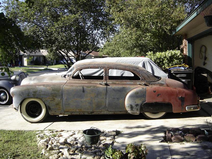

  27. [​IMG]
    this is from a couple of years ago. the car now has taller bias plies on it. this was with a 215 70 15 radial.

    PR51
    LOL... man, I have a pic of your car on my computer... I found it browsing a while back and saved it to show my girl... I told my girl it looks alot like what I had in mind for our car.
    What did you do to drop the front?
    Looking Good and I like the drop on it.
    thanks bro,
    Larry
  29. the front has 2" dropped uprights
