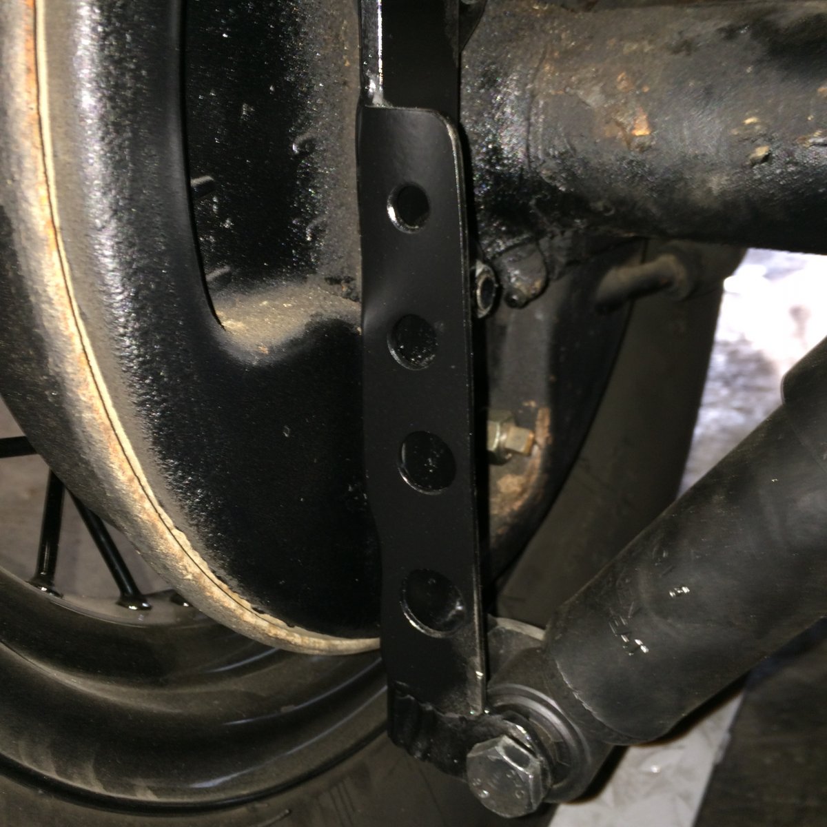

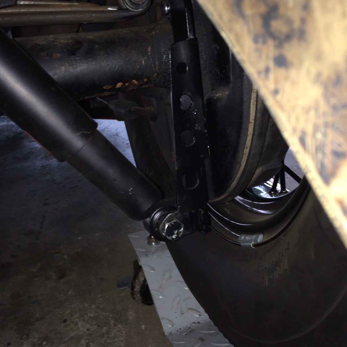

    What shock did you use? I am looking to do the same thing to mine. It has some original type shocks and they do not seem to be working that great.
  2. Ron Brown
    Joined: Jul 6, 2015
    Posts: 1,766
    Ron Brown
    front and rear are mid 60s VW beetle. the eyes are metric so you need to use metric bolts thru the eyes....they are cheap and work well and the length was nearly perfect
