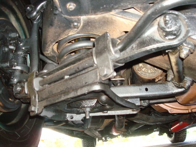

  14. deluxester
    Joined: Mar 14, 2004
    Posts: 478
    deluxester
    I found a photo of this A frame assembly from a car for sale on Ebay. Is this what you are describing?

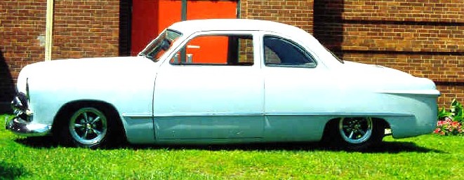

  18. Heated coils will slowly collapse on themselves over time. I flipped the spindles [and moved them side to side] and cut a coil and a half. Used 14 inch wheels, cut the bumpstops down to about 1/4 inch and thought really low thoughts.....it rode fine but the crossmember would sometimes hit the ground on dips..

    UnIOnViLLEHauNT
    Damn Rocky that thing was LOWWW. Would have loved to see that with 15" steels and wide whites to really do comparison on how low it was....but its hard to make 14's look low. I had them on a shoebox and the car looked a mile high no matter what I did.

  25. brewsir
    Joined: Mar 4, 2001
    Posts: 3,278
    brewsir
    yes thats what I was talking about....I can't say how much drop you get for sure (it's been a long time since my buddy did his and now it's bagged) but I think it drops 2-3 inches...if not you can still cut a loop off.
