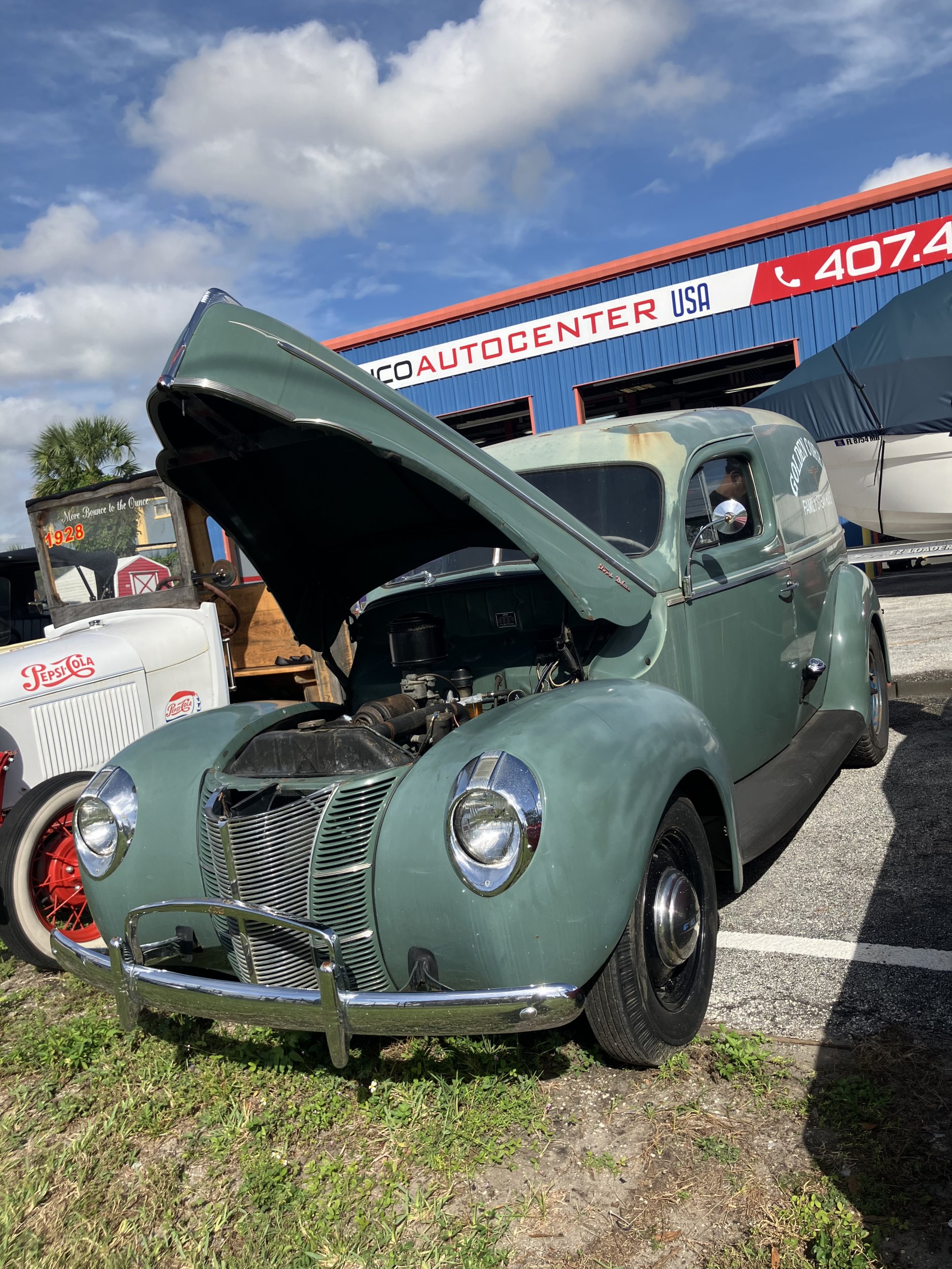

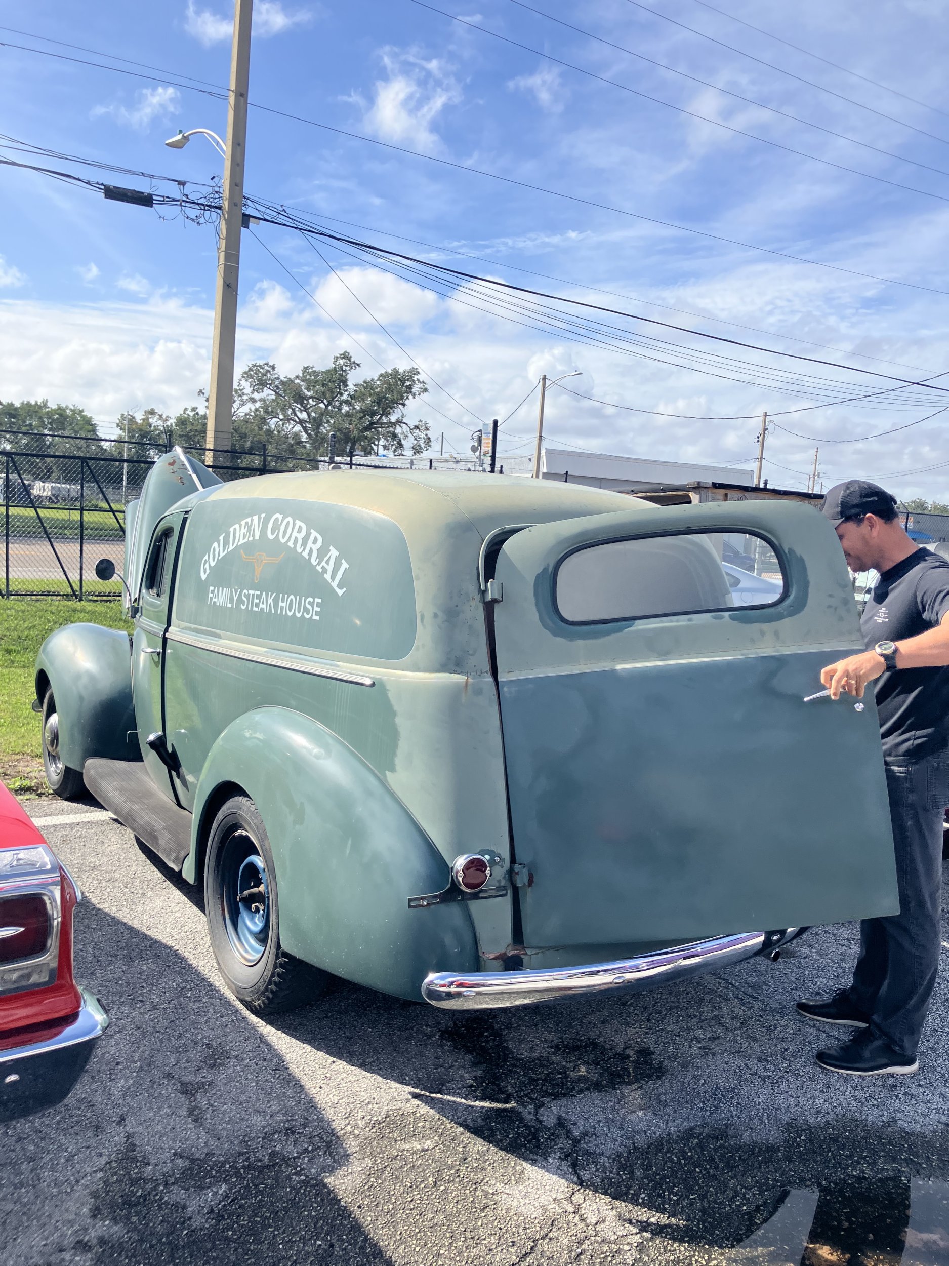

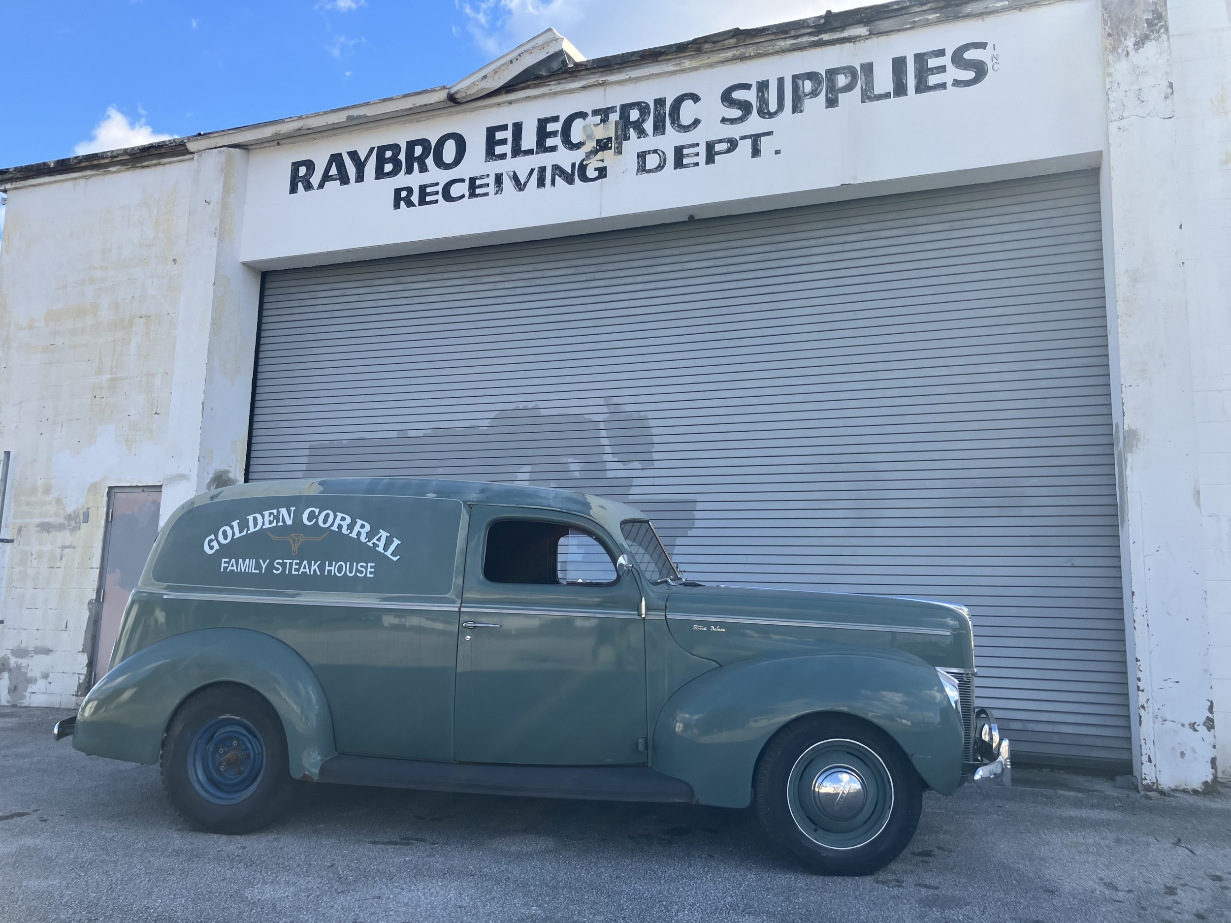

    IMG_3350.jpeg IMG_3353.jpeg IMG_3350.jpeg IMG_3353.jpeg IMG_3350.jpeg The vehicle in question. A sedan delivery, original V8, runs and drives great, zero rust.
