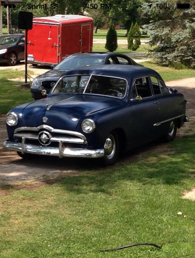

  14. flatheadpete
    Joined: Oct 29, 2003
    Posts: 10,774
    flatheadpete
    from Burton, MI
    Best pic I have access to right now.

  16. Brentphx
    Joined: Aug 12, 2014
    Posts: 256
    Brentphx
    Nice stance... Thx, the visual reference helps.

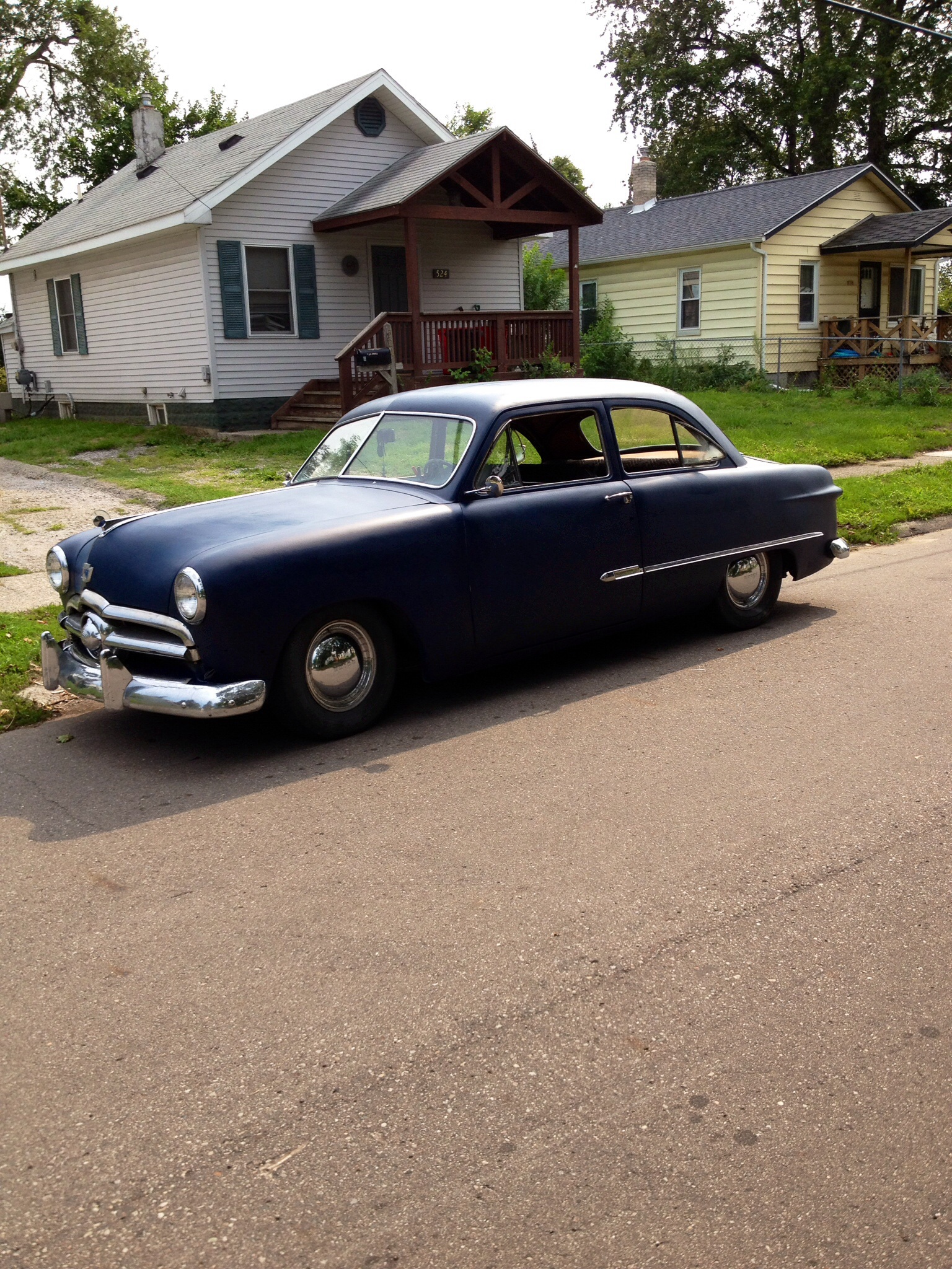

  19. Slow 50
    Joined: Jun 3, 2013
    Posts: 16
    Slow 50
    from Dallas, TX
    This is what it looks like with:
    2.5" Drop Spindles, 1.0" Drop Springs
    4.0" De-arched Leaf Springs, 1.0" Drop Leaf Spring hangers
    I'm going to install a 1" or 2" block in the rear. The rear is 2" higher than the front when measuring the bottom of the rockers to the concrete (~6" high upfront, ~8" high in rear). I'll keep the pics coming upon completion. Thanks

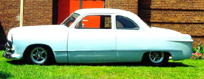

  21. vwdave30
    Joined: Nov 21, 2009
    Posts: 457
    vwdave30
    I think i have the twin to your car i got the same set up on the back here it is before i added a 3 inch block and after
