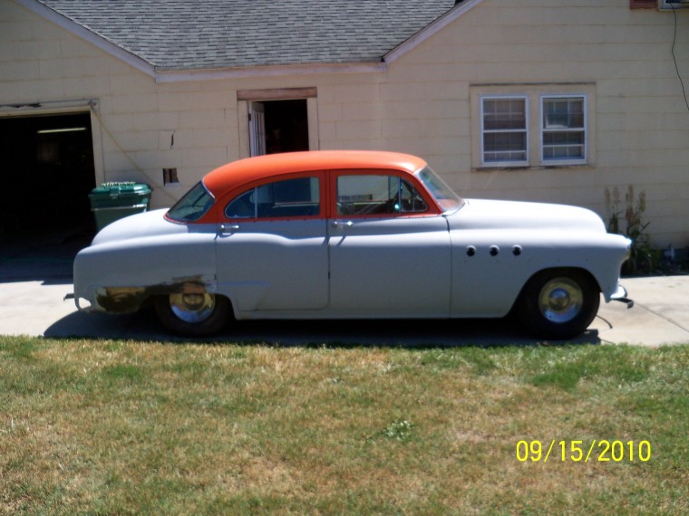

  19. Take a torch and collapse a couple rounds. Took us about 2 minutes per coil. After all it is only temporary.
  20. Like this. Took less than ten minutes. Front and rear. Not sitting in the weeds, but a hell of a lot better than before.

    special sam...personally i think cooked coils are unsafe so i wont do it but i agree it will lower ur car to the height you want.
