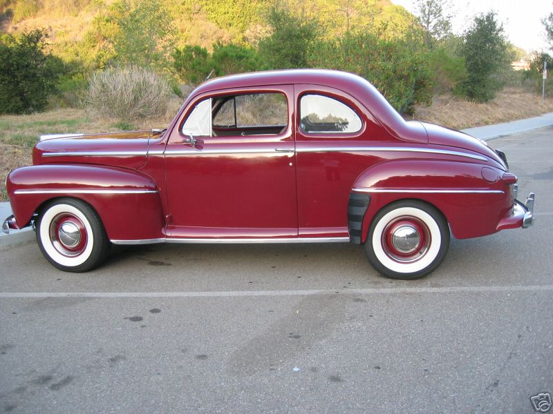

    I mounted my new front shackles today. Centre to centre the holes are 5 inches.
    The 1" is 6.125" This gives me exactly 2.5 inches of drop which may not seem like a lot but when compared to stock is a nice improvement. Tomorrow I'll install the rears now that I know it didnt effect the steering.
    There's no clearance issues, no modifications to wishones or anything else and it did not effect the steering in anyway. I can stick with my stock 6.00 16's too.
    ( of course the stock picture is pointed down the slope of the cement but check out the white wall height.)

    rear shackles installed. End of modifications.
    Stock
    2.5 inch drop
    There was room to easily gone to 3.5 inches of drop before wishbone and tire issues would have been addressed.
