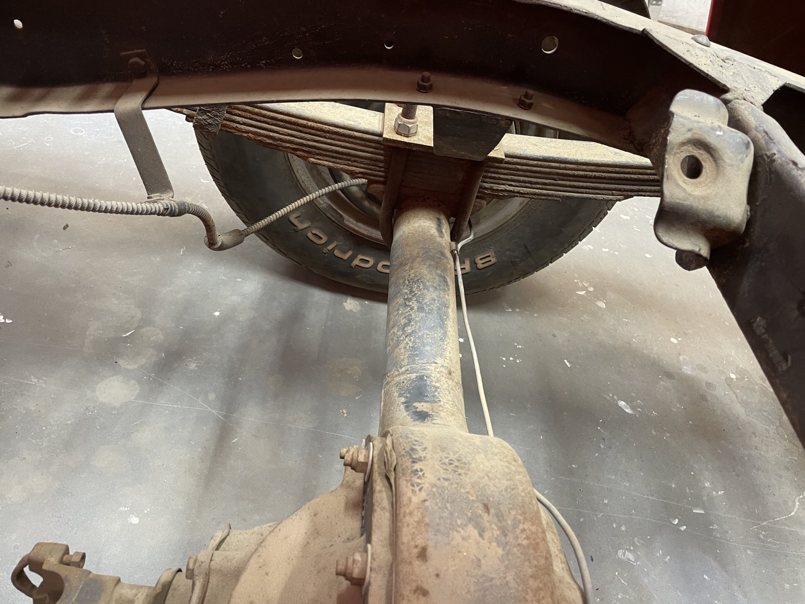

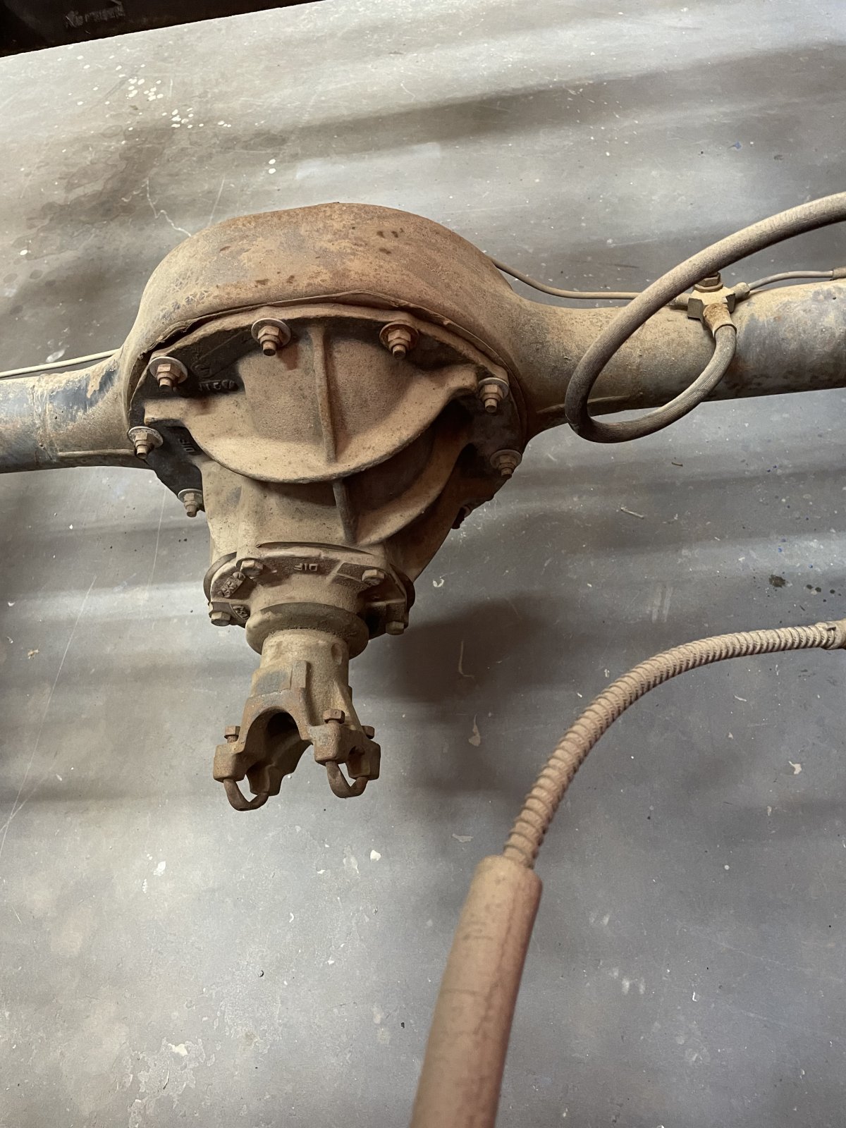

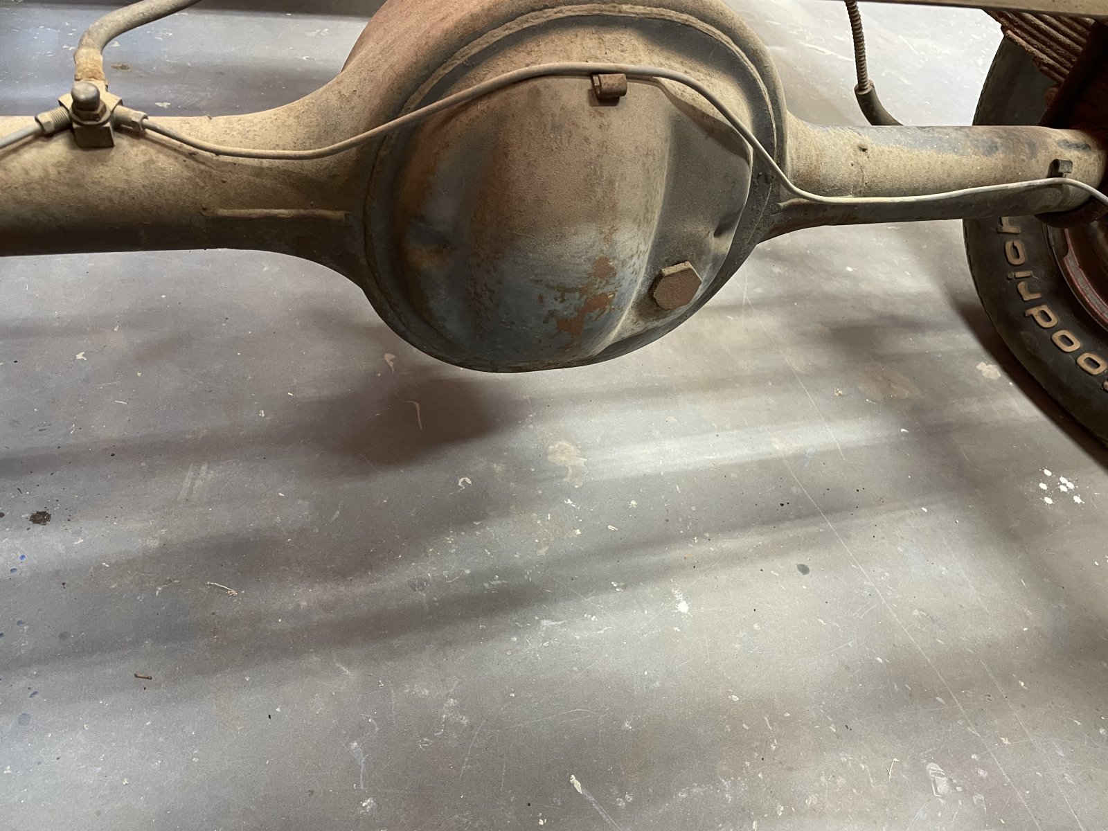

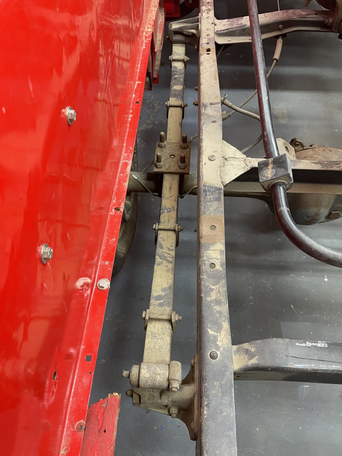

    So, I have been looking at the 1956 F100 project I just drug home. It has a 9” of unknown origin.
    F4C7FAA7-4D50-4B3B-A7F4-EC34DD080B92.jpeg BE114483-7FF7-46F9-A845-66302886ACCD.jpeg
    If anyone has any idea what this rear may have come out of, speak up. I am guessing later big car. I haven’t had a chance to throw a tape on it yet.
    It has a leaf pack of 10. Looks like someone wanted to do some severe logging. The leaf pack is on top of the rear end also. Plenty of ground clearance.
    1E6E0944-F8B3-41C9-9A54-56CF18B7CDF0.jpeg 6B061025-5CAF-4A70-AAC3-4BF14F67BC19.jpeg
    My thinking is to remove every other leaf and maybe carry a total of 5. Flip the axle, and maybe add lowering shackles. Trying to do this without blocks if possible.
    Someone raised the front shackle bracket. Not sure why. The spring isn’t centered from the factory, which seems odd to me.
    It appears to have the stock shackles.
    What combination worked for you?

    Might just flip it first and keep the leaves to haul loads better. Flipping it is typically around a 6” drop in itself.

    I used lowering shackles from Mid-Fifties along with moving the front hanger to the top of the frame rail. I remove all but 5 leaves, cleaned with liners. It sat good, as in my avatar, and rode well. Never carried much weight though. I also Notches the frame. Not sure I wold move the axle to above the springs.

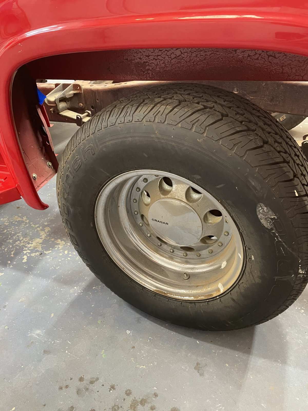

    Oh, and those are some cool wheels... :rolleyes:

    They are for sale if you have a 78 Cutlass….

    Had some of those Cragars on a 40 coupe in 1986.

    The type of bearing ends and sizes of brakes will get you some information as to what it started under. The flat washers on the center section shows that it has been apart before.

    Yeah and the tag is missing….eventually I’ll tear into it. It’s got some sketchy cobbled up welds on the saddles.

  11. You need taller tires, I had 215/85 lt 16 on my '54 panel.
    The go to 9" for those were F100 from 67-72 I think, just had to move the pads. What's the bolt pattern on it and are you going with a stock front end or the one that was pictured with it.

    Oh, those tires are just rollers. I’ll be waiting to buy my tires til It’s almost ready to drive.

    On my Effie, I reversed the spring eyes and took out a bunch of leaves. Having about 5-6 left sounds about right.
    My axle is still under the springs and with this set up it sits pretty good in the rear. It’s really low in the front so there is a rake. It has 235/75/15’s and fills up the opening. If I went any lower in the rear I’d have to notch the frame for clearance. I like the thought of possibly 2” lower on mine and I would use longer shackles if I do it, and notch the frame.
    I think flipping the rear end would make it really low in the rear and I’m not after that look for my truck.
    What you have there for U bolts is not stock F100. The F100 U bolts are rectangular over the spring and the threads point down allowing a plate to bolt up under the rear end that has the lower shock mount incorporated in it.

    Yeah the Dana rear is gone and the u bolts are all 1/2” in diameter. There has been a lot of modifications to the frame and the suspension. The leaf springs are 2” wide, so those are probably original.

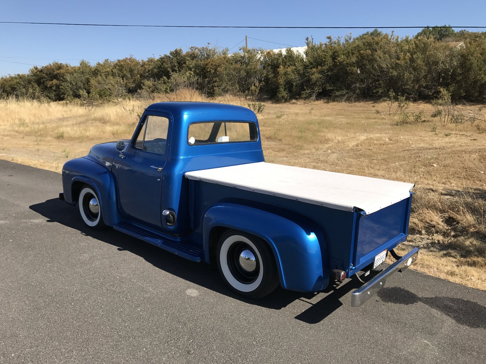

  16. Here's my old panel.
    Roothawg likes this.

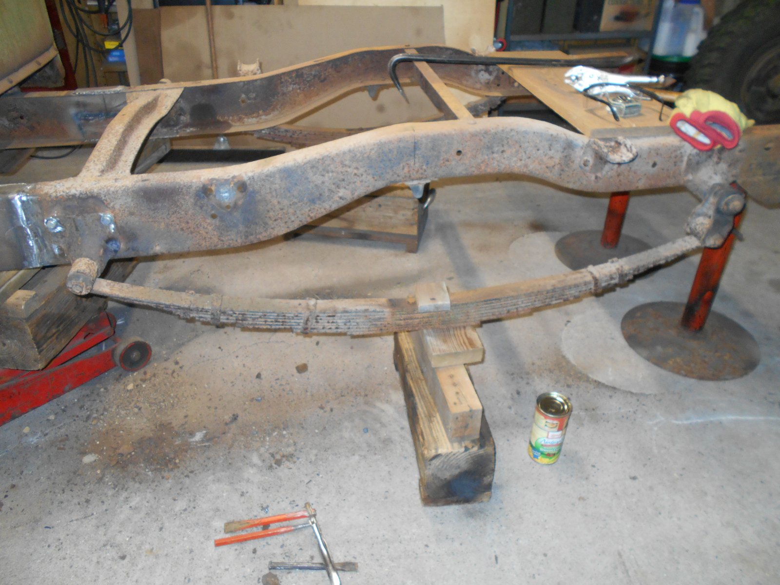

    here's an idea that worked on my 54 International pickup;...knocked the rivits out of the front spring hanger,(or the rear hanger, don't matter) flipped the shackles so they hang down instead of up, remount front hanger with grade 8 bolts, then you can mount the rearend on top of the springs, usually without DSCN7753.JPG a C notch in the frame and use a lowering block to suit your needs,... DSCN7751.JPG

    Looks like same rear I got for my 52 merc pickup it came out of a 1966 ford f1
