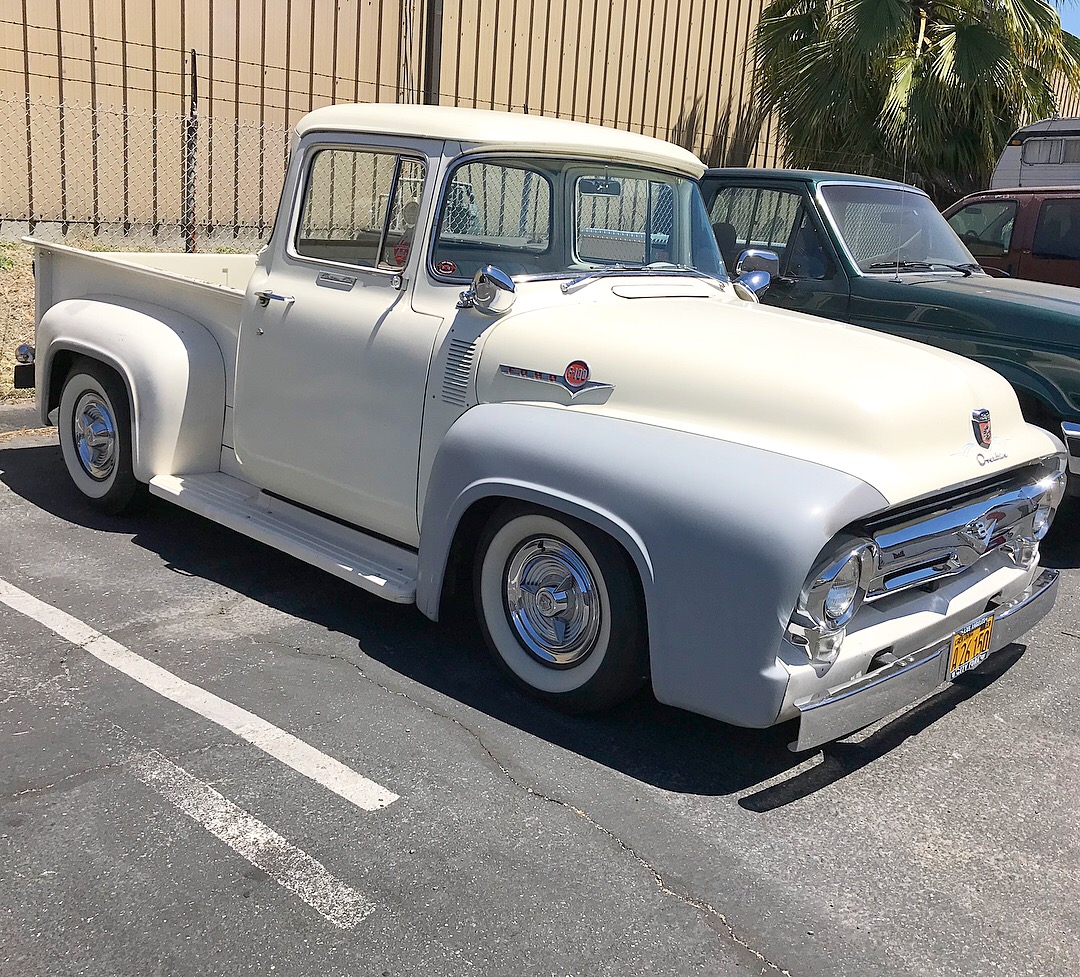

  18. To me, this sits perfect.....
    Landmule, rod1, bchctybob and 6 others like this.

    Everything about that truck is perfect, down to the right hubcaps!

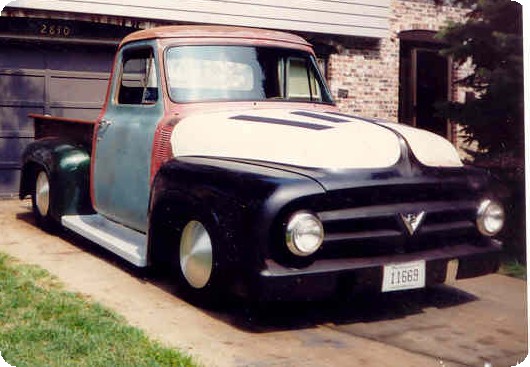

    Before;)
    Roothawg likes this.
  22. Since @Nailhead Jason asked, I thought I'd add the unique things that I did to lower the back end of my 54 F100 without putting the axle on top of the springs. I swapped the Dana 44 for a 9 inch, reversed the main leaf eyes, removed 2 or 3 short leaves from the spring pack, added extended rear shackles, flipped the front hangers and modified and moved the rear hangers up two inches. I can still move the front hanger up to the top of the frame, which I intend to do. This is how the truck currently sits without the engine, trans, interior, etc. – it's basically a shell.

  23. D-russ, do those rear shackles clear the bed floor?
    I think yer truck sits just rite in tha photo above., I like em with a bit of a forwad rake, mite sit diffrent when all weight is added.
    Roothawg, guthriesmith and D-Russ like this.
  24. Good question – with the 2 inch mod to the rear hanger, the stock shackle still cleared the bed floor, but with the three inch longer shackles, the top of the shackle/spring pokes through the bed floor an inch or so. My plan is to make a simple flanged box from sheet metal to cover each side.
    About a week ago I dropped the engine and trans in but I haven't rolled it outside to check the stance. But according to my measurements, the front end dropped another 1-1/4 inches. Currently the tires are the same size front and rear at about 27 inches tall, but I intend to run a 29 inch tire in the rear.
    Currently the front suspension has a 3 inch drop axle, reversed eye main leafs, 2 or 3 shorter leaves removed, and the rear hanger has been sectioned 2 inches. I'm considering raising the front shackle hanger the same 2 inches with a small Z in the frame, and I can swap in a 4 inch drop axle if needed.
