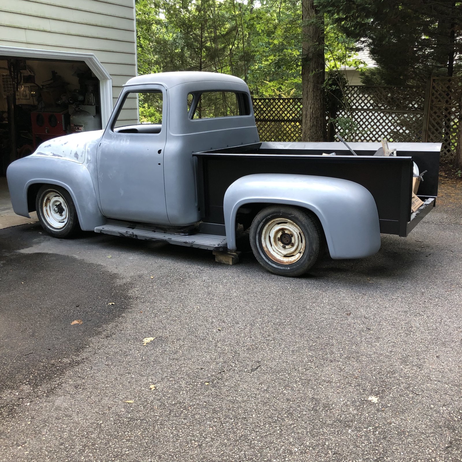

    Don't know yet because I haven't measured, but I can always add wedge shims between the axle and springs if needed.

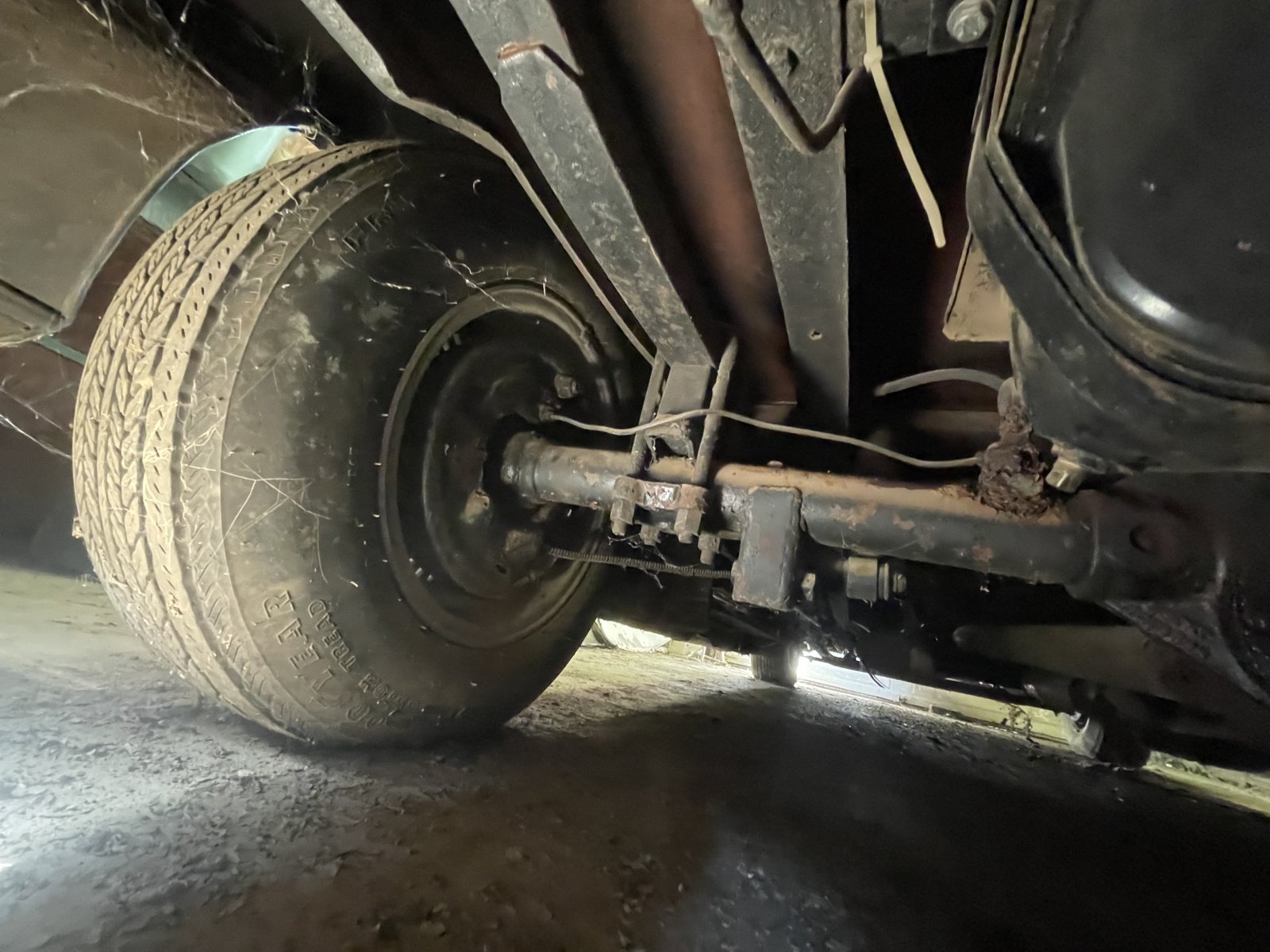

    i got identical rear it is from 66 ford ranger

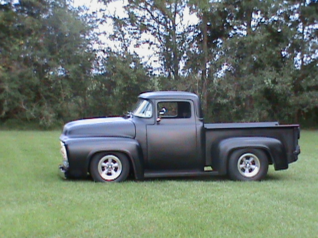

    Here is mine from a few years ago. Nine inch with leaves removed and small notch.
    1917AAD8-79C3-441A-905A-2EE2ECC67C9C.jpeg 90890AF3-3B5A-40DF-8330-708EE481BF7B.jpeg
  8. De-arch the **** out of the springs then use blocks to raise it back up after a 6 inch channel.
