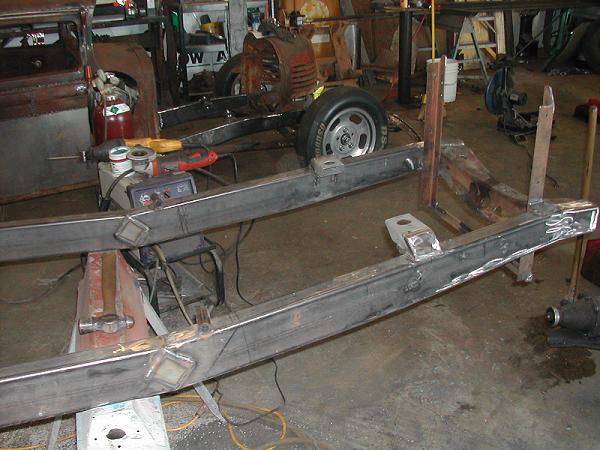

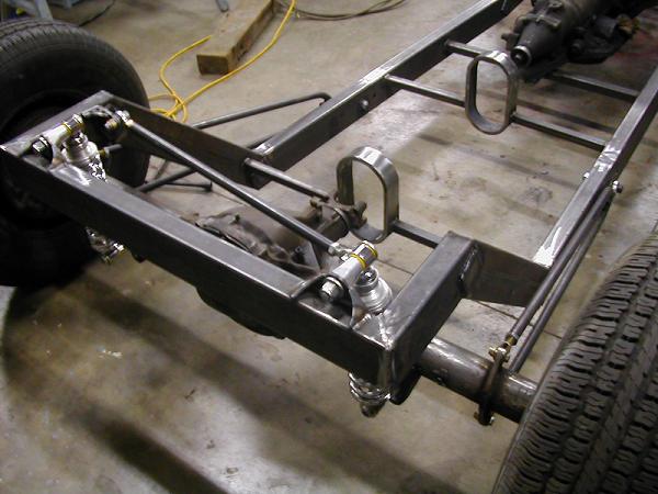

    When I ran out of daylight I decided to strip the lunar lander down and work on the frame. I finish welded the frame and put sleeves in the frame rails and wishbones where the bolts went through. I also gusseted the shit out of all the points where the frame bent just in case. This frame started as 2 12 foot chunks of 2X4 square tube.

    That Monster garage episode got a lot of people riled up to build a "Rat Rod" I received several phone calls from people who would normally not talk to me wanting to buy something. Matt even got motivated enough to come out and do some work on the Tommi Gunn. Here is his frame z and an overall shot of the "project area"

    So you have the wishbones mounted on top of the frame? How much does the frame kick up ahead of the bone mounts?

    Nice work. How much of a "bow" do you have in the frame of the LL? Interesting way to drop the nose- I've never seen that done before.

    That would be the famous Bob Bleed frame sweep. I took out 1/2 inch and it dropped the frame 5 or 6 inches.

  11. Damn that looks good! You gotta let me know next time you guys get together and I'll come over and lend a hand...or at least some beer:D

    Hey Aaron, the chassie looks sweet,nice work!! love the driveshaft loops. Did you make them? Good to hear the dog ok, it would get lonely on them late night car jams:D

    The wishbones are mounted on top of the frame rails. It leans the axle back 7 degrees.
