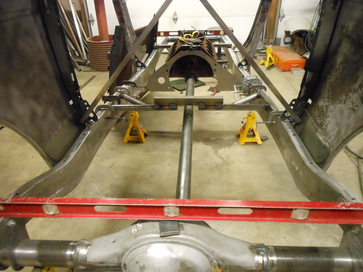

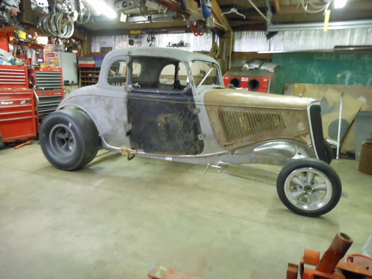

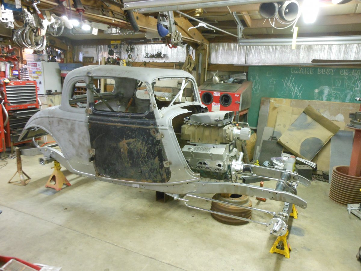

    Once the body was halfway mounted, it's almost mandatory to do a quick mockup.
    The rear wheels are 16x8.5 americans that mean a lot to us. My dad had these wheels in 1969 on his high school 39 chevy coupe. He sold it and hasn't been able to find it since. Who would figure 40 years later @t_wood_08 would buy these wheels and low and behold on the back was my dads named engraved into them. My dad bought them.

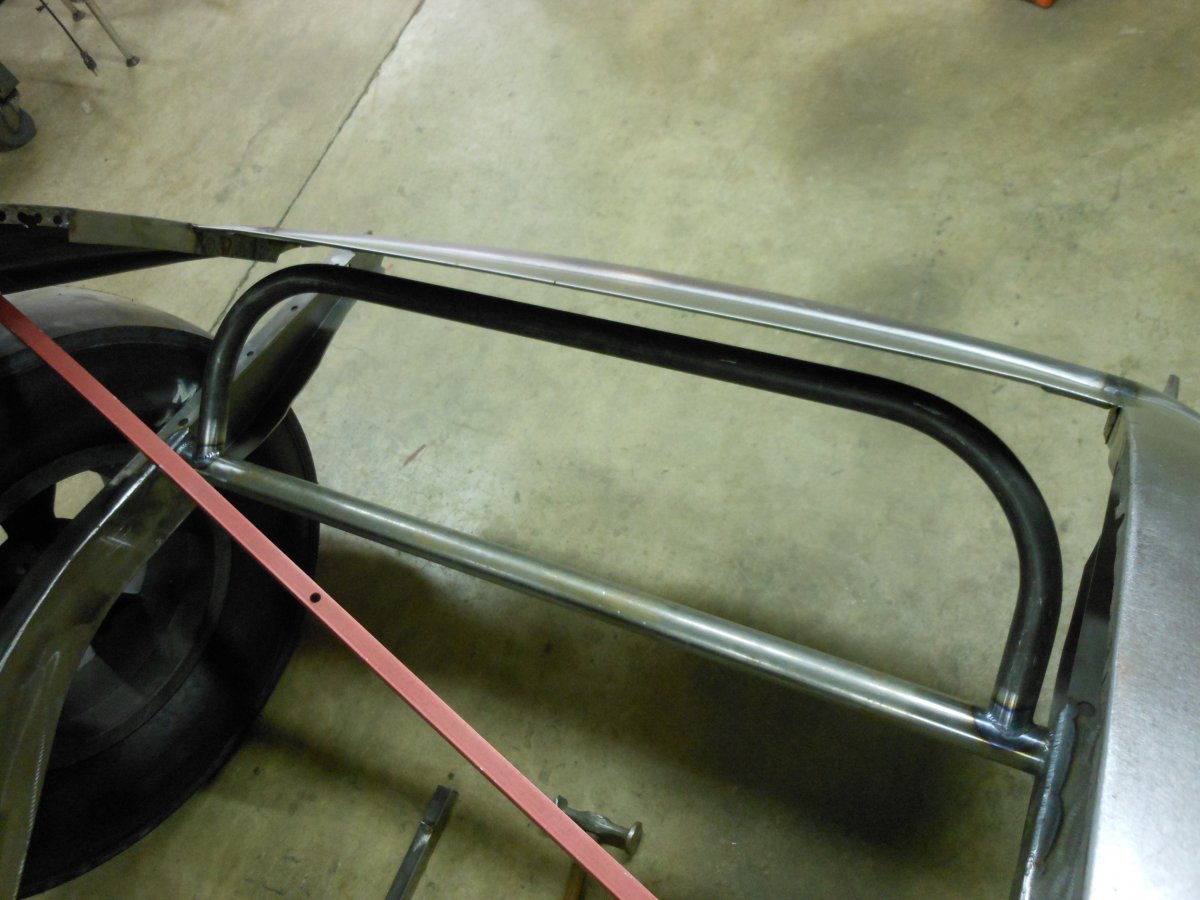

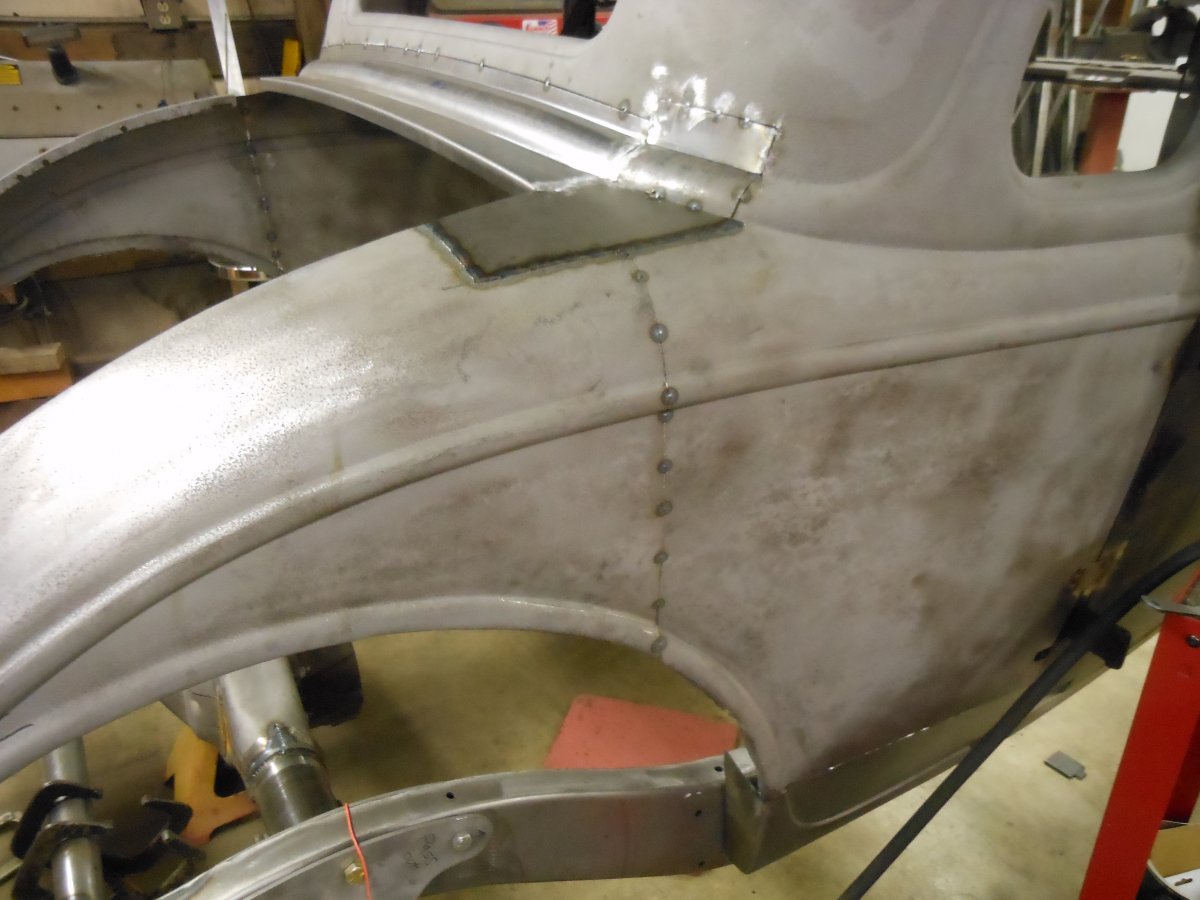

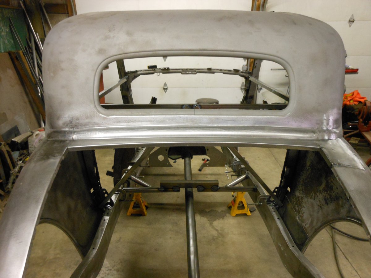

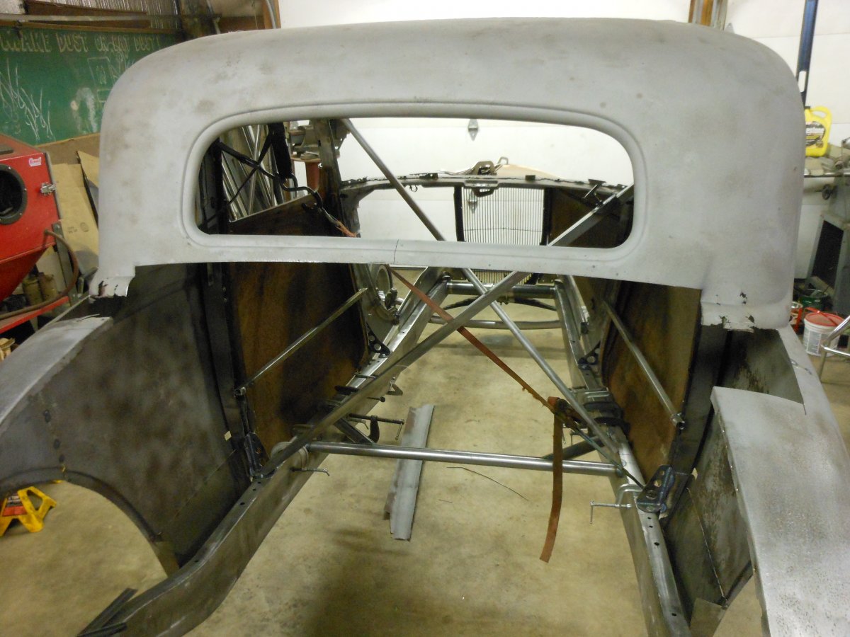

    The rear body mount serves a dual purpose as the mount and parachute mount. So we bent up a simple hoop that would be used as both. This is when we started noticing the rear of the body wasn't quite right, so we didn't finish off the mount.

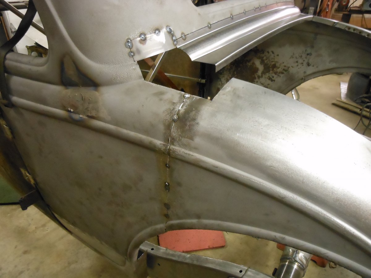

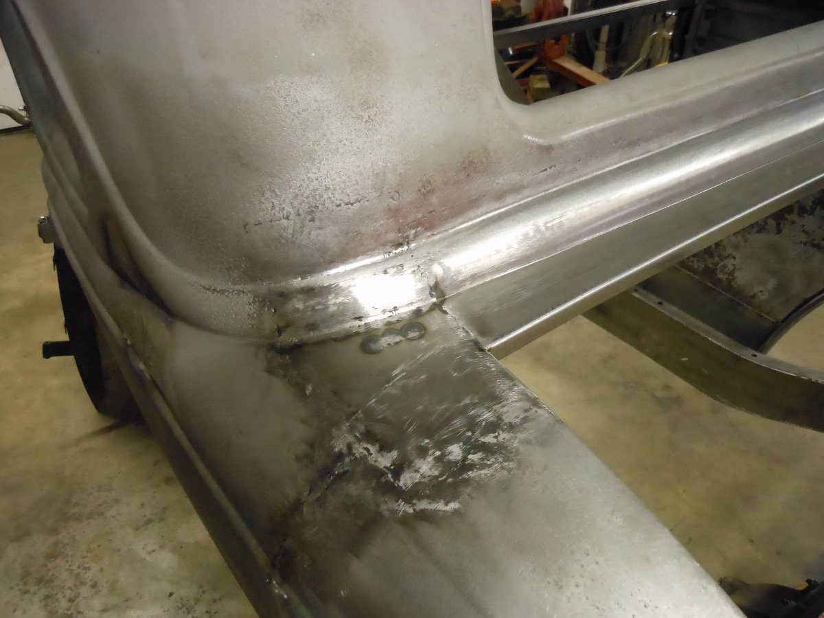

    It turns out the hamburger repair on the drivers quarter made it about 3/4" shorter than the p***enger side. I didn't notice it doing the quarter tips since you could twist and pull the back of the body every which way, since you know... it was a total pile of ****.
    Since it would be a pain in the *** to make a patch strip, we decided to shorten the p*** quarter the 3/4". In the end it worked out perfectly, it takes out some of the sweep of the back of the wheelwells that you see on all fenderless 34's. So now its a bobbed 34.

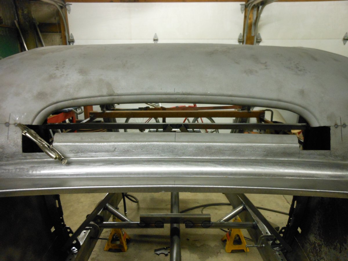

    This was perfect timing to repair the hot dog neck on the back of the body (picture the back of fat guys neck looking up) with a new above decklid panel from SAR. My dad formed the patches for the top of the quarters and neck on both sides of the body. Now the whole lower body is square and true and we could finalize the body/chute mount.

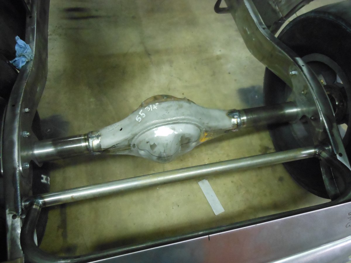

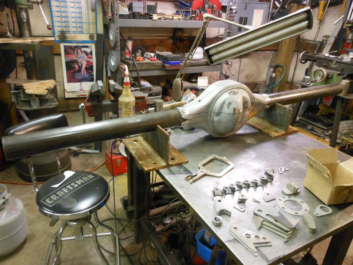

    The rearend in the car is a **** cheek 9" with heavy wall tubes and will be back braced. The center section is a nodular strange unit with 3.89 gears, spool, 35 spline axles and strange disc brakes. It is solid mounted.

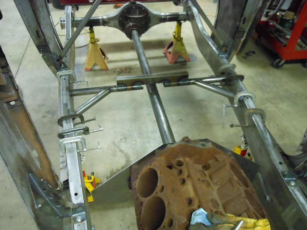

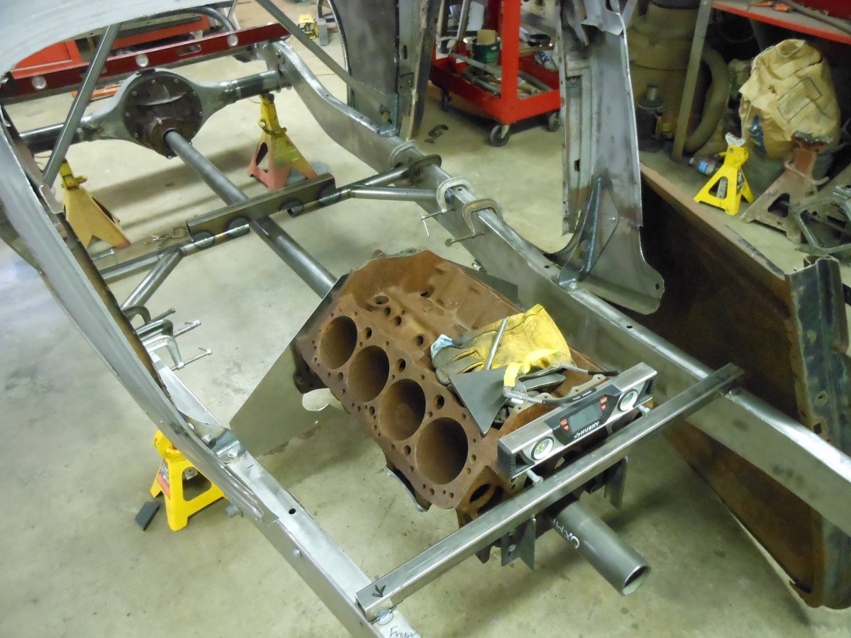

    The engine for the car is my dads @Lytles Garage. It was destined to go in a AWB 65 comet he was building, and ended up selling it to build this car. It's a 406 cu in SBC with aDart block, Brodix heads, TD shaft rockers, Isky cam, MSD 20 amp front drive mag, Cola crank , Manley rods, 14-71 magnesium Blower, magnesium Enderle square bird injector. It will run on alcohol.
    We put the engine in a few different locations trying to figure out if we wanted it to stick through the hood or not. We ended up putting it in low and far enough back that it all fits under the uncut hood. Since everything is solid mounted and it will have a solid funny car style driveshaft the alignment was critical.

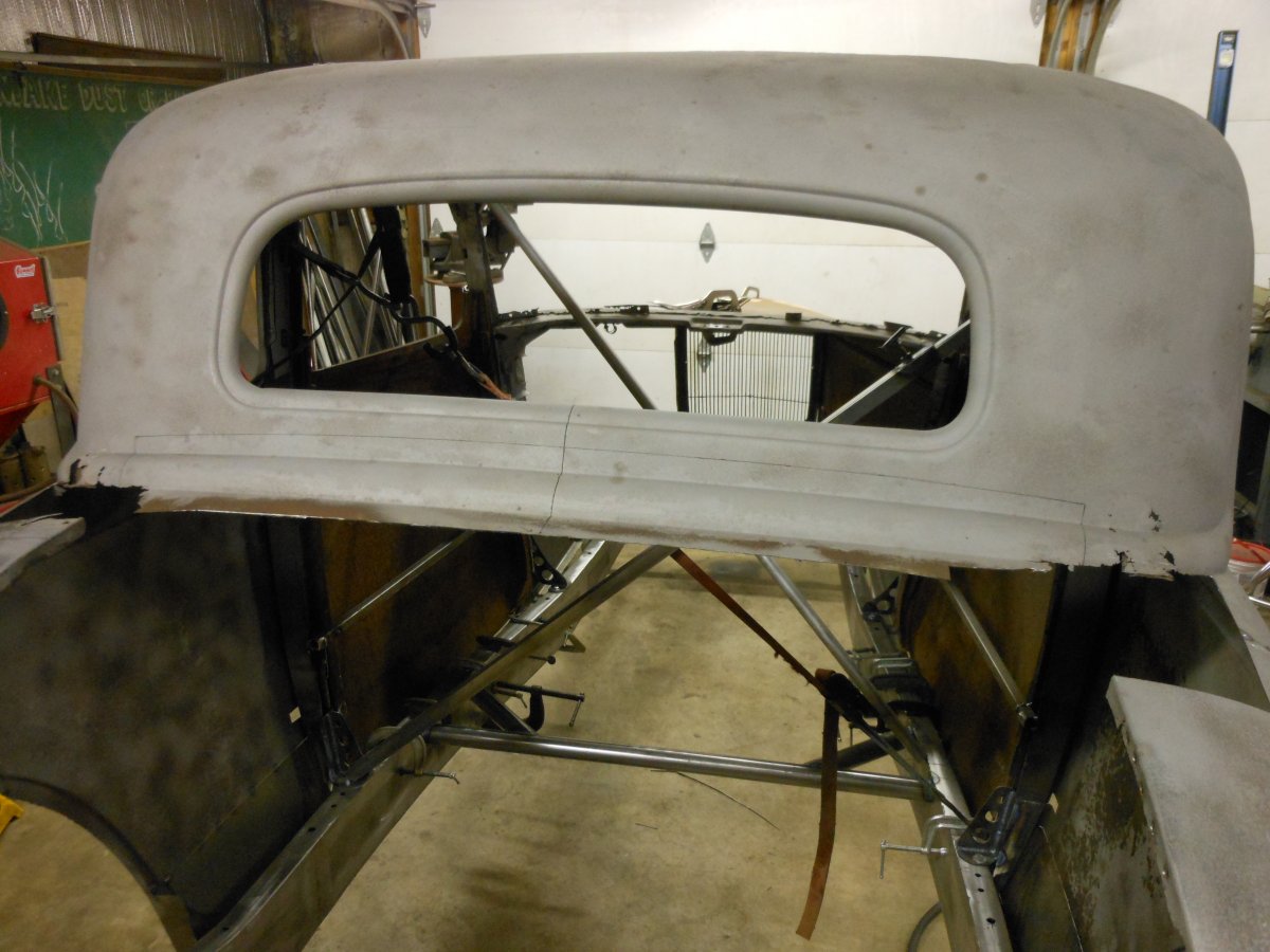

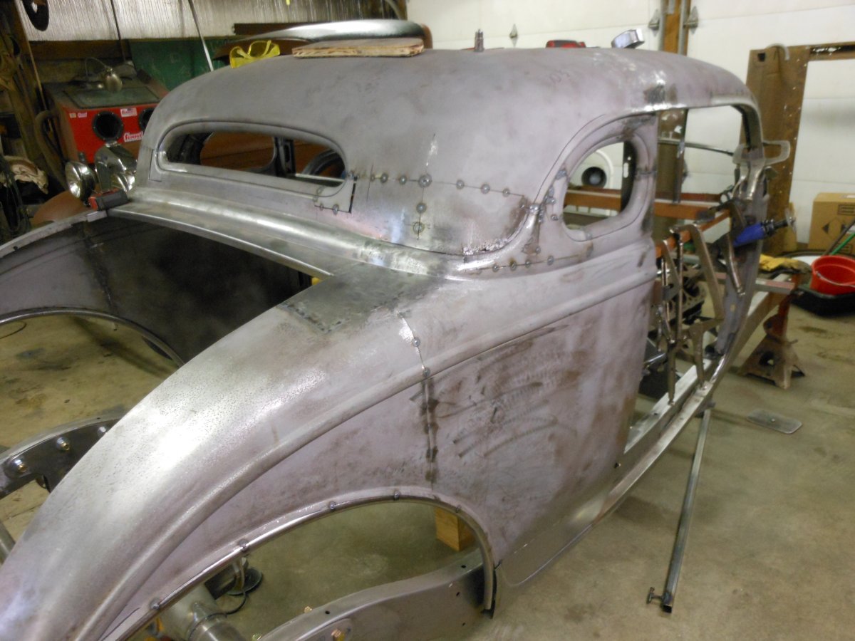

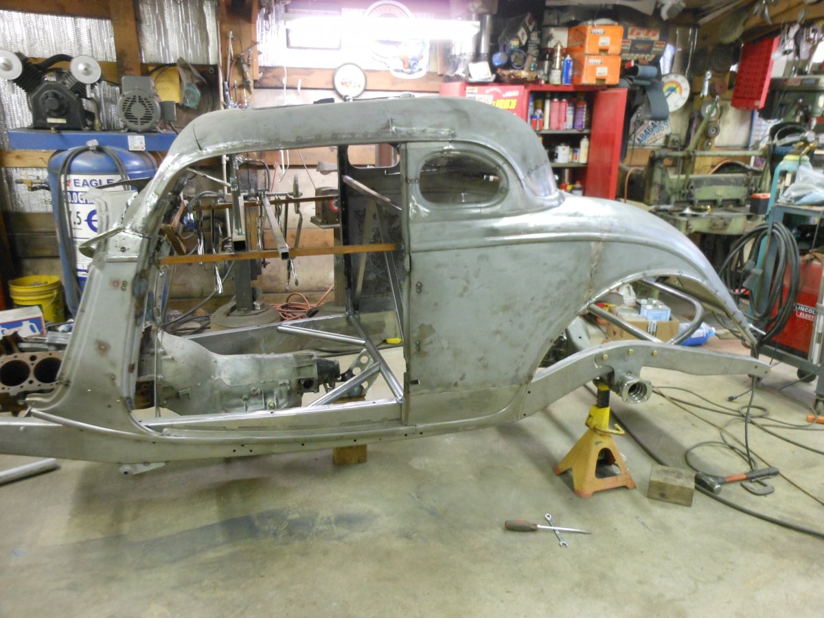

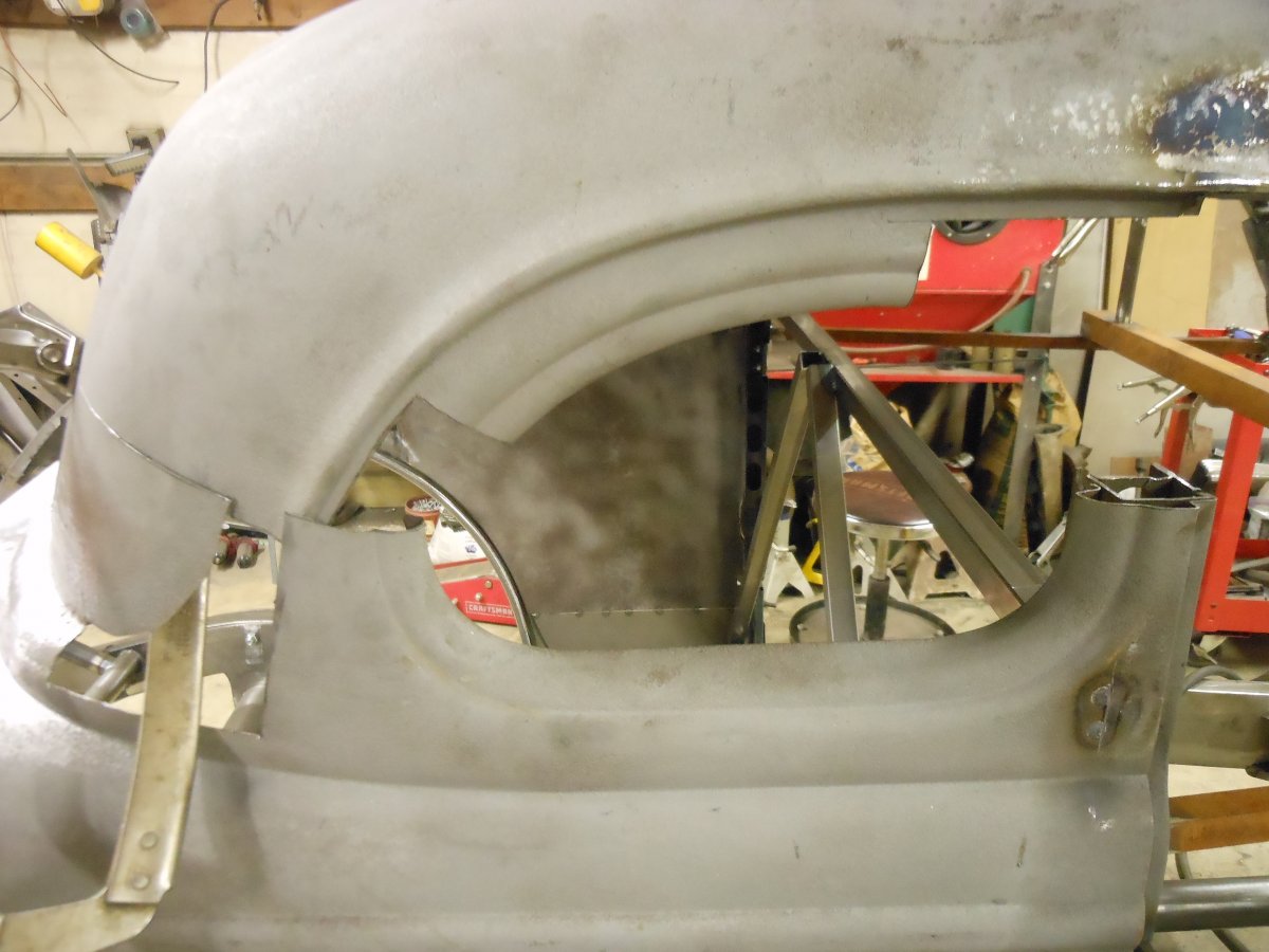

    It was time to make it into the mean ***** that it was meant to be. After some deliberating on how much to take out, we came to a final number of 5" out of the back. The front came out to be somewhere in the neighborhood of 5 1/2" with the cowl cut and pillars leaned back.

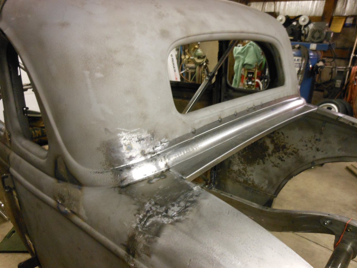

    When we got the coupe it looked like it had spent some time on its lid. It was smashed and squeezed and pretty messed up. At one point it had an insert that was leaded in, I melted out about 10lbs of it around the tack strip. At some point it had half a drivers cowl and a pillar from a 34 spliced on, which we're guessing happened the same time as the quarter replacement.
    The drip rails on both sides were really messed up. My dad @Lytles Garage made up some tooling to form and make the drip rails for each side. He made the rails for both sides. The drip rails get pretty messed up when you slice the top to lean the pillars forward. This allowed us to dial in the sweep and angle transition from the pillar to the roof, and it makes the profile of the angle chop very evident from the side view.

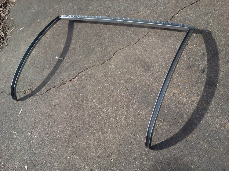

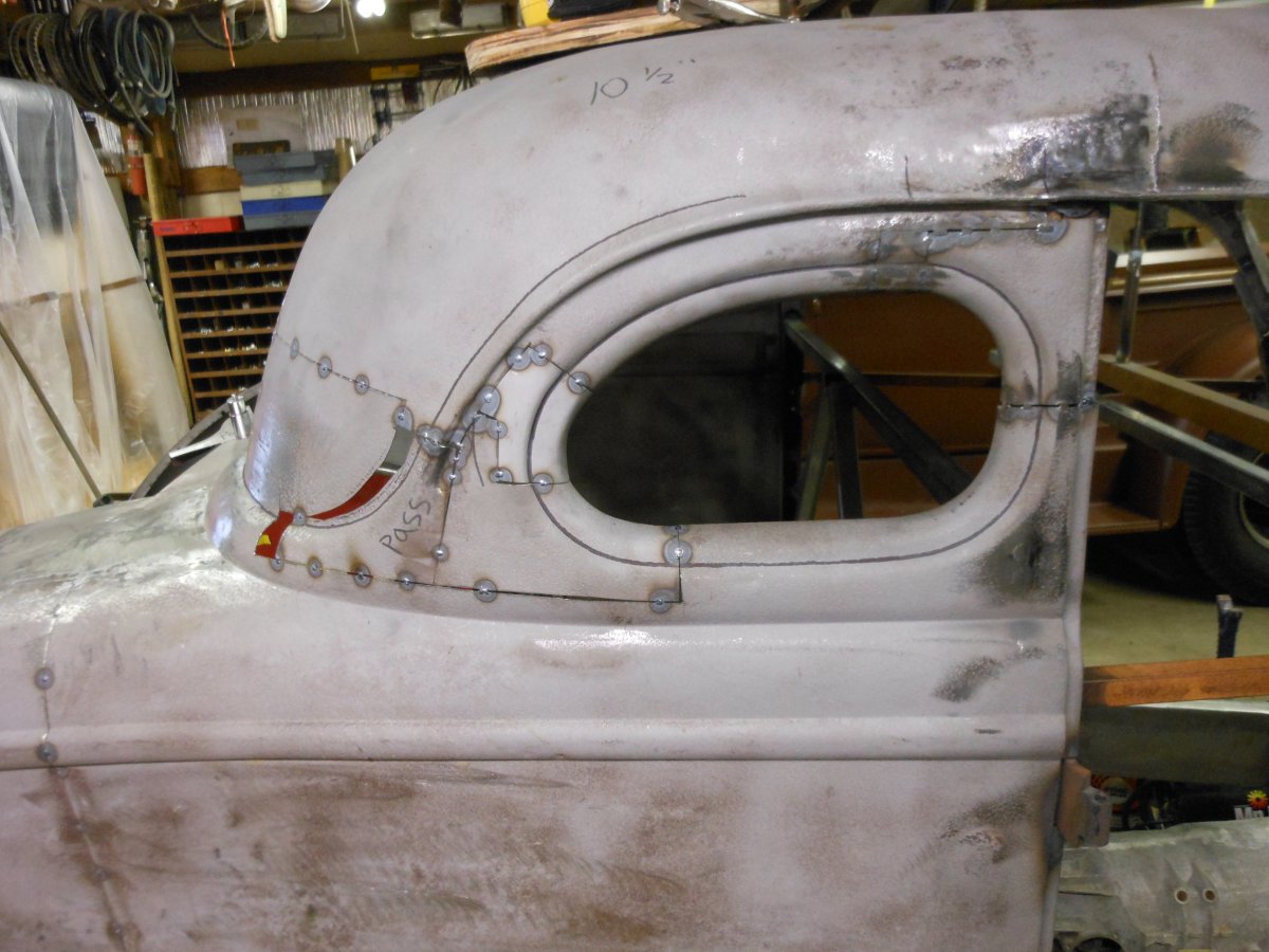

    The quarter windows on chopped 5w's is sometimes questionable. The kink factor on the body lines always seems to happen when they get chopped. Some are worse than others. @Lytles Garage made this little multi step jig to remedy that. He tried a few pieces, but after quite a bit of cussing it was handed off to me. It took me a lot of **** ups to get a couple that would work out.
    These and the rear window still need some m***aging once the whole chop is welded up but the end product should look proper.
    A little tip I use that might help someone out down the road: I use a sharpie to mark the bodylines, this helps me immensely on getting the lines to flow. You can see the use of it around the quarter windows.

    Window came out great.
