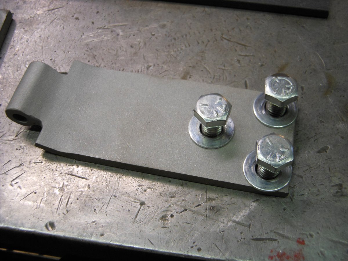

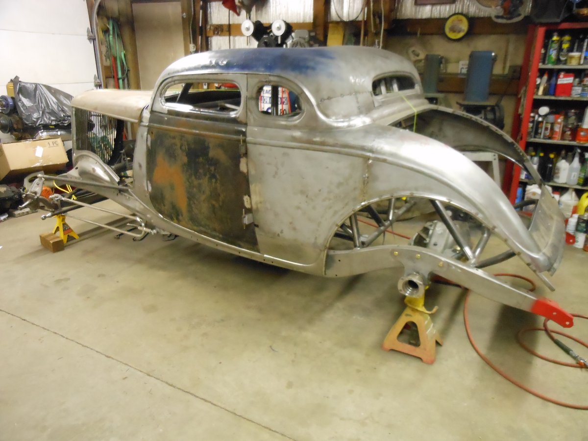

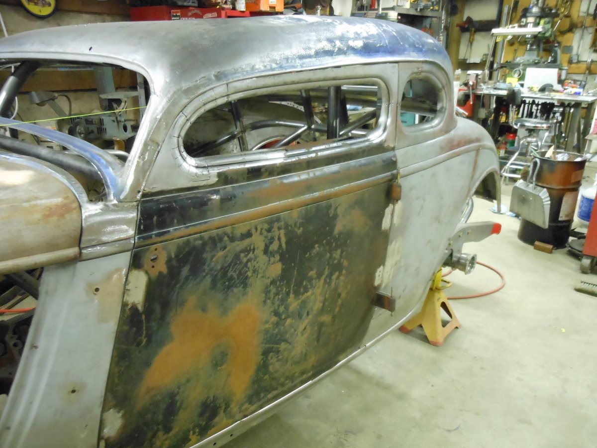

    My weekend plan was to get the passenger side door on, chopped and matched to the drivers side. I spent most of Saturday rebuilding the b pillar, getting them ready for the hinges.
    I started sorting out hinges and figured out I was missing a lower body side 4dr hinge. So I spent a couple hours searching in every nook and cranny thinking I misplaced it.
    I finally gave up the search and just decided to pull the one off the drivers side and make a jig to make one. I machined out a piece of solid round stock and cut a piece of 1/4" plate and had the hinge. Bolted it on the body and put the door pins in and the door closed right on the money.

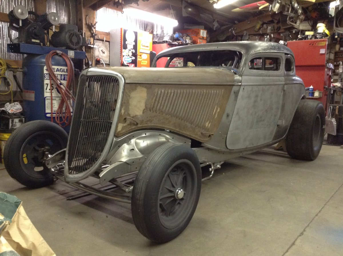

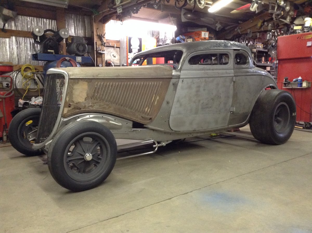

    I'm going to drag this thread back from the dead. After a long "storage" period, dad and I are back on the coupe! Here's to hoping we can stay on it pretty regular and finally get this thing making some noise.

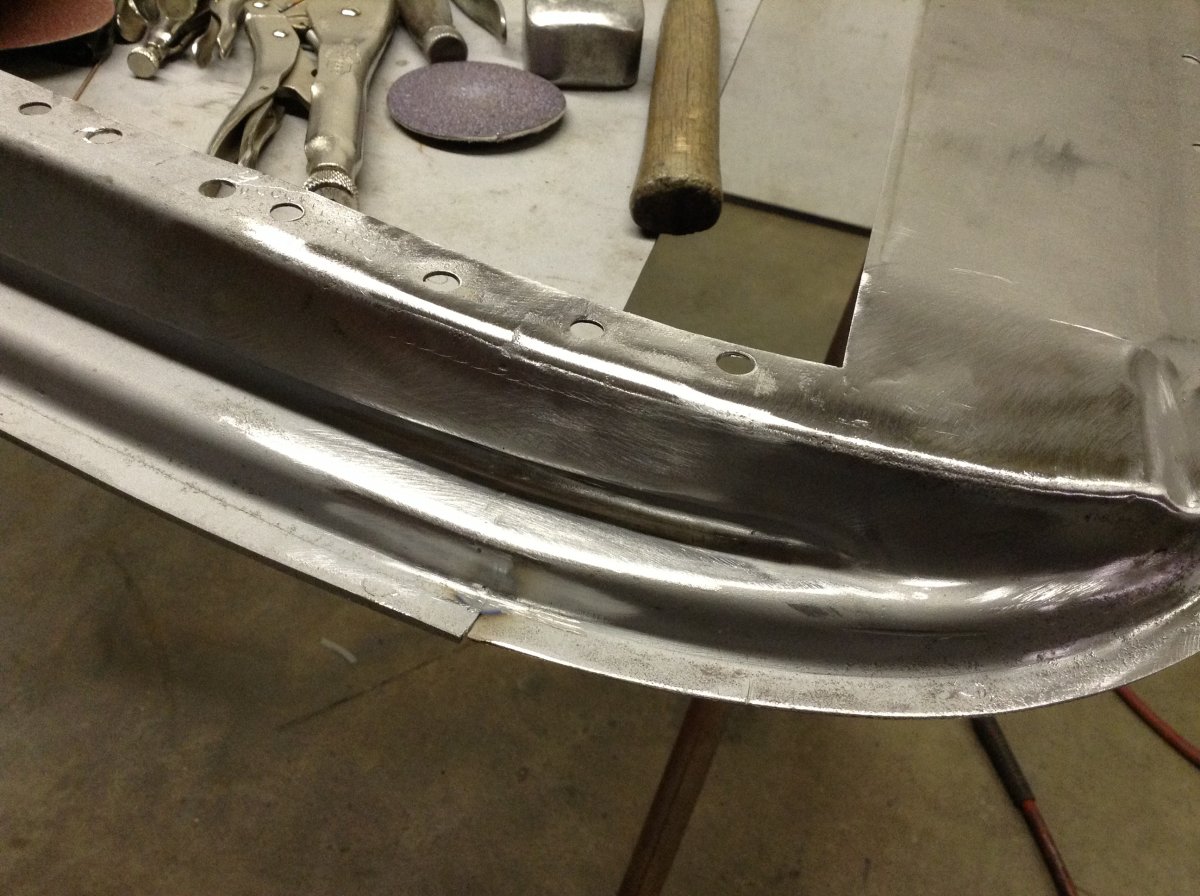

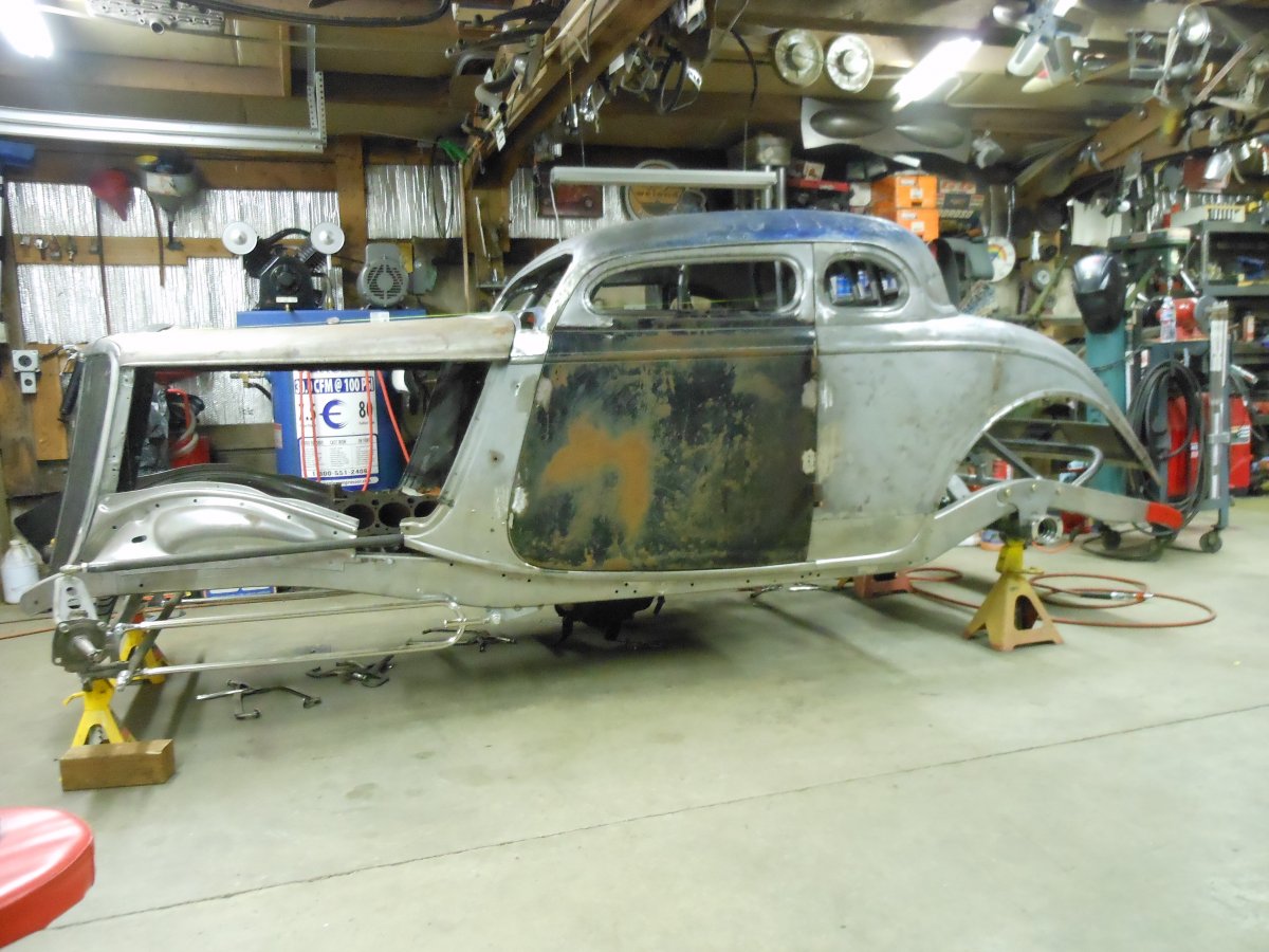

    Fixing, straightening and making the passenger door fit in its hole.
    Repairing the lower inner panel and tying both jams together again, getting rid of the ol' jiggly wiggly mess it has been.

    The door bottoms swooped out quite a bit, which I have seen on some 33-34's. It's not really a big deal, but I wanted to try and improve it.
    I pie cut the jamb and tweaked it as far a I could before it would peak the outer skin. Looks way better now.
