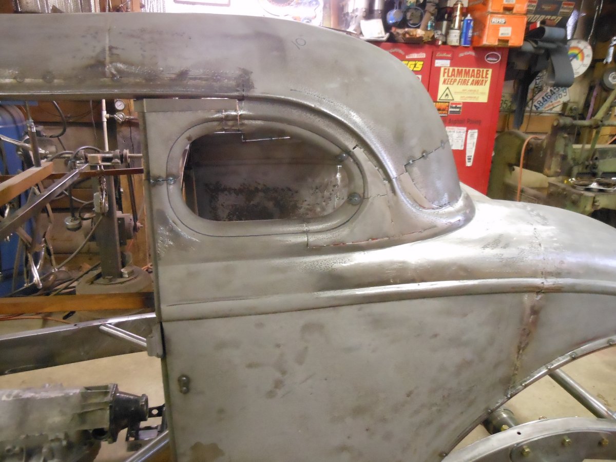

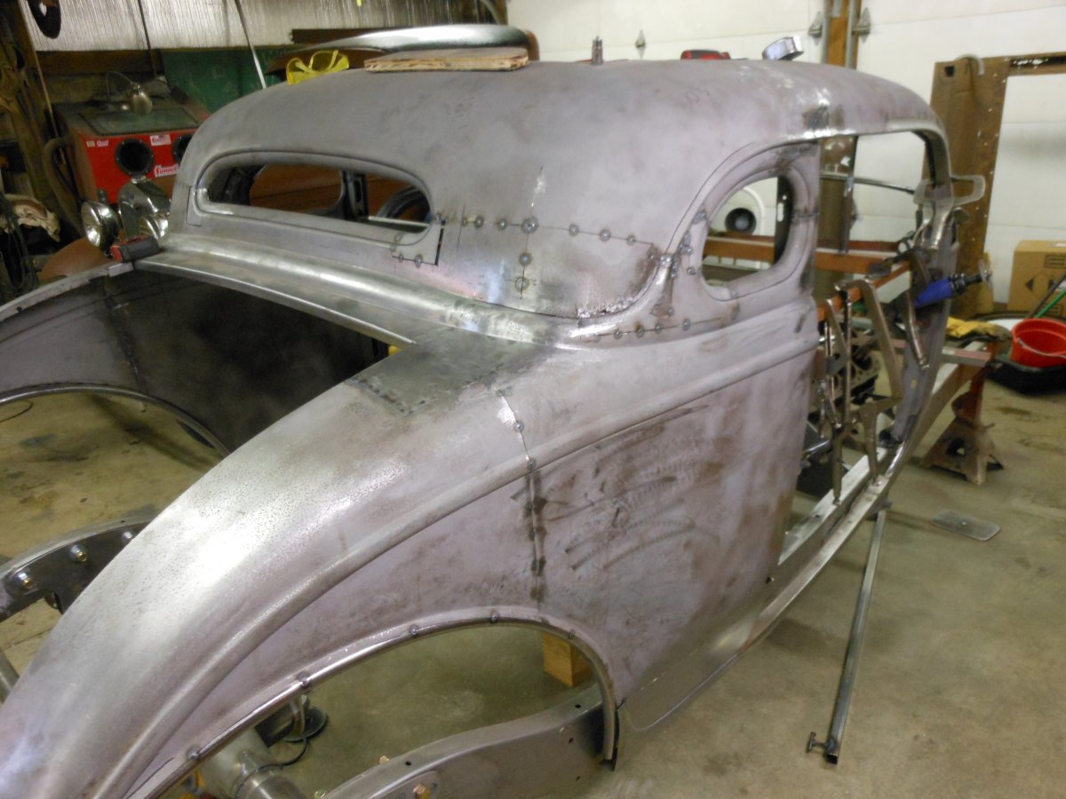

    Rechopped the door top for the 10th or 20th time. Finally settled on a profile that is cohesive with the driprail.

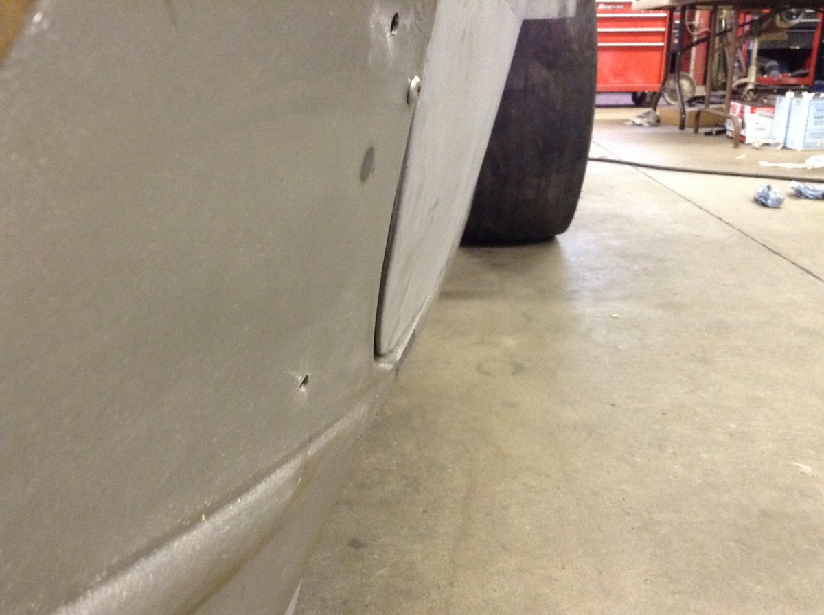

    Also got the bear jaw or claw??? latch working on the drivers side. Sure shuts easy compared to the originals I've closed in the past. First time a door has latched shut on this body in a very very long time.

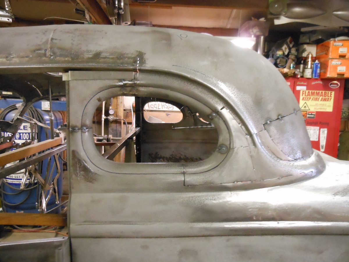

    Working on getting the inner door structure chopped and fit to the skin. These doors are pretty light!

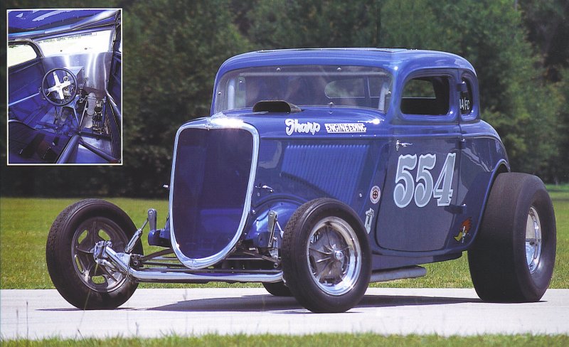

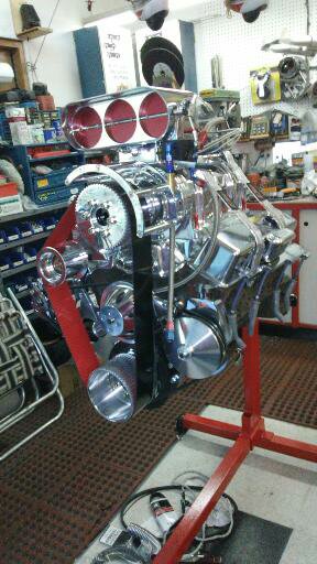

    New transmission setup for the coupe! We set the car up with a turbo 400 that was going to be a full manual reverse valve body deal. Now it just got a whole lot cooler.
    Clutch Turbo 400!!!
    What's even better is the entire setup used to be in my dads (lytles garage on here) Blown Hell 33 willys AA/GS car. We got the original fairbanks trans thats rebuilt , Mcleod dual disk clutch and ****tershield that's out of the willys. Plus a brand spankin' new updated clutch turbo trans. Now we're going to have to cram a clutch pedal in it somewhere. I can't wait to dump the clutch in this sum *****!

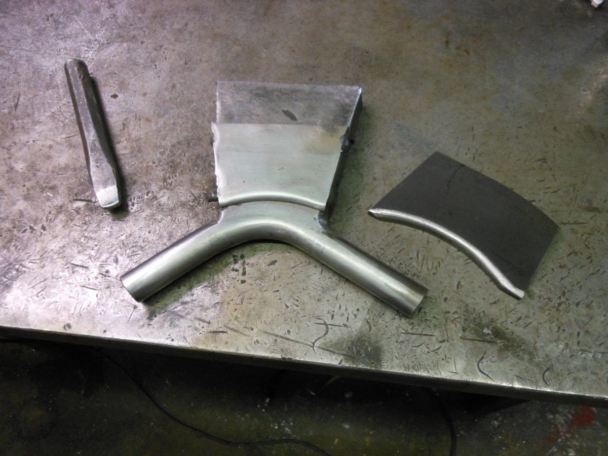

    Not much progress to report. In a stroke of wisdom, I threw away about 11" of the inner door top structure last year. So I spent some time remaking those pieces. The inner channel had too small of depth to bend it up on the brake, so I had to do that by hand.
    Here is the inner channel portion mocked up in the door. Lot of work for something no person will ever look at.
    Here is the outer-inner portion I made with the top hinge delete mocked up. It will get its final trim once its all welded up.

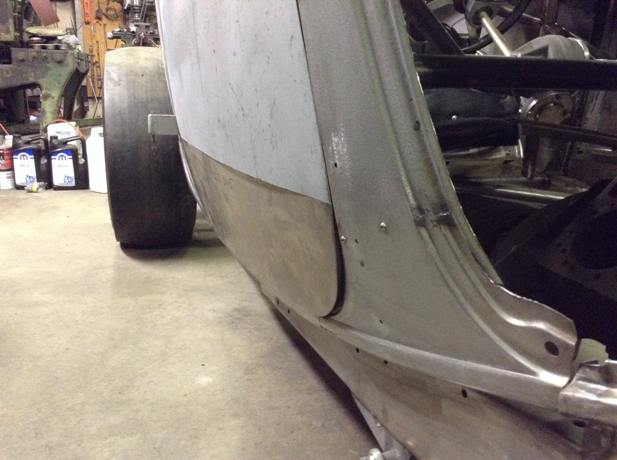

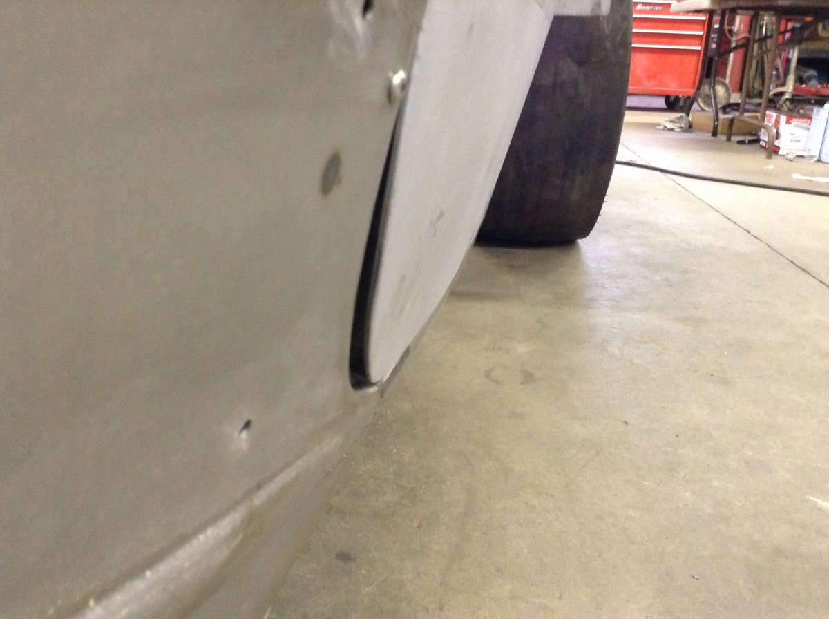

    "IS THAT SUM ***** CHOPPED?"

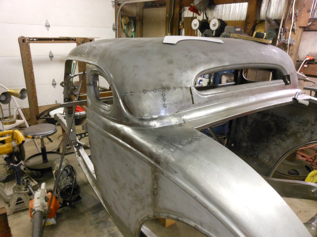

    Getting the profile dialed in
    Starting to look real good.
    Make sure both doors look the same!
