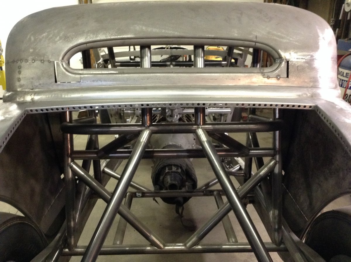

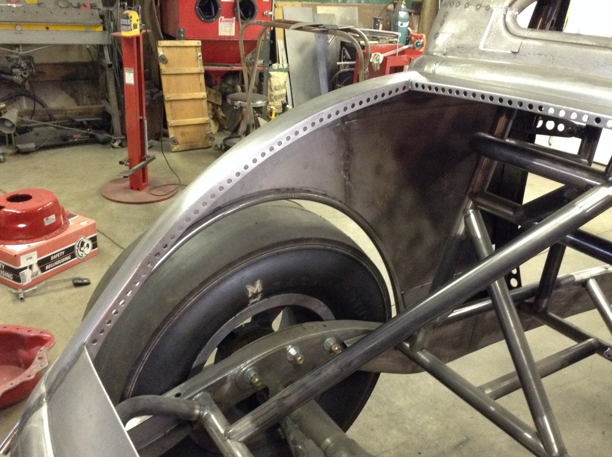

    Finishing up some more of the ugly bits still left. Saved a few ounces of weight and made 'er real strong. Trunk jams are done.

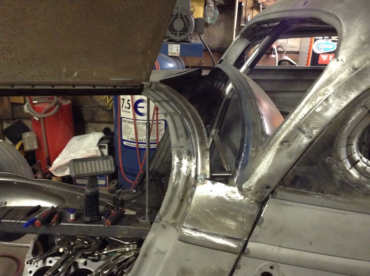

    This car proved that theory right. The body is technically a 33, but somewhere down the line it got a 34 drivers cowl side scabbed onto it. It goes halfway up the a pillar and about a 1/3 way across the cowl top and all the way down the side. The cowl top section consisted of 3 overlapped pieces welded and leaded that didn't match the back of the hood at all. On top of all that the drivers side was a 1/4" higher than the p***enger side.
    So I cut the whole drivers cowl off the car.
    I spent a while trying to cut apart and fix the original piece. It ended up in the trash can. So I just made a new piece that follows the backside of the hood and cowl.

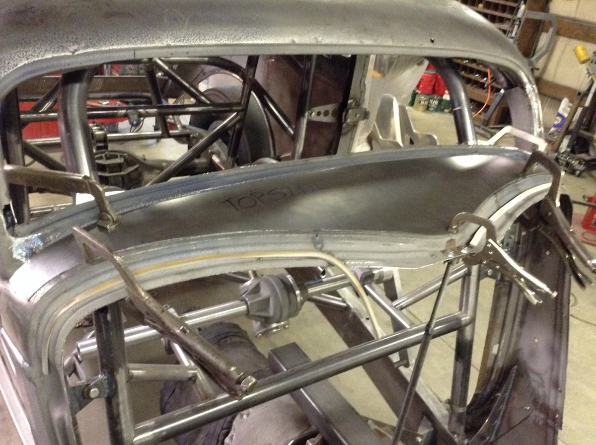

    Once that mess was sorted out, we can get back to the regularly scheduled program. We got the cowl top its final cut and fit and tacked.

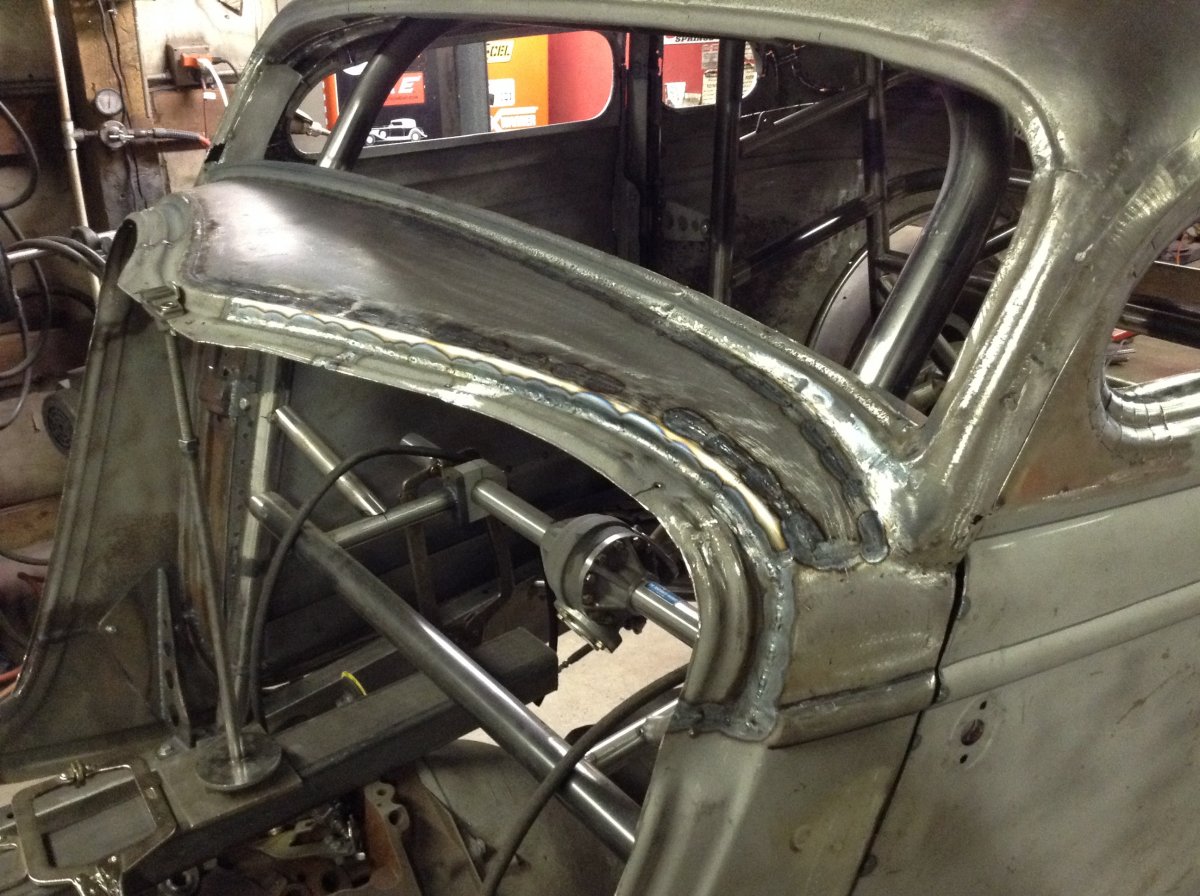

    I spent pretty much the whole day hammer welding the panel in. Most of it went pretty straight forward except in some really thin areas the car fought back. You can see how pitted the body is.

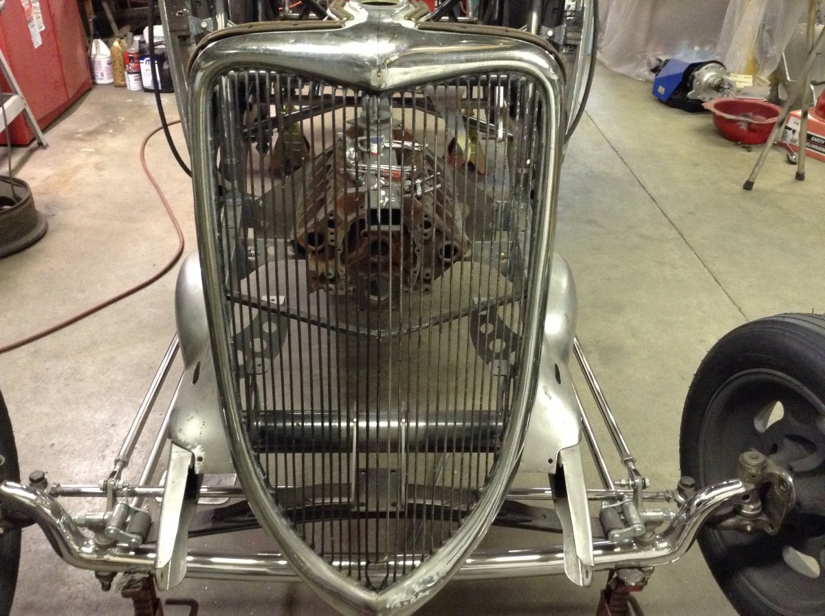

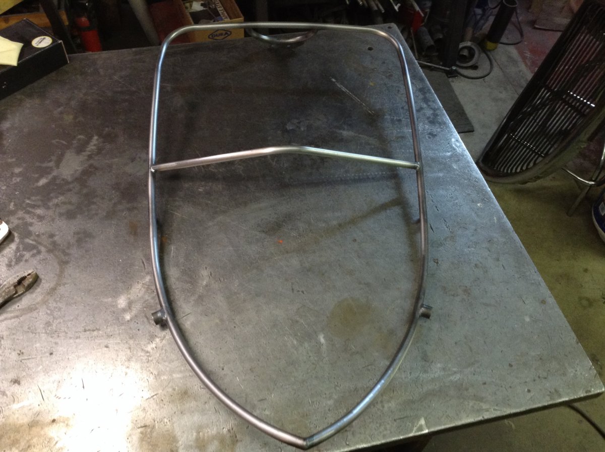

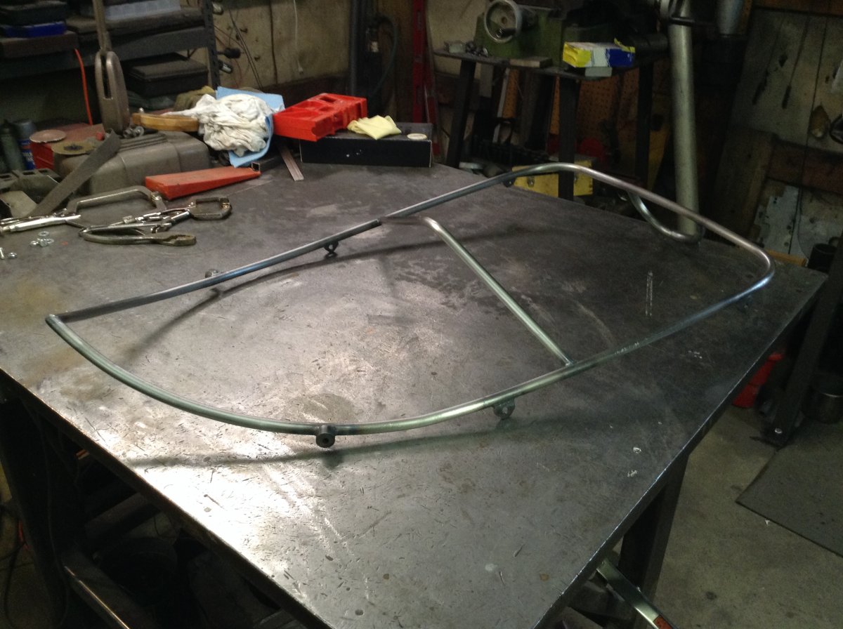

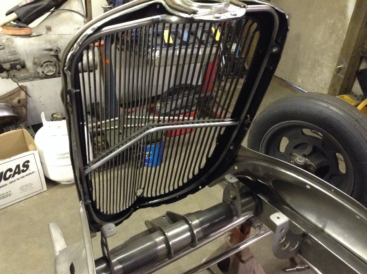

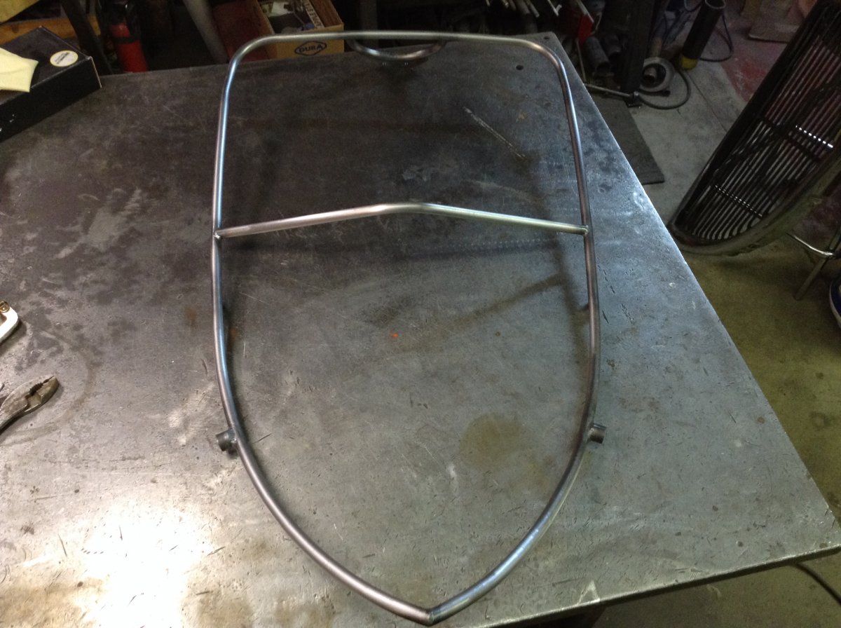

    The grille has been a big floppy *******, since it has nothing other than the splash aprons to hold it up. That also means the hood shifts every which way but in line. Remedy for that is a grille cage/battering ram.
    Made from some 1/2" od tubing, it snaps into place and out of sight on the car. Jury is still out if more bracing will be required.
    If this thing gets stuffed into a wall, hopefully this will keep the grille somewhat repairable.

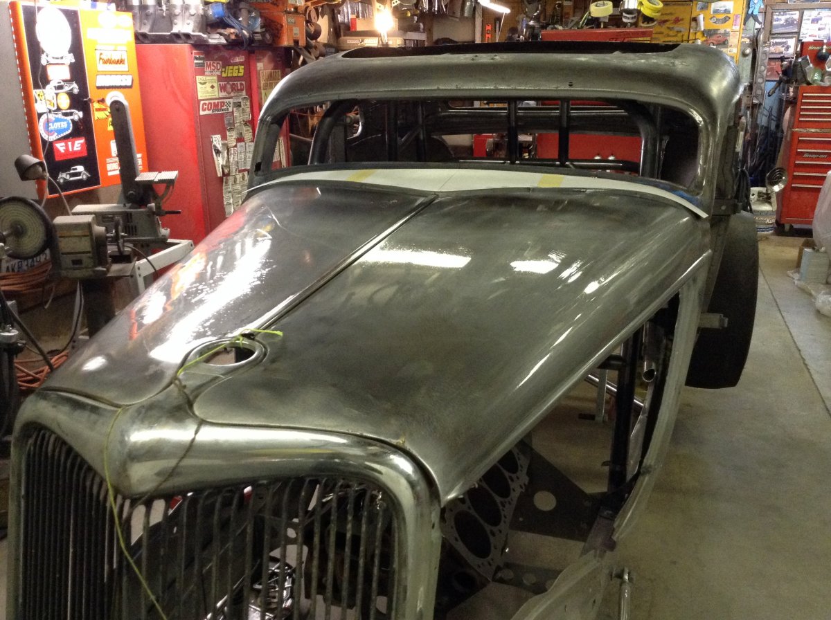

    Started to work on the hood sides. Like the hood top these got mudded up. Spent literally 5 minutes with a hammer and dolly and had them flattened back out.
    I like stripping paint and body filler with a razor blade. I saw it on that Mobsteel tv show from a few years ago. It works pretty dang good, and keeps all that stuff from going airborne and making a huge mess everywhere.
    Once the sides were stripped and sanded, it was time to throw them on the car. That resulted in the grille being 5/8" too tall and the front of the hood sides from even coming close to fitting. So after pulling the front end and splash aprons back off the car and adding material here and cutting **** off there, the hood "fits".
    Its starting to look like a proper 34 now. On to the next **** show.
