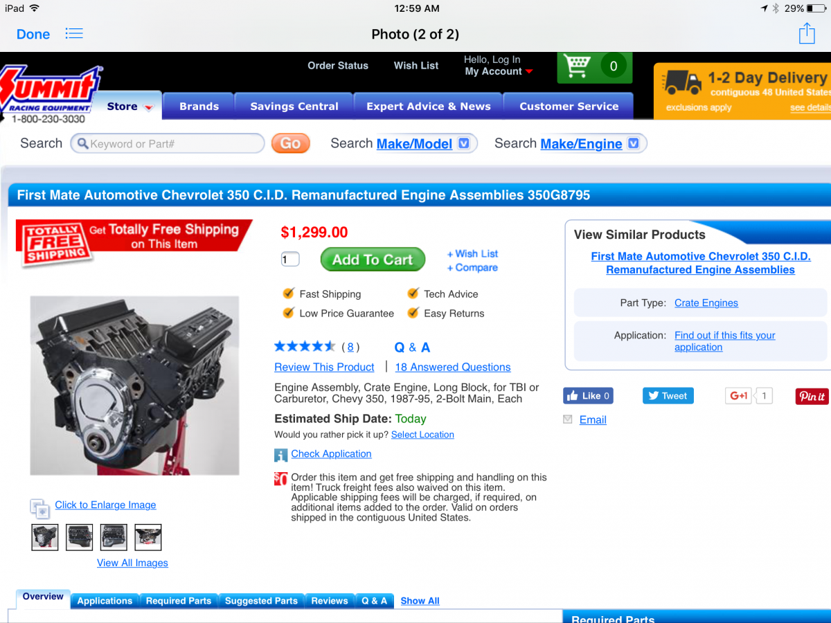

    Like other's have said ,pay bill & GO!!!
    Or leave part's , You can get a Crate motor ( long block valve cover's to pan ) with out core for $1,500 free shipping , 290 hp warrenty just few week ago.
    Buy yr part's smart & have less then $2,000 in ;)
