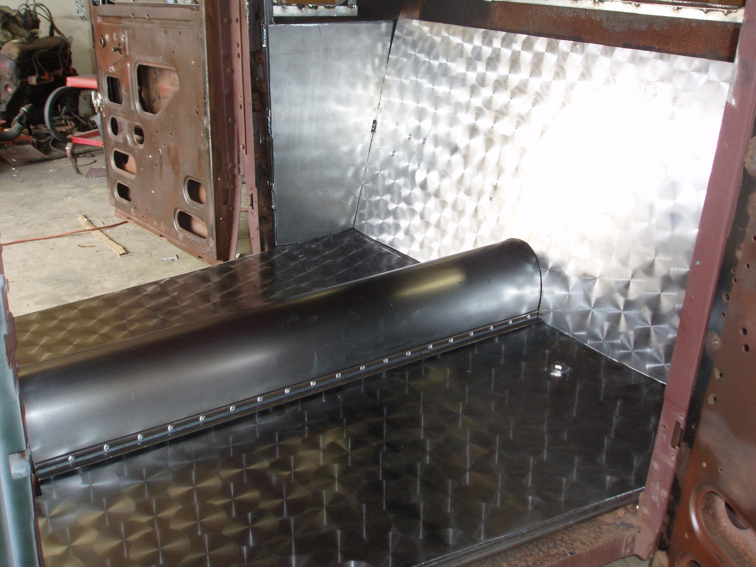

    First attempt at machine turning. Used a 2 inch rolock on 1 inch grid.

    hrm2k
    nice stuff !!! I had been thinking about trying this on a couple of new parts for my T

    VERY NICE! What did you use for a guide/fixture? Back in the 1970's when I was at a restoration shop we had a special guide to do the Bugatti dash and firewalls. I always enjoyed doing it, but you never knew how it would look untill you washed off all the valve grinding coumpound.

    i did most of my interior like this. Much easier with a drill press, just took a roloc wheel and cut down a scuff pad. i just hope it isnt too shiny when the sun hits it.
